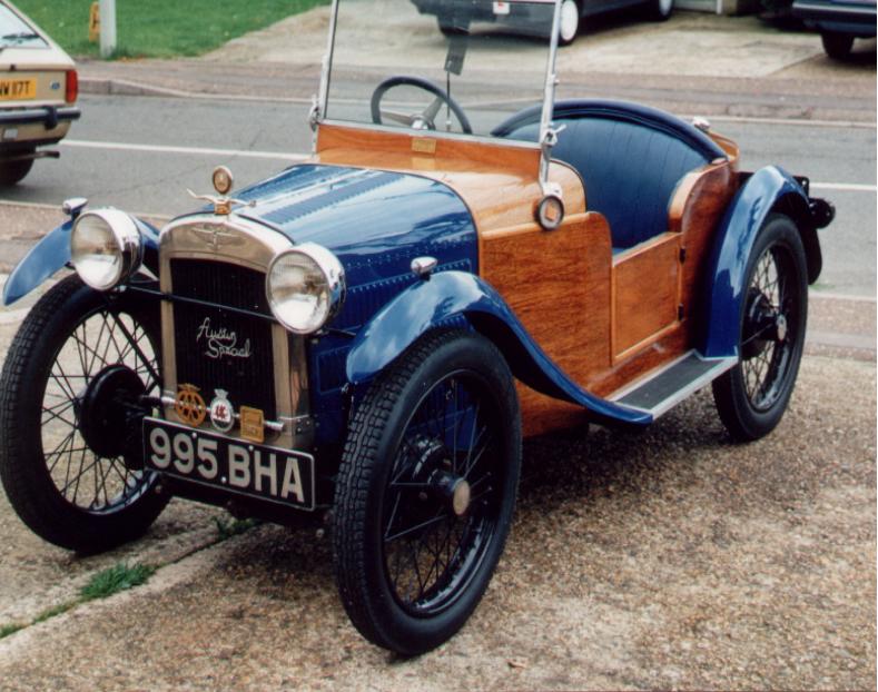

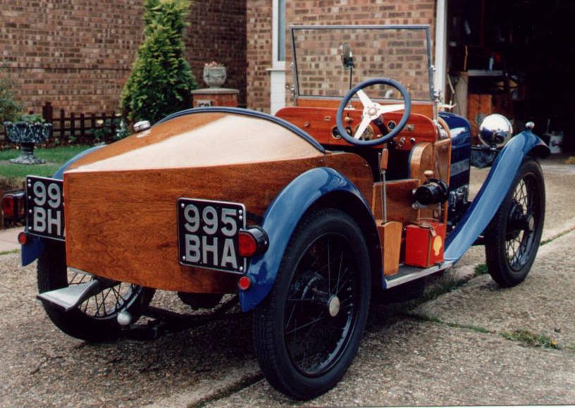

Hi all.
I took some time off from casting to re-think the situation. I am giving up trying to make an engine and falling back on my old hobby of vintage cars.
I am now in the process of re-arranging my garage/workshop to lose a bit of workbench and move an Austin Seven out that needs a lot of work, and an Austin Seven in that only needs a bit to make it driveable.
I think I was close to getting a good casting with all the advice you had given me, but ahead was a great deal more learning when it came to maching the casting etc. And also the expense was becoming a serious consideration. I would need to build a bigger foundry, buy a lathe and milling machine plus all the tooling, and dispose of at least one Austin Seven to make room for all that.
Thanks for your help.
Lee.
PS. If you are ever in my part of Cornwall ( Illogan) drop in for a cuppa!  :ThumbsUp:
PPS. My new pastime is to make 4 scale models of my Austin Seven in 1/10th scale (it's so easy to divide by 10). Display case only! One for me and one for each of my sisters. After that, who knows.
