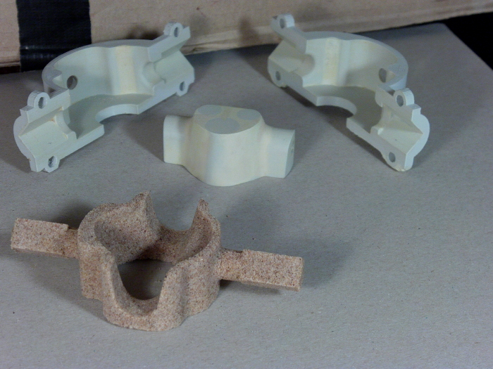

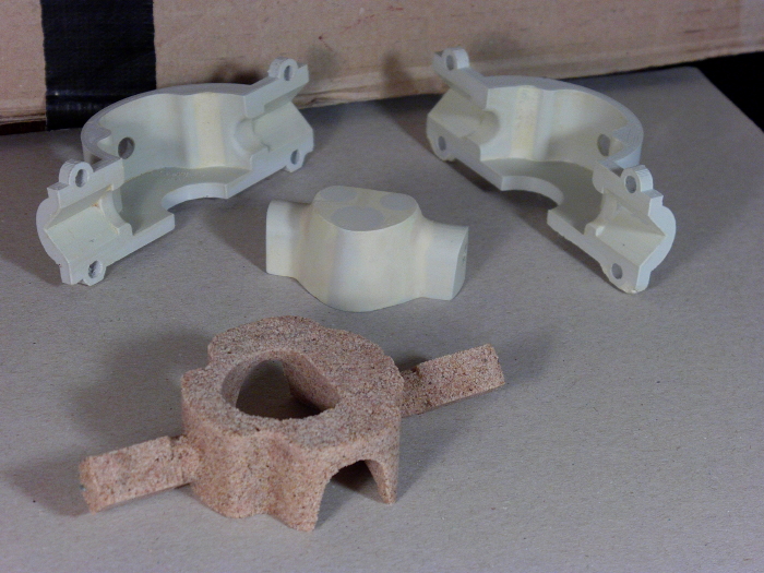

This is the water core and its mould. Some thin metal wire has been used to strengthen a few places. I used fine sand and sodium silicate hardened with CO2.

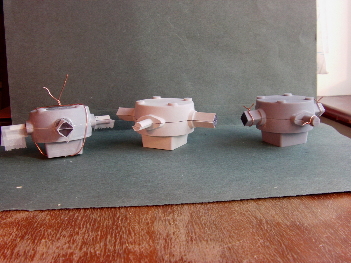

The three head patterns. The middle one is the pla pattern. It looks wonky because I didn't fit the locating pins to hold the two halves together. The other two patterns are resin. The copper wire is there to try and correct some of the distortion that occurred some hours after printing. I left the prints in a sunny spot for a few hours and that helped a lot, so I think a hot air gun on low setting would work.

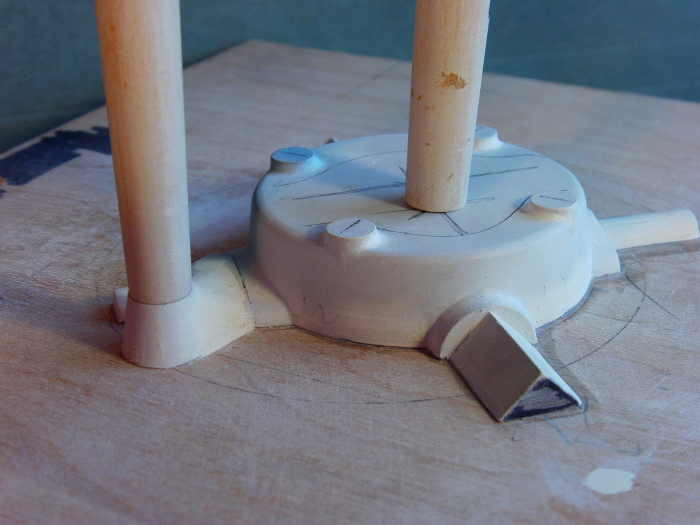

I have bonded the pla head pattern to a match plate and worked out where I think the sprue and feeder should go.
Hopefully any loose sand will end up in the bottom of the head where I have allowed 2mm extra metal to be machined off.
I also have all the cores made. I have made two water cores, one in sand + sodium silicate, the other with sand + epoxy resin. The inlet and exhaust tracts, right of picture, are mainly sand + sodium silicate, plus I have made one with a stronger mixture of ss+sand, 15% ss instead of 5%. I also left it "cooking" in the plastic box filled with CO2 gas for 30 mins. I made an extra combustion chamber mould the same way. It's the one in front with 15 written on it. I want to see if it works better than the weaker mixture, it certainly feels better and has a good texture. The two parts still in their moulds are the water core at the back and an inlet/exhaust tract at the front, both made with sand/epoxy. So a few spares in case I break anything. I feel a pour coming on!
I also have the other two head patterns ready to fit to match plates if the pla pattern doesn't give an acceptable finish. Mind you, the head will be painted, so perhaps I am expecting too much from my setup?

When I printed out both halves of the head pattern on the Ender3 in pla and then put them back together with dowels, the two halves generally line up, but not the four "arms" that form the location of the water core and inlet/exhaust cores. They were slightly out of line with each other. The two halves of the pattern were formed by the splitting of the 3D drawing, so they should have lined up. Apart from that some of the flat surfaces on my prints have been a bit concave or convex. They have needed sanding or filling. The print has often lifted from the bed, I have the bed temp at 60c, anything lower and the print won't stick. Sometimes a corner of a print will lift. Holes never print at the right size, I even printed out a hole gauge with a series of holes in it from 5.9mm to 6.5mm in .1mm increments so I could determine which size I should use in my designs. Even now if I want a hole at 6mm dia I have to draw the hole at 6.3mm dia. But I expect something like that with a printer that is squirting out liquid plastic layer by layer. I have seen others get better prints from different manufacturers. It's only the price of a Prusa that stops me buying one.
Lee
  • Posts: 800
Re: Making the cylinder head, design, patterns and casting.
« Reply #44 on: October 12, 2022, 05:40:14 PM »
Yup, even on nicer printers, shrinkage and warping occur when the PLA cools down.  I made my PLA-printed mold twice, because I tried to bake the paint finish on it at 150-200 F...and that made the thing warp and twist like crazy.  There is a lot of built-in shrinkage stress in 3d printed parts.
