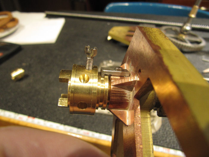

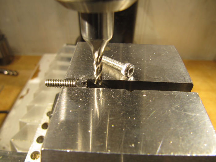

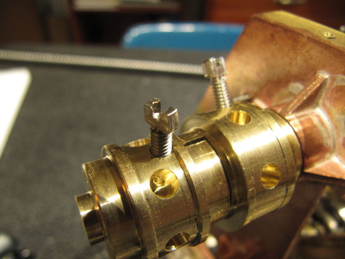

I was out all this morning doing other things, but did get a little time in the shop this afternoon taking care of some more fiddly bits. The steering wheel hubs need locking screws, which in the pictures from Michael I see some with wing-nut style ends. Easy enough to make something that shape from some 5-40 socket head screws - clamped them sideways in the mill vise, and flattened off the sides:
making these winged ends:
I may go back and file the centers a little for more shape.
The other small piece needed on the hubs was a small retaining bracket for the large wheel hub, to keep it against the wall when the locking nut is loose and the clutch is not engaged (which is always when running the steering using the engine). Milled that from a bit of small square bar stock and screwed it to the flange on the rear wall:
The lip on the end of the bracket rides in the groove on the hub, holding it from sliding out. Now, I guess I got the first hint that Christmas is coming - I needed a very short 2-56 screw to hold that bracket, and was about to cut the end off a 1/4" long one (shortest I stock), when I found an already trimmed one laying on the floor next to the trash can. Perfect length, just needed to file a bur off the cut end. All I can figure is that the shop gnomes are trying to bribe me into getting them a new box of shiney parts for Christmas to add to their hoard. Either that, or their pet goat got scared off when I came into the shop and left the other half of his lunch laying there...   :Lol:

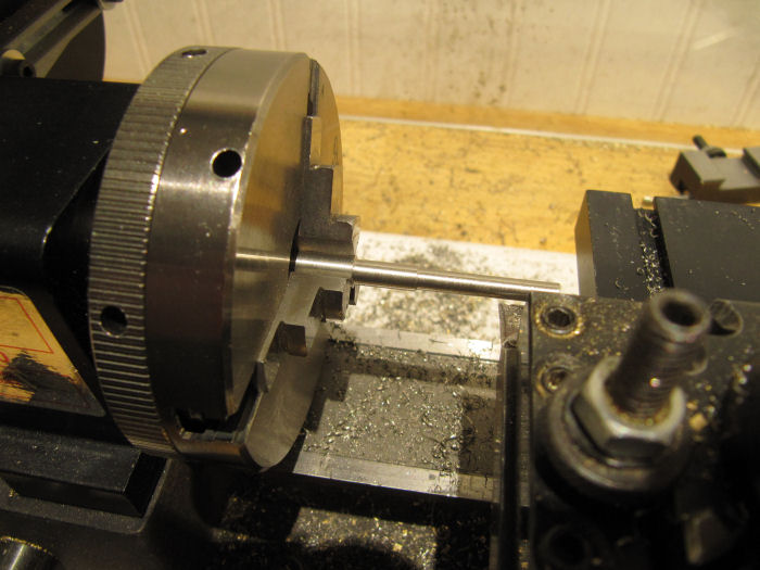

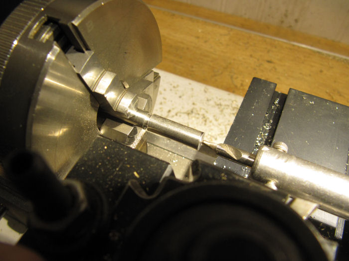

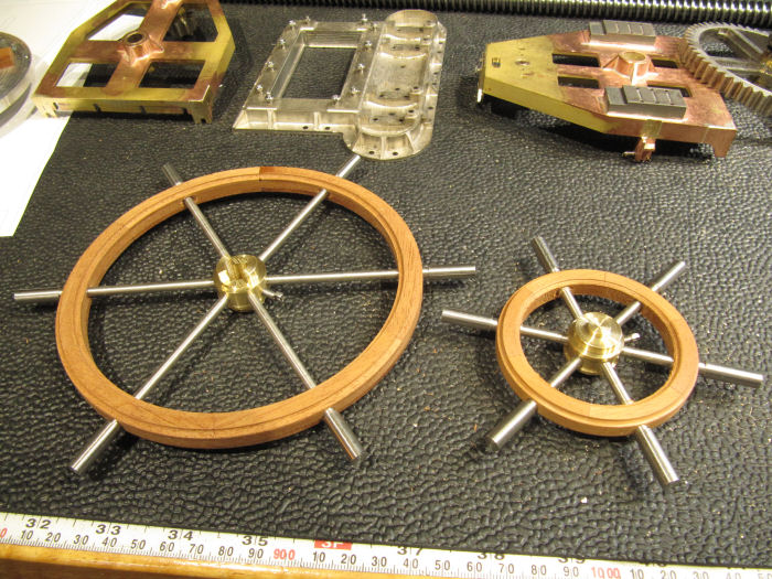

Began shaping the spokes for the two wheels today. First cut 6 long and 6 short pieces of 303 rod, and squared up one end in the lathe on each. Then, using the tailstock with a center drill as a stop reference, measured back on the first one the height of the handle end of the spokes, and used a parting tool to cut in the diameter to fit the holes in the wood rims.
Once that first one was done, I swapped out the other 11 one at a time and made the same cut, same position and depth. That went quickly since the tailstock lined up each piece in the same place in the chuck.
Then turned each piece around, and turned the shafts down to size. Where they go through the rim is a larger diameter than the rest of the length. Since they are thin, each was done in short segments down the length of the rods. Kinda hard to see the steps to the diameter in this photo, but they are there - scaling down for the size of the photos for the forum loses some of the details.
This shot shows it better
Here are the parts so far test fit on the hubs. The ends of the spokes are a close fit into the holes in the hubs so they stay together nicely. At final assembly a little loctite should glue them in well.
Next time I'll start shaping the handle ends of the spokes...

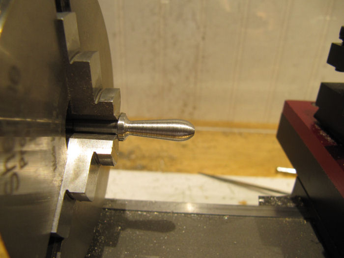

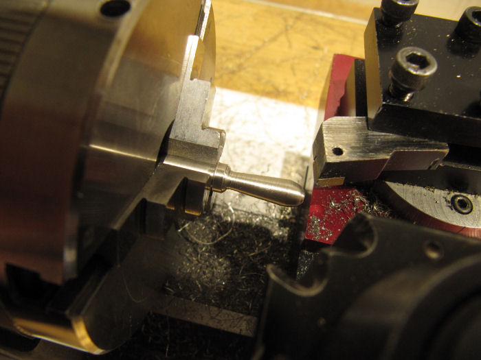

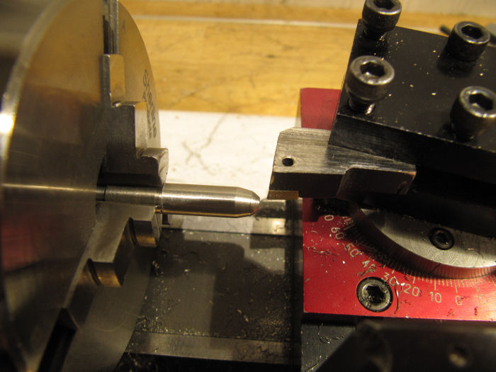

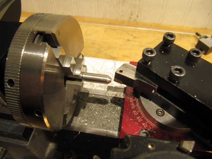

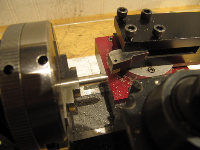

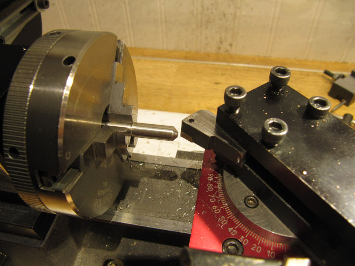

Set up the compound slide, and shaped the handles on the spokes this morning. I used a variation on the old trick for shaping bearing caps, several flat cuts 10 or 15 degrees apart to simulate a true curve, then used a file to blend them together. Since the handles all have a step cut into them where the shank starts, that step was perfect for aligning the parts in the chuck - put the step against the jaws each time, and the parts are in a repeatable position so I could make the same cut on all 12 then change the angle.
Started out with a steep cut at the end.
changed the angle a bit for second one to start to turn the corner
a third to finish the corner
and one more to get close to the parallel cut down the length
The last cut was angled back in to narrow the base of the handle. Finished this cut at the base while leaving a bit of room for the reverse curve
That was it for the cuts, then just a final few swipes with a file to smooth the curves fair

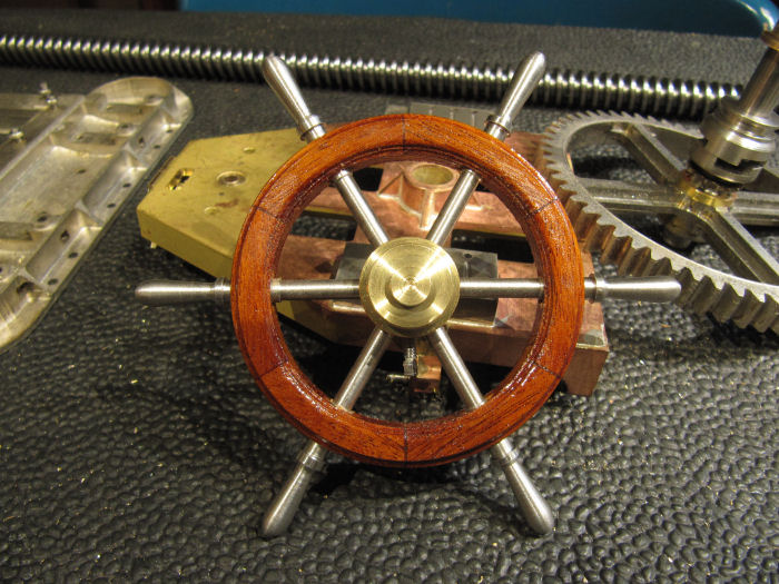

All those steps were done on all 12 parts before moving on to the next cut, so at this point they are all done and ready for a test fit. Oh, and the rims were varnished yesterday, really brought up the color nicely.
a closer view of the small wheel. I am going to chuck them up one more time and trim a little of the hub ends to get them seated a little deeper to get the handles in the proper location, then a drop of loctite in the holes for final assembly.
