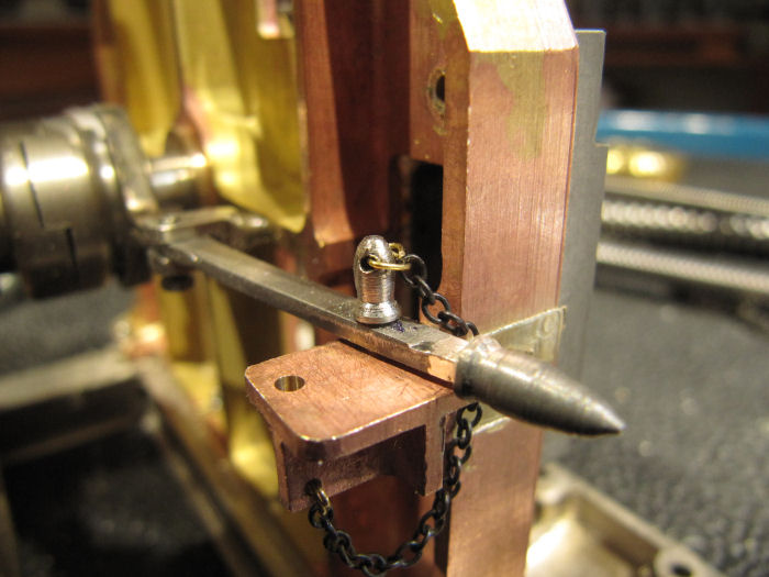

Got a hole drilled in the end of the pin - very tiny hole so I used a micro dental bur in the high speed air handpiece to nibble the hole through the end. Then a short piece of chain was wired on so the pin doesn't get lost. The pin end is .070" diameter.

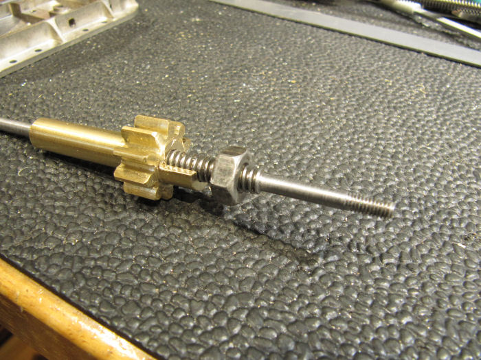

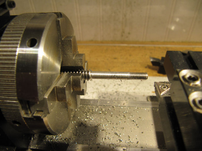

After deciding on the thread sizes to use, it was time to make the upper shaft. I originally was going to use a 3/8" acme thread, but that wound up just too large for the control nut and the gear shaft, so I went back to a 1/4" Acme threaded rod instead, which will fit inside the half-lap on the control nut better. Either way, I would likely have to adjust the lenghts of the arms on the crank leading to the valve to get the proper travel.
So, here is one end of the upper shaft. I made the whole thing in one piece from a length of the 1/4" Acme rod. This is the end towards the cylinders. It has the Acme thread in the center to move the control nut, and a M4 thread at the very end for the stop nut on that sits in front of the front wall. I still need to add another threaded section at the front end of the Acme thread, for the rudder position indicator. That will be made on a seperate piece, drilled to match the shaft, and added on to the shaft. That will make it possible to slide it all into the bearing for the front wall.
The other end was turned down to a straight smooth section, just under the root diameter of the Acme thread. That end goes through the small spur gear, and holds the smaller of the steering wheels at the other end. I milled off one side of the spur gear hub at the front end to form the half lap to engage the control nut. Lots of moving parts in this area, this is where a lot of the magic of this engine happens!
Oh, and almost forgot to add a picture of the Acme nut that will become the core of the control nut. The outside will be turned down to take a cylinder with another half lap in it, more on that next time.

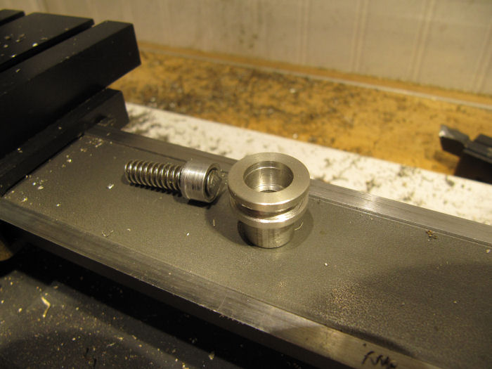

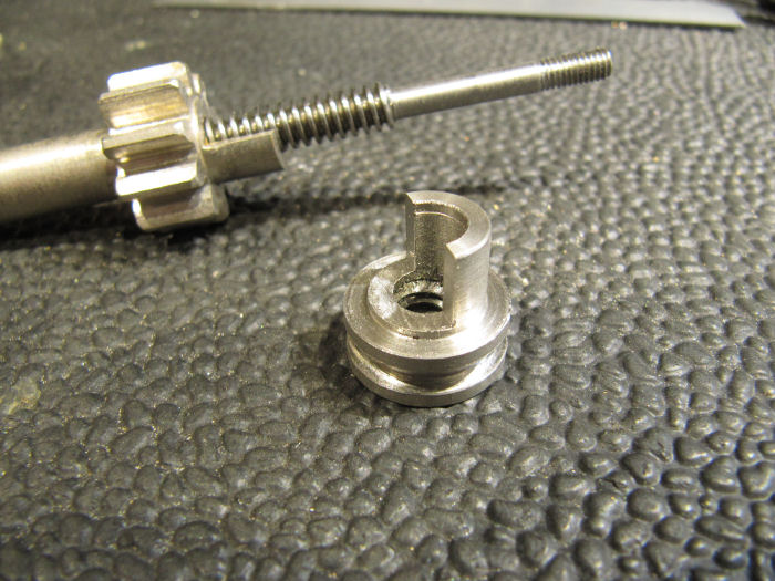

The small spur gear was nickel plated, and the Acme nut was turned down round. Then turned the control nut, with the end at the groove counterbored out larger to fit the turned down nut:
A little Loctite retaining compound later, and the control nut shell has its internal Acme thread. The other end was milled off to form a matching half-lap to the one on the gear hub:
And here it is test fit on the engine:
So, now if the inner shaft is turned the control nut is kept from spinning by the gear half, and it moves one direction. If the gear turns the other way but the inner shaft stays still, the control nut is turned by the half lap on the gear, and the nut comes back to where it was. That is the key thing about how the mechanism works. The inner shaft is turned by the steering wheel, moving the nut, which opens the valve one way or the other. That makes the engine run to turn the gear the other way, bringing the nut back to center which shuts the valve, stopping the engine. Along the way, the turning of the engine spins the lower shaft with the chain sprocket, which moves the rudder chains, turning the ship.  Brilliantly elegant design! Someone with a great mechanical mind thought it up originally.

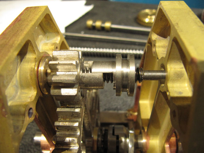

Hello Chris,
very good way.
I took a few more pictures with details. The carrier has 2 cams, but of course it also works the way you do it. It's easier that way too.
In your drawing, the bracket for the linkage is drawn like the lever for the hand lever. In the original, a bronze ring that is divided and screwed slides in the groove.
« Reply #299 on: October 21, 2022, 07:06:26 PM »
Great detail pictures Michael!
I never noticed that there were two lobes, a bit late for the model but I can update the CAD version and the plans. I really like the follower ring for the valve and will build it that way.  Hmm, since the crank arm swings, there must be some play in the ring up and down? The front and back sides of the ring are close fit, but the center of the ring must be elongated in the center?
