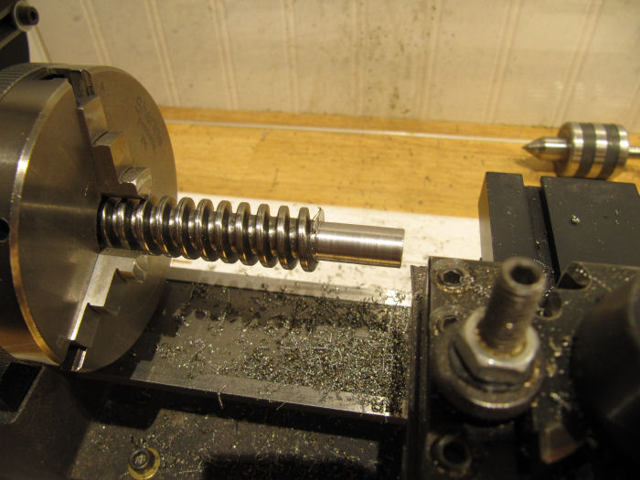

For this model, I need a worm gear slightly over 5/8" with ideally a 4 TPI pitch. I was able to find a 5/8"x5 tpi threaded rod, which is close enough. An Acme thread is not quite the same as normally used on a worm gear, but it is pretty close and will work fine for lower speed applications like this one. A piece of the threaded rod is modified to make the cutter, the Hob, used to make the matching spur gear. If you have a lathe capable of cutting this type and size of thread (mine wont), you can make the threaded rod rather than buying it.
So, first step was to cut a length off the longer threaded rod that I had bought, and turn down one end round to aid in chucking it. When I did the first tests, the threads didn't grip that well and tended to slip while cutting the spur gear.

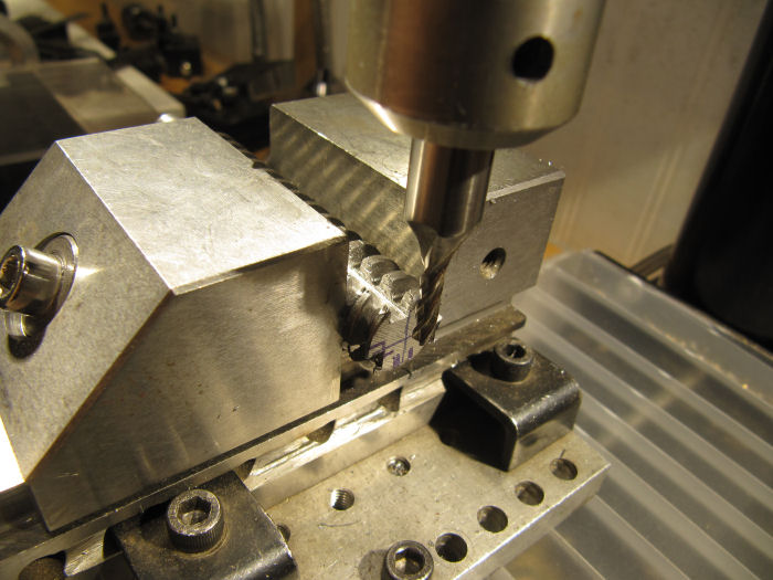

Then over to the mill to cut four flutes into the rod with a 1/8" diameter end mill. The cuts were done in several passes, working my way down to just below the bottom of the thread. The cutter was lined up so that the cut edge was on the centerline of the rod, making sure to get the direction of rotation of the mill taken into account, leaving the centerline edge as the cutting edge.

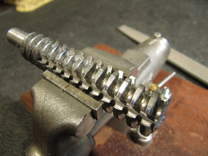

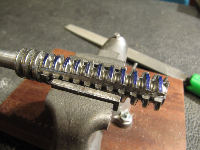

Put the rod into a small smooth-jawed vise (actually the little Martin Models mini vise built from their castings a couple years ago) to file some relief on the tops of the teeth behind the cutting edge. The top surfaces of the teeth were marked with a felt tip pen so I could tell where I had filed off some metal.
Taking care not to file into the cutting edge of the teeth, filed back the rest of the teeth to give the leading edge some room to cut. This was done on all four sections around the rod.

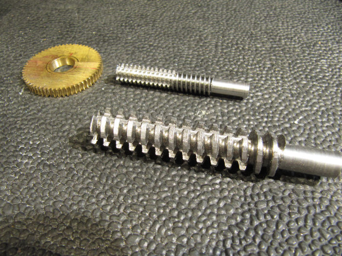

Here is the hob, ready to use. It is sitting next to the smaller one I made as a test a while back, along with the test gear made with it.

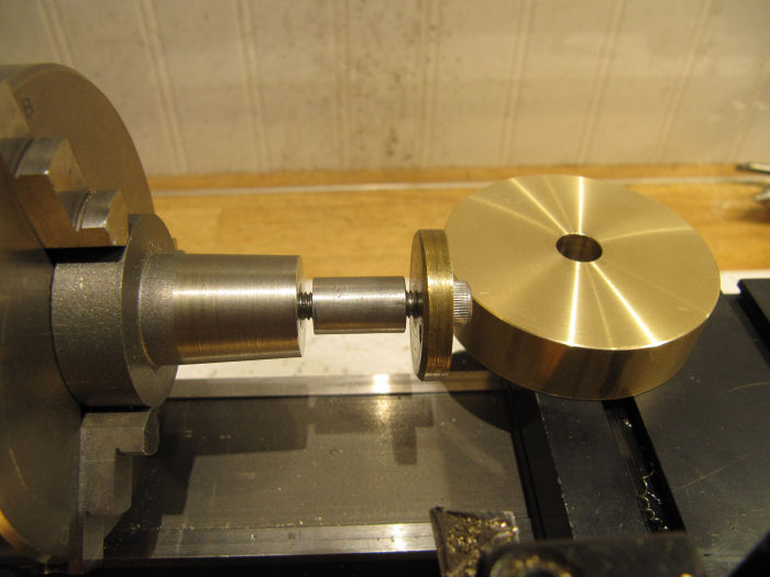

Now, to make sure that my calculations were correct and the cutter is working, I want to make a test gear. The final gear will need to be nearly 3" diameter and .586" thick (the sides of the gear get tapered in on both sides to match the original, that is why it is so thick). I have a slab of brass large enough for that, but don't want to risk it on un-proven methods. So, since I do have about 1 foot and a half of 2-1/4" diameter brass round bar bought cheap as a 'drop', I'll make a test gear from that.
To hold the gear for cutting, I need to be able to do the roughing out as a normal gear cutting operation, the use the hob with the gear able to rotate freely. When making the original test gear, I made up a little arbor that will work for this one too. All it needed was a new center spacer. Here is a picture of the arbor plus the test blank, which was faced to thickness and drilled/reamed for the 3/8" shaft it will ride on. The spacer on the arbor was turned to 3/8" diameter, a sliding fit in the gear blank hole, and a few thou longer than the thickness of the blank. The end cap on the arbor is flush on one side, and countersunk on the other. With the flush side towards the blank, the blank can spin ferely but not move side to side. With the countsunk side in, the blank is securely held for cutting the initial teeth.
