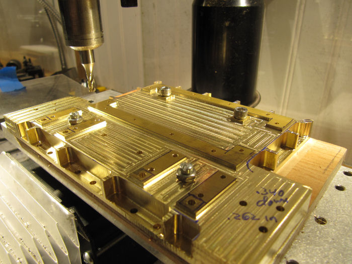

Then started in on the trays under the crankshaft. The bottoms of these areas are curved, deepest in the center along the axis of the crankshaft. Here is the center opening taken down to the level of the outer edges, and a strip down the middle down to the level there. I'll do the other two rectangular openings the same, and come back and trim the bottoms to the curves. Since I am using the Count Number Cranks version of CNC, I'll make up a table of moves to accomplish the curves, using the radius edge cutter. The CAD app will make generating that table straightforward, just need to sketch it and decide on the horizontal moves per cut and generate the vertical offset tablefrom that.

  • Posts: 18719
« Reply #38 on: September 19, 2022, 11:14:00 PM »

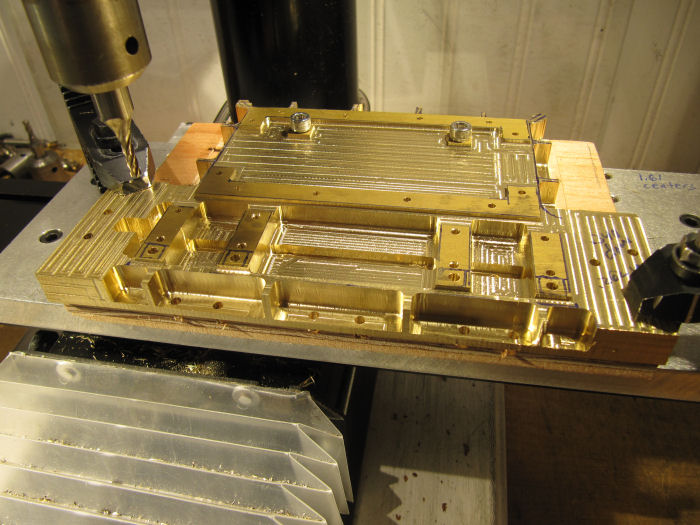

This afternoon got the rest of the openigs along the crankshaft roughed in:
and spent a little time in the CAD application working out the movements for milling the curved tray bottoms underneath the crankshaft. I copied the up/over movements of the mill onto a very high-tech piece of paper:

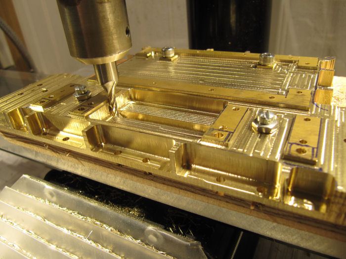

and started cutting the first side of the first opening. The green arrow is pointing at the curved bottom surface. Slight steps, they can be filled in with some epoxy to smooth them out, getting in there to sand the steps off would be tricky.
Next time will do the same to the other side of that opening, and move on to the next one. I can mill the three center ones, the two at the extreme ends will wait till the curved ends are cut.
  • Posts: 18719
« Reply #39 on: September 20, 2022, 04:32:39 PM »
All three of the center trays are now shaped...
Next steps will be to open up the space between the vertical walls on the back half. Then will cut in the recesses for the bearing blocks up front.

  • Posts: 18719
« Reply #44 on: September 21, 2022, 03:39:26 PM »

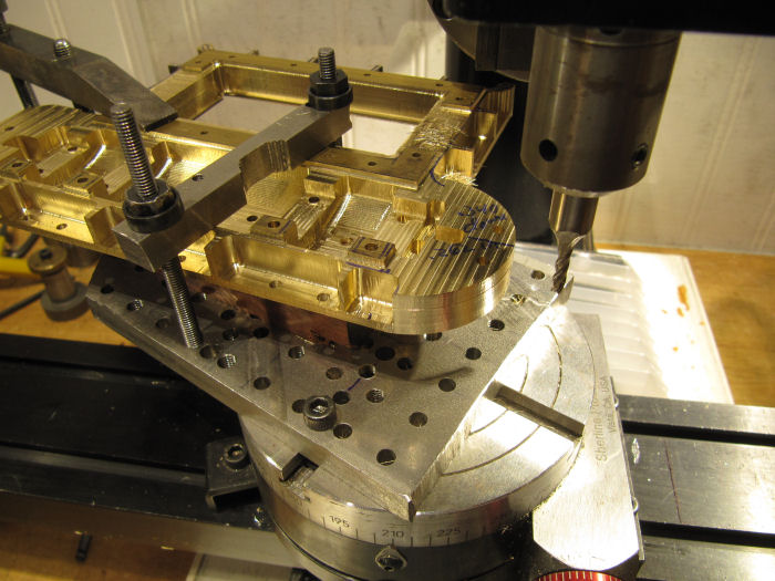

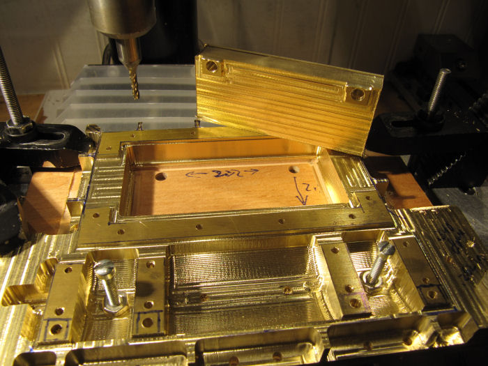

I went around the perimeter of the opening between the vertical walls, cutting down the sides walls and in to leave a flange at the bottom. Since that freed up the block in the center, extra clamps were added around the edges.
Block out of the center...
Then did last step in this setup, milled down the centers of the crank webs. The bearing blocks need to come up a lot higher than the thickness of the block I started with, so they will be bolted in to these slots.

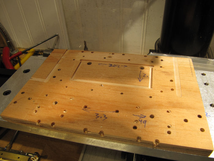

With the last of the square cuts done, the block was removed from the tooling plate. Good evidence of why I wanted the playwood there, its pretty chewed up with all the perimeter cuts and the drilling.

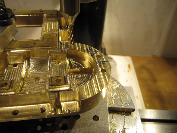

Next steps are to round the front corners. The part was clamped down on the rotary table, over a wood block, with the center of the arc centered on the rotary table. Then rounded off the outside corners back to where the bottom flange and gussets will end.
and then rounded off the inside of the rounded wall, down to the depth of the tray at the bottom. The same sequence used for the other three trays will be used again to shape that bottom surface. While its centered up on the rotary table, I'll cut in the mounting flange and gussets. That will be a lot of nibbling with the rotary table!   Once this first end is done, it will all be done again on the other end.
