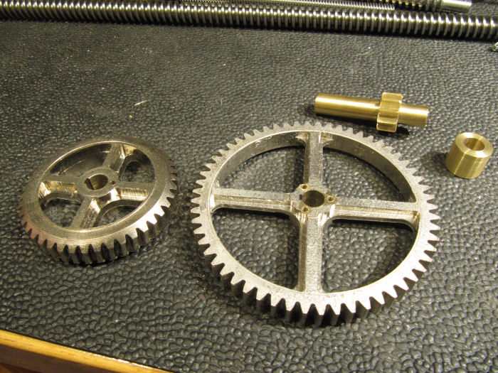

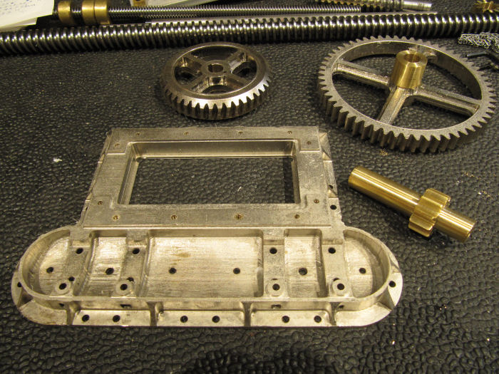

Some more nickel plating, got the second gear done. Again, the area at the hub/spokes will be painted black on both, the outer rim/teeth left the plated color. I am going to wait on the small spur gear since it still needs some shaping at the hub. Right now, the engine bed is in getting nickeled (and dimed?)

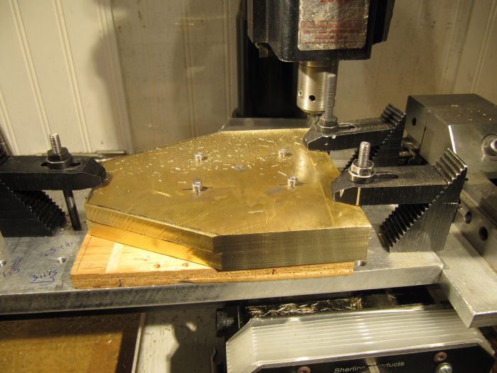

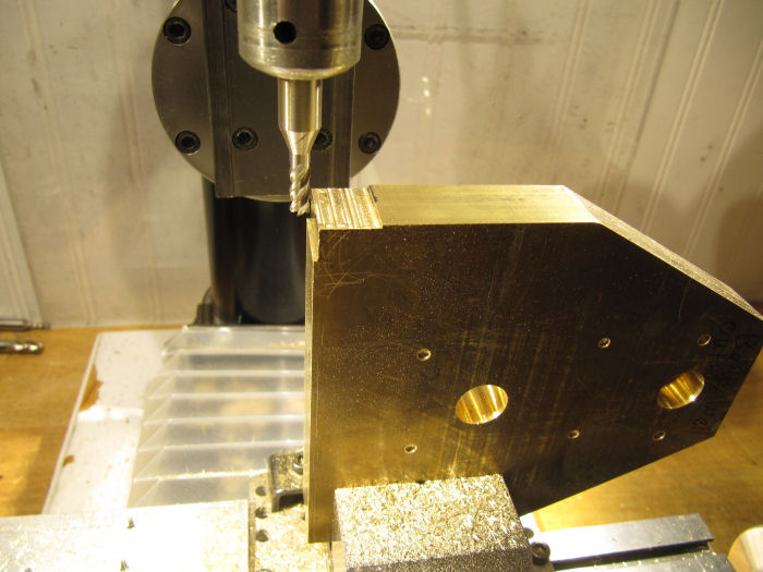

I've started shaping the vertical plates that I got rough cut and bolted together yesterday. Started wiith trueing up the bottom surface:
Then both side faces to get it to final width:
Next will be to take the top to final height, then will do the angled sides.

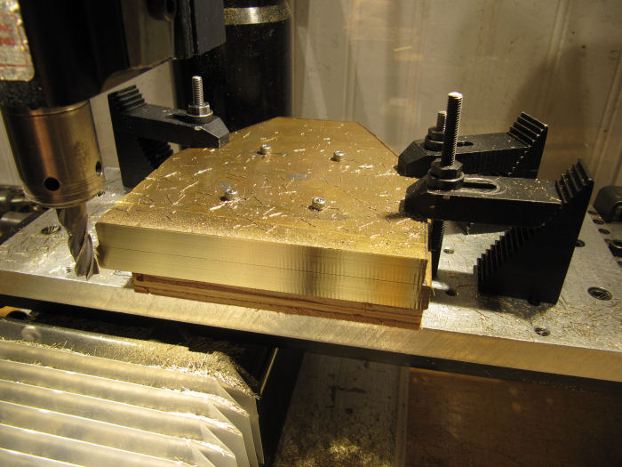

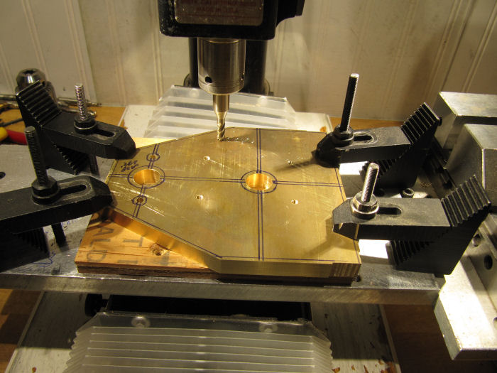

Got the top end of the wall plates milled back to size

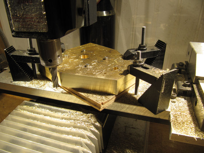

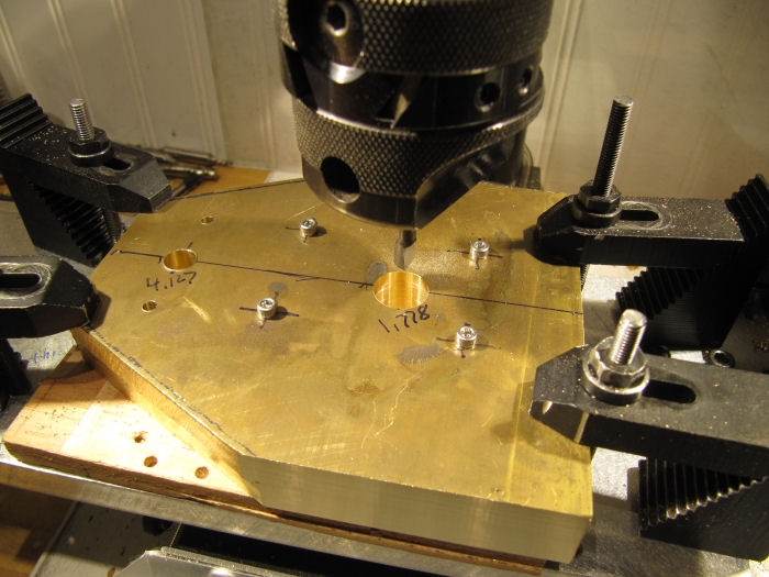

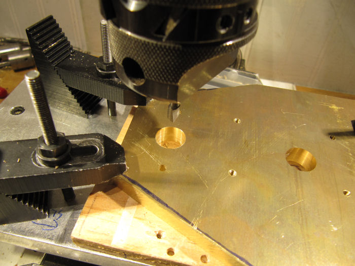

Then was about to remove it from the mill to shape the angled sides, but realized it was the perfect time to drill/bore the holes for the shafts since it was already squared up on the table. Found the centerline, measured up from the bottom face, and drilled the two shaft holes and the 2 crossbar holes through both plates. The lower shaft hole was bored out to size - I took that one wider than needed for the bearing, since I want to put in an insert there that sticks out from the face and has the gussets already on it.
The upper shaft hole on the front plate is set, but the upper hole on the rear plate needs to be larger to take the outer shaft that the spur gear is part of. So, had to take off the front plate from the stack, re-align the plate, and bore the hole in the rear plate out to size. Here again will be putting in an insert.
In the background, had the engine bed in the plating tank. That was a slow process, given its size - had to keep moving the nickel donor rod around in the tank to get even coverage since it deposits more metal on areas closer to the rod. Aside from the raised bosses, the rest of the base will be painted.

Chris, I think with the spokes in black the gears will look nice. As in the original.

Thanks guys!  I'm going to paint it like the ones in your pictures, green and black, its a great look.

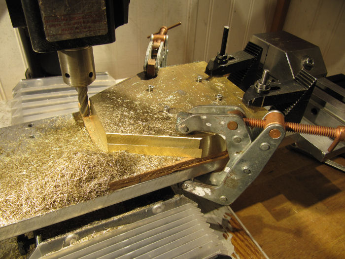

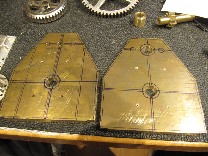

This morning finished up the outside profile by trimming the angled sides to dimension:

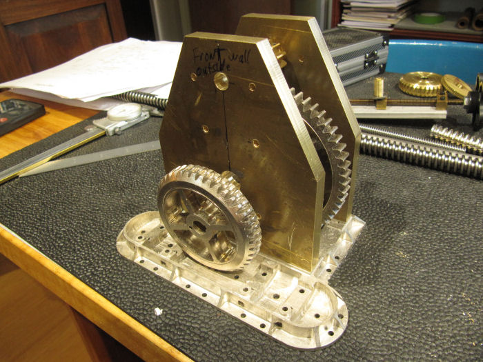

Couldn't resist setting up the walls to see how they look on the base:
There are extensions at the bottom corners that help stabilize the walls in the front/back direction. Those will be silver soldered on later, but I needed to notch for the parts now while the plates are full thickness and can be clamped in the vise better. The walls will be thin after recessing the sides.
Also a notch for the bracket to hold the clutch handle on the front plate only
Sketched on the openings to be recessed into one side of each wall. The patterns are different on each wall.
And set up to start the milling of the recesses. I'll take out the bulk of the material with a normal end mill, then do the finish cuts around the edges with the radiused end mill cutter. The parts around the holes will need to be finished up on the roatary table.
