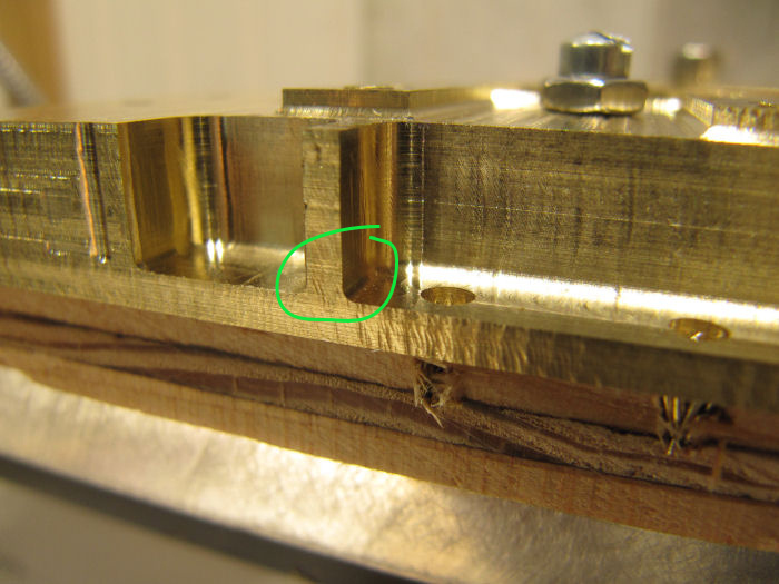

As Mike says the surface speed of the bull nose cutters is higher than the "dead" area of a ball nose so they cut well, also good for flat surfaces if your tram is slightly off They also tend to be 4-flute so can be fed faster for the same chip load
The down side for things like those webs is that the vertical fillet will be half the cutter diameter but the corner radius of he cutter will be less so you will get smaller fillets on the horizontal internal corners than the vertical.
Where they come into their own is around raised features like the pads on the One-One base, the internal fillets to the sloping sides of the base and the flywheel cutout were done will a 4-flute 4mm ball nose
Or around the raised bosses on this base, in both cases the same cutter did the upper "cast" surface and I did not have to use a second one to do the boss fillets
Image shows effect of using a 4mm dia x R1 cutter

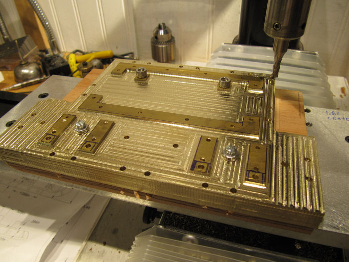

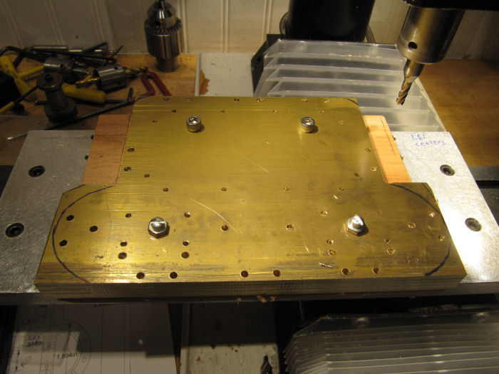

Back in the shop today. The outer edges have all been taken to dimension, except for the curved front corners which will be done later on the rotary table. Some of these pictures are a little dark, I had to swing the work lights away to reduce the reflections or the camera washed out.
Then I put in the new end mill cutter I got with the radiused corner to mill in the bosses on top for the vertical walls and bearings. Very nice results with it, it softens the appearance of the inside corners a lot, much more like a casting would be. This cutter has a 0.030" radius on the end with a 3/16" diameter on the main cutter. Thanks for the tip on those! It should make the gussets in the outer flange look much better.
The top mounting platforms are all done, next will start in on the bolting flang around the perimeter. The ones on the curved sections will be done later.
For the crankshaft bearings, there needs to be a set of posts sticking up higher. I think for those I'll actually mill the bases down and bolt on another piece with the U shaped gap for the bearings. That will be easier than silver soldering on 8 narrow square posts.

« Reply #28 on: September 18, 2022, 05:30:33 PM »
Got a start on the mounting flanges around the perimeter. Was able to get a photo of what the radius corner end mill gives, circled in green in this close up:
In person, it does give a nice look to it. As mentioned before, the vertical inside corner in that shot is a larger radius since its the size of the cutter (3/16" ) so I will do some tests and see if it works out better to take a second cut later with the part turned up on its side, to reduce the radius on the other corner. The very bottom where three edges come together would not be reached, but that may look okay, worth a test on it.
