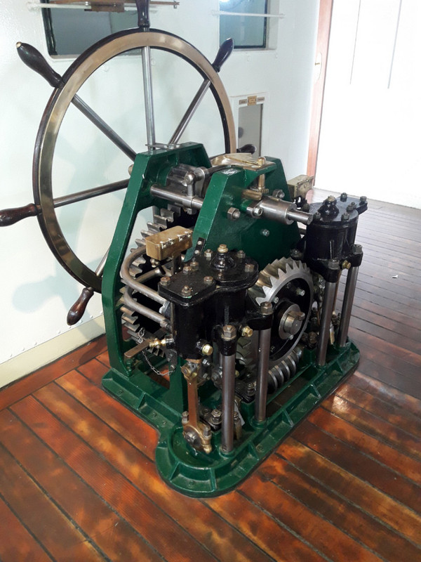

Short version is, on larger ships in the steam era it was not practical to have the ships steering wheel just connected directly via ropes or chains to the rudder - the rudders were just too large, and the forces on them too great, requiring a lot of effort by the helmsman to steer the ship. So, enter the steam powered steering engine (later replaced with hydraulics and electric versions). The one that Michael restored has a two-cylinder steam engine that powers the unit. As the helmsman turns the wheel, a worm gear advances a traveler nut which opens the valve on the engine, which runs and counter-turns the traveler nut back, closing the valve when it has reached the point that the helmsman turned the wheel to. Very much like the servo-centering on a modern radio control model, except all done with gears and steam engines.
Here is a picture of an original steering engine:
More pictures and videos on the other thread mentioned above!

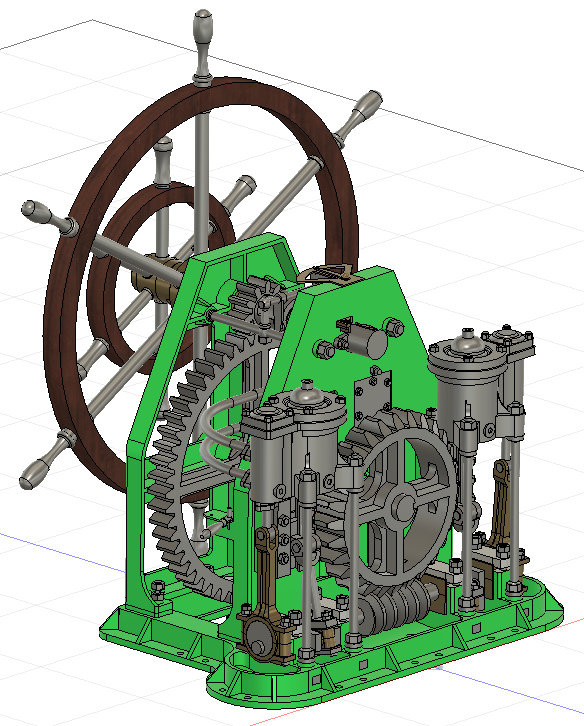

I turned the pictures/drawings/measurements he sent me into this CAD version so I could generate a set of plans (posted on the other thread if you want to build one).

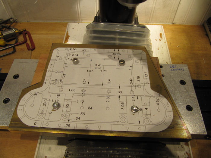

On with the build! I decided to model the engine at 1:6 scale, and plans were generated for that size. That scale makes it large enough for practicality, and small enough to fit on my Sherline lathe/mill. Going to start with the base and work my way up. A tooling plate was mounted on the mill table, and a piece of thin plywood added as a spacer so I can drill/mill through the part and not chew up the tooling plate.
The locations for the screws were picked so the front two are where drain holes will be under the crankshaft, and the back two are in an area that will be cut out later. Then, drilled matching holes in the brass blank to bolt it securely to the table. I put a printed out copy of the base plan on it for reference. I will NOT be using it to position holes or edges, its just there as a double-check that I have not miscounted the number of turns on the handwheel. Printed paper copies are not reliable enough for cutting to - in my days developing printers for Kodak, I learned how many ways there are for errors to creep in as paper is fed, how much paper moves with humidity/temperature, and how many ways the printers themselves subtly change positions to round to its mechanics.
When I generated that version of the plan, I located the origin at a lower left mounting hole, and all measurements to hole centers are referenced from that position. That will let me do my version of CNC - Count Number Cranks - on my manual lathe. Once that position is moved to the handwheels were zeroed, and all holes/edges will be referenced from there. Before each set of holes I move back to there and do the X/Y moves out to the start of each row, and count turns/ticks from there.

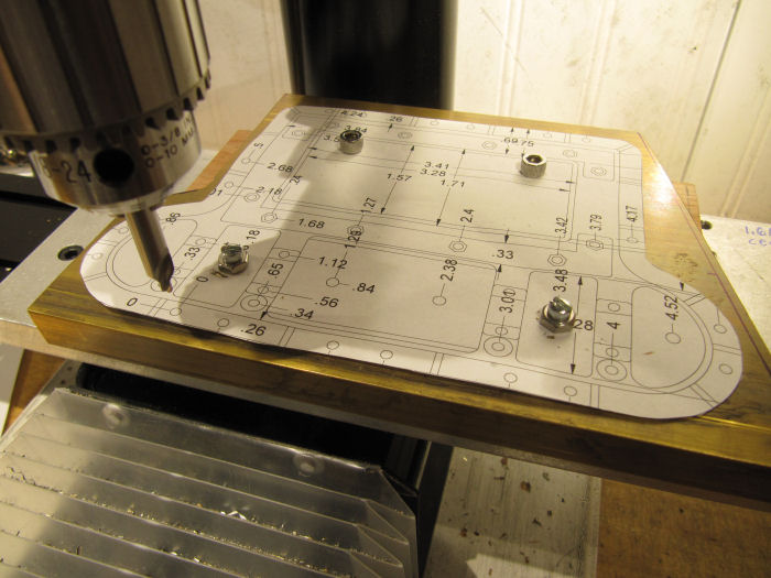

Here is a picture after going round and drilling the mounting holes around the perimeter and the rest of the drain holes under the crankshaft.
Next session I'll start in on the mounting holes for the crank bearings and the vertical walls, those holes will all be tapped 4-40.

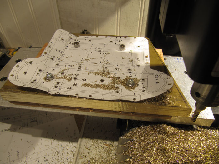

After lunch I got the rest of the holes drilled...

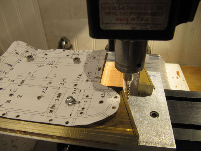

Then started in shaping the outer profile of the base. I went back to the zero point from the drilling, moved in the radius of the end mill cutter and re-zeroed the handwheel, then moved out again the distance to the edge of the finished block. Milled off the front face in several shallower cuts:
Moved back the distance to the rear face plus diameter of the end mill, and trimmed off that edge too
Then started in on the first side
The curved area near the front will have to be done on the rotary table later, I want to do as much as possible in the current setup first. And again, the paper is still there just as a double check on my moves, I am not using it to set the cuts. Along the outer edges, the face will get trimmed back more to form the bottom bolting flange, leaving the vertical gussets in place.
