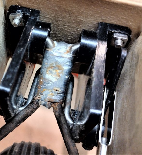

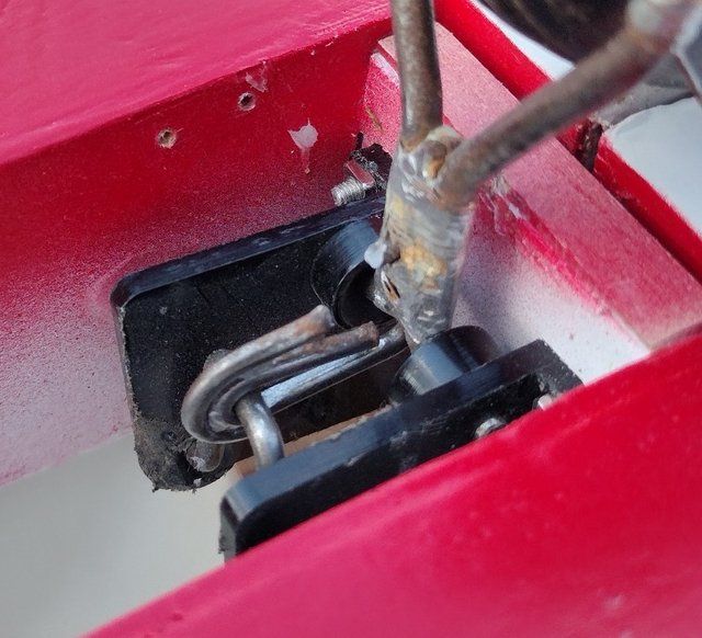

When I made the original (in 1982) I made jigs to bend the 10swg wire struts so I made a spare set of wire parts which I still have, so I dug these out to make a replacement leg assembly. Soft soldering is preferred because it doesn't de-temper the piano wire like silver soldering would (it's pretty-well impossible to recover the temper with heat treatment because piano wire is "patented" rather than just hardened & tempered). In 1982 I did this using a 400w electric soldering iron, binding with fuse-wire and then soldering using an active flux (bakers fluid). When I came to try this on Sunday I found I could no longer buy decent acid fluxes in any shops around here, and my 400w iron no longer works. So my only option was to use a flame torch gently "wafting" to ensure the temperature stayed below 300degC and applying solder. But no matter how much I carefully cleaned the wire back to bright steel I could not get it to tin before the torch oxidised the surface again. The results were pretty ugly even by my standards:
I have no confidence in the strength of this, so I'm probably going to de-solder it all and start again. But what I really need is some decent acid flux for steel - can anyone recommend anything that I can buy in small quantities in the UK? Can anyone recommend a better way of going about it?

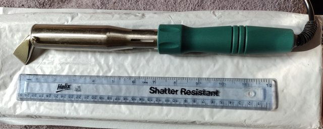

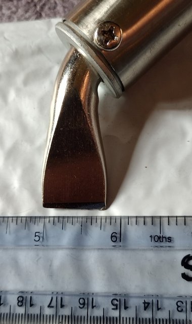

Nope, don't have anything like that. But I do now have one of these:
I feel like doing a Crocodile Dundee - "Nah - that's not a soldering iron. THIS is a soldering iron..."
 ;D
AS

OK - That IS a VERY Big Iron  :o
I only hope that it is a good Tip too .... as that is usually the first thing that goes with a Poorly made one ...
Even the Pro Soldering Irons has the Tip being the part that needs replacing from time to time - but there is a huge difference in the 'Between Time'  ;)
I hope this solves your problems so you can get it Airborne ASAP  :cheers:

This iron will be used for things that I probably only need to do once every 4-5 years, so I'm not that fussed if the tip doesn't last.
AS

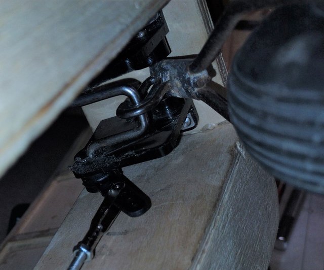

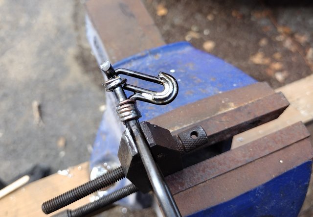

To round this off - cleaned back the parts, a dab of bakers fluid and that iron tinned the 10swg piano wire like it was stranded copper flex. Assembled the parts in a clamp, applied the tinned iron from the underside and the solder from above to tack it together, then wrapped in 1mm copper wire and filled the joint. Washed in bicarb solution to stop it corroding and the whole thing is now back in the aeroplane ready for Saturday.
Bottom line? No substitute for a big iron!
