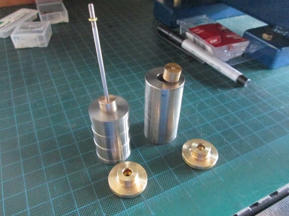

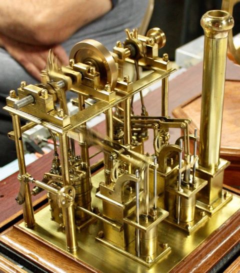

With the 2-Bits v-twin nearly completed, I started thinking about the next project and decided to make it a return to steam. The 1837 HMS Gorgon engine as built by Guenter Kallies caught my eye and my interest. His plans and write-up on the build may be found here:
https://modelengineeringwebsite.com/Gorgon_engine_build.html
Here's an image of the ship, and a shot of Mr. Kallies finished engine.
For my build I'm scaling the plans to 70%, which allows me to use a bar of 1” OD stainless I have on the shelf to get the cylinders out of. In Alibre I can model the parts using the metric dimensions on the Kallies plans, scale that, then can produce a working drawing with either metric or imperial dimensions (for me in the US, imperial is generally more convenient).
During some dead time while waiting for ignition parts for my v-twin engine build, I made a start on the SS cylinders, bronze pistons (without o-ring grooves yet), SS piston rods, and brass cylinder caps.
