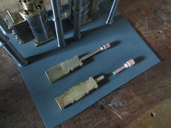

During some dead time while waiting for ignition parts for my v-twin engine build, I made a start on the SS cylinders, bronze pistons (without o-ring grooves yet), SS piston rods, and brass cylinder caps.

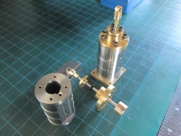

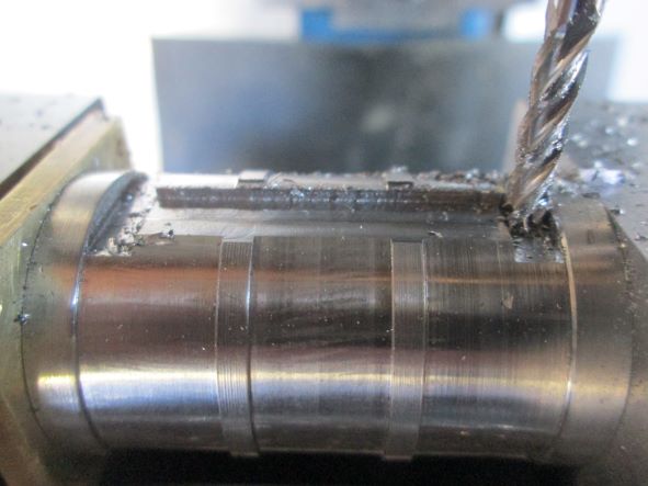

OK, I'm starting to focus more on this project now. I don't think I'll do a detailed build log this time though, but will just update my progress periodically.
Both cylinders have been completed, with the exception of drilling/tapping for the studs that will fasten the steam chest. It looks like those may have to be 1-72, so care will be required tapping the stainless. I will wait to make the chest cover first, and use that as a drilling template for everything that goes under it.
The cylinder covers are fastened with 2-56 screws, and that went fine. I helped myself by drilling one size over the normal tap drill. Fear not, those SHCS will be replaced by studs eventually.

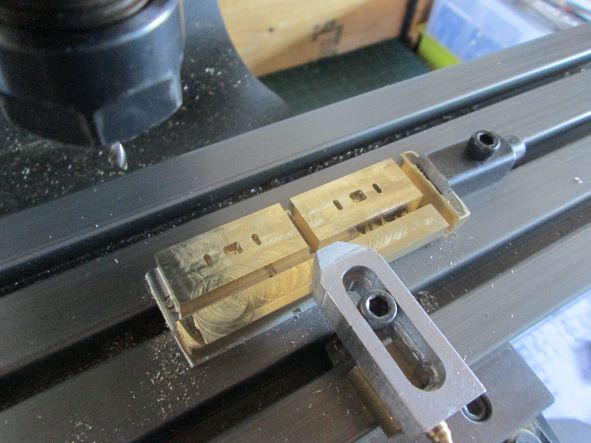

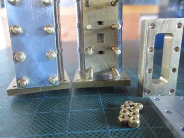

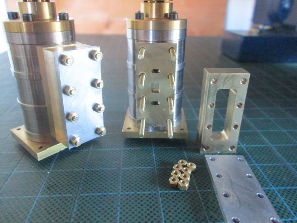

I've gotten the port plates, chests, and chest covers chunked out and attached to the cylinders.
I was nervous about tapping 16 1-72 holes into stainless until I realized I didn't really have to tap very deep. A few threads would be enough to hold the studs firmly vertical, then I would lock them in with red Loctite. This worked out well. The studs started as 1-72 hex head screws. I made some "tall" nuts from 1/8" hex stock. These were threaded on up to the screw heads. Then the screws got a tiny bit of Loctite on the end and were inserted through the valve chest parts and into the cylinders, using the heads to tighten down. The nuts were then run down to the chest cover. After allowing time for the Loctite to cure, the screw heads were cut off using a Dremel and an abrasive cut-off wheel.
The valve glands and steam ports are still to be added.

So, did you Loctite the port plate onto the cylinder rather than silver soldering it?
