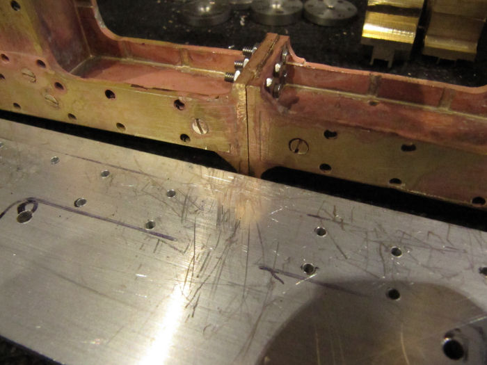

The alignment is done down the length of the engine bed, as near as I can tell with a long straightedge on the inside faces of the bearing block holders.   :whoohoo:   The final tweaks will have to wait till the bearings themselves are made and can be tested with the ground bearing rod stock (arriving this afternoon). It is sitting flat on the floor plate, and appears to be aligned, though I know that till the actual shaft is tried/lapped to the bearings, it won't be possible to know if it needs a last tweak, but there is enough adjustment in the bolt holes, so I am calling this one a win for now.   :wine1:
Tghs: glass beading would likely look very good and help the paint. I don't have a compressor with enough flow to drive a normal size blast cabinet/gun, I do have one of those airbrush sized sandblasters that can throw fine grit. Its good enough to blend out tool marks before painting, but it would be very tedious for this much surface area.
Kim: in the spaces between the inside end sections and the middle ones, no, there is not enough room for a socket, there is only 1/2" from the screw head to the closest web, and part of that is under the top/bottom rails. So, best I am likely able to do is get the nut started with tweezers and snug it down with open end wrenches. Very tedious, but do-able. On the joint between the two middle sections, there is plenty of room to work like there was on the outside ones. So, its just the four sets. Absolute worst case, if I cannot get them in, would be to glue in some shortened screws as dummies, but I don't think that will be neccessary.

With the engine bed frame rails all together, it was time to get them attached to the floor plate. Started out with the holes under the bearing blocks, where I could direct drill through the holes in the frames (with the blocks removed). Started out with the same clearance drill size used to make the holes in the frames, to make a guide dimple in the floor plate. Then came back with the tap drill size and went through the plate.
Tapped those holes. You can see the openings near them that give access to the bolts that hold the bearing blocks on.
Then ran screws into some of those holes to hold the frames in alignment, and marked out for the rest of the holes around the frames. Because of the overhanging upper rail, I couldn't run the drill down through the holes directly, so I found a hex wrench that would just fit in the holes, and used that to mark the locations. The tip of the wrench was dipped in some black paint and then pushed down through the holes to leave a paint mark on the plate in the middle of the hole. Went around all the holes, then left the paint to dry.
This morning I removed the frame from the plate, and used the paint marks to drill/tap the holes
Now I'm going around and running in all the screws. Started with the ones down the center to align the frame/plate, then went back to get the rest put in. Bunch more to go...
Next step will be to glue in the gussets with a dab of loctite, and start milling/drilling to attach the bases for the upper frames...

Have you considered using JB Weld adhesive to glue the gussets in place rather than Loctite, which is only a retainer (acrylic) ?
Just a thought
  • Posts: 18722
Re: Chris's Build of Battleship Ohio Engine
« Reply #623 on: March 18, 2023, 06:17:15 PM »
Hi Chris,
Nice work on the bedplates.   :ThumbsUp: :ThumbsUp:
Just a thought
I did consider it, but the JB just loves to get all over my fingers (right before my eyebrow itches of course), elves shoes...  The loctite red dabbed in the slot before running in the plates should be enough to hold, they just need to be held in place against vibrating out again. Its also easy to clean up any squeezeout. I've used it for similar things in the past with good results, and I've got a large bottle of it that I won in the raffle at the RC submarine event in Carmel last year.
