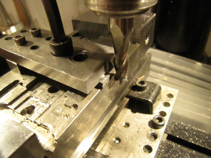

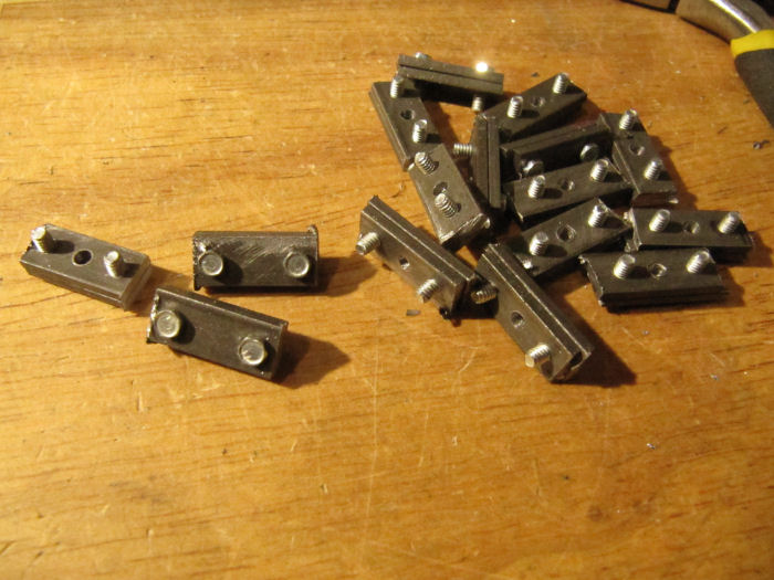

After cutting all the plates from the long bar, they needed to be trimmed to a consistant length. The pairs of plates were screwed together with some short 2-56 screws, and held in the finger clamp fixture (which has been used for many parts over the years, modified lots of times) for milling. To get them all in the same location, two 2-56 clearance holes were drilled near the edge so the two screws in each set would sit down in them. Then set the milling distance from the end once, and just ran all the parts through, one pass per end.
Here are the parts - the three on the left were trimmed, the rest of the pile on the right was ready to go. You can see how the ones on the right are all slightly different lengths.

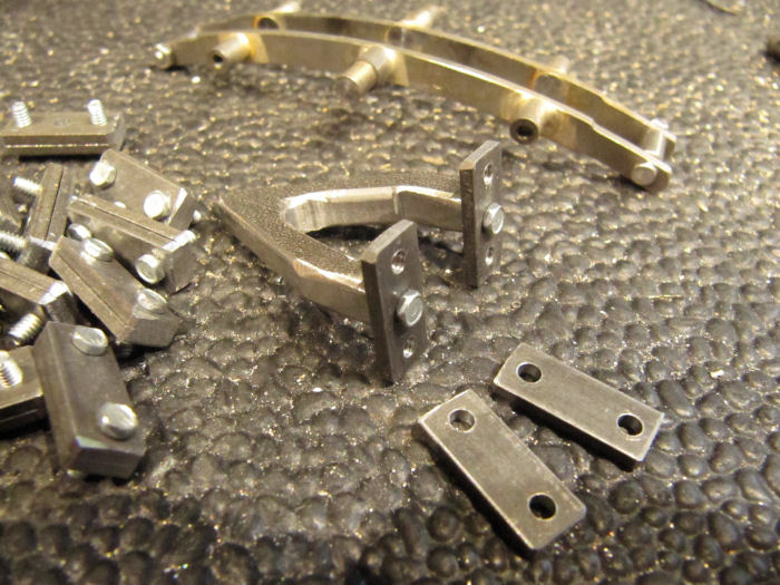

After trimming a quick touch on the belt sander cleaned up the burrs left by the end mill. Here two sets have been screwed to one of the yokes to show where they will go. Still need to make the bearing blocks that will be held between the plates, and need to silver solder all the bottom plates to the yokes. The center screws will hold them for soldering, then the screw heads can be trimmed off.
And I also need to make another similar set for the links from the crank arms to the center posts...  Lots and lots of parts just in these reversing links!

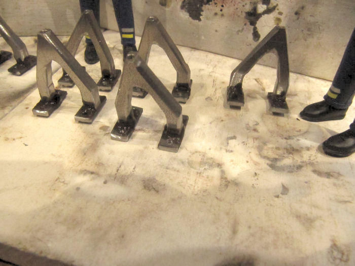

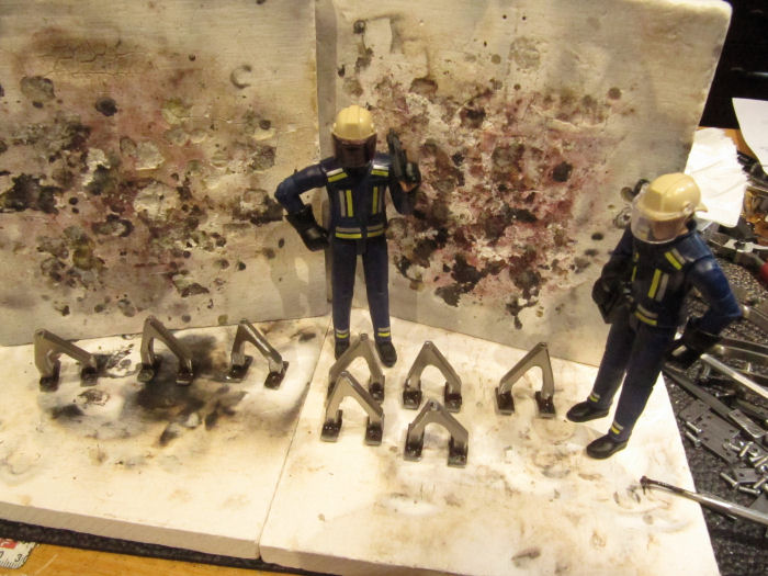

CNR, the soldering actually went pretty quickly. I screwed on and aligned all the plates, then the shop elves put on their little fire suits and got the parts all fluxed up (  :mischief: ) for me.
Closer look - using Harris Black flux, comes as a powder in a little plastic jar. I added water and mixed it all up a long time ago, add a little water now and then to keep a little water over the top. Use a dental pick to scoop out some of the paste and run it in the joints.
Got out the mapp gas torch with a pencil flame tip, and ran down the line heating up each post and plate in turn. When the flux ran and started to turn clear, touched the joint with some X-easy silver solder wire and kept heating to get it to flow around each joint. Just took a few minutes to go down the line.
Letting them cool off now, will give them a rinse and brush off the soot then give them a soak in some vinegar with salt added for the afternoon to clean them up.
Need to make up more batches of the plates, both for the links over to the crank arms and also for the bottom ends of the eccentric arms where they bolt to the eccentric straps...

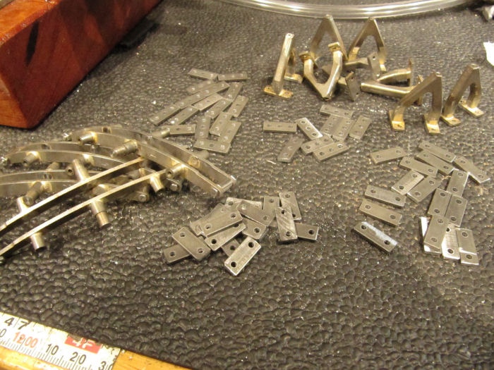

Got the rest of the little plates made for all the links/bearing blocks:
Glad all those are done!  Now, looks like its time to make another big pile, this time all the bearing blocks for the links. Need 32 of them...   :facepalm2:
