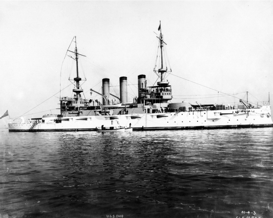

Here is a picture of the battleship Ohio, BB-12, commissioned in 1904. It was one of three ships in the Maine class (these are the next generation AFTER the Maine that blew up in Havana Harbor). It was part of the Great White Fleet that did a world tour.

right up the predred time frame,, look at those pretty steam cutters moored alongside.. :whoohoo:

Boats and ships back then DID look great, didn't they!
