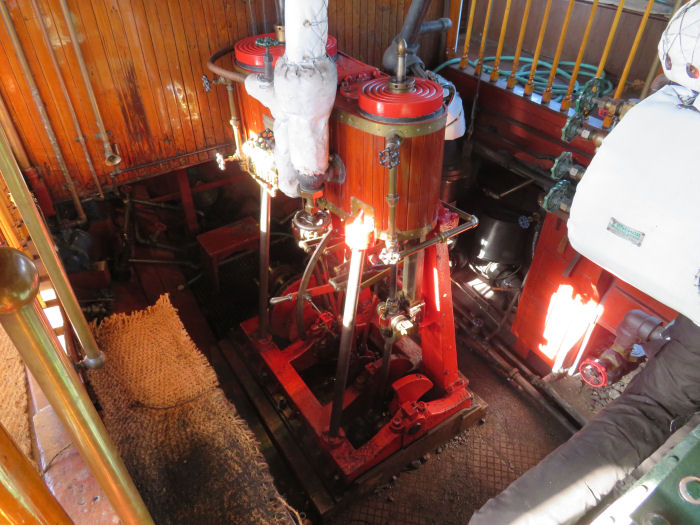

This past fall, with the help of Ron Ginger both in arranging the access to the engine for a day and in measuring it, I finally got a chance to get up close to the engine, rather than just watching it from the upper gallery around it. Not as little a kid anymore, but still a kid inside!
First step after spending the day measuring the engine and taking many many (not enough) pictures, was to model the engine in the Fusion 360 CAD software:

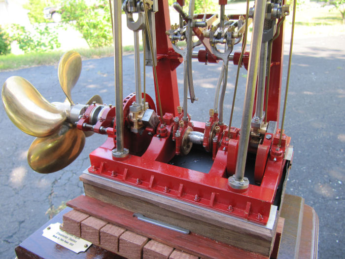

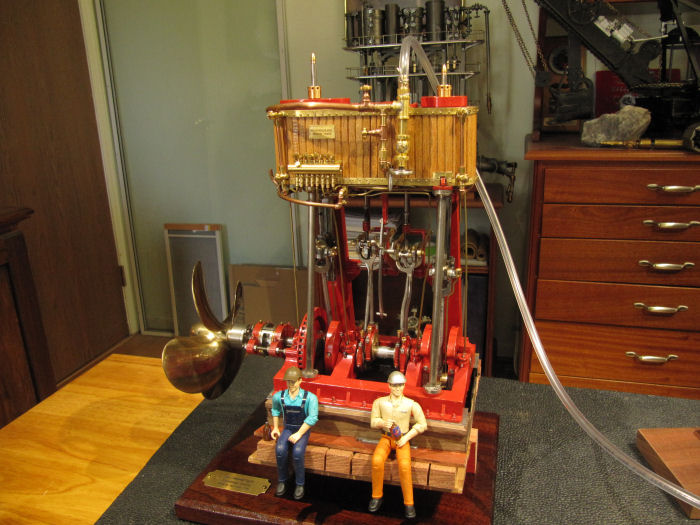

This afternoon the engine chugged its way out to the front yard for some portrait shots:
The steam pipe from the boiler would connect to the open fitting in the upper center of the engine block in this next photo:
The pipe at the left in this picture is from the receiver drain, on the ship that pipe would lead up to one of the gauges on the back wall of the engine room.
And of course a new video of the engine running, on compressed air. It self starts on 15 to 20 psi, and has a pretty good range of speed using the throttle valve on the side. With compressed air rather than steam, it likes to have the starting valve cracked open to add a little extra pressure to the low pressure cylinder since compressed air does not expand anywhere near as much as steam does.
