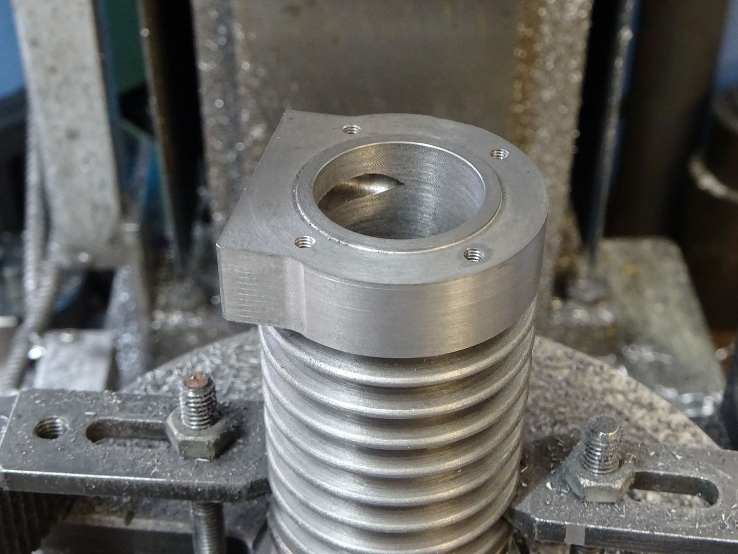

Off we go then  :paranoia: First up the base casting. I need to be able to hold it so I flattened the underside and made the "sticky out bit in the middle" so that it had square sides:
Now I can hold the casting so time to turn it over and find the centre. It seemed obvious to use the hole in the centre:
Then I checked with the sides and found the hole was off set  :facepalm:
Then I started playing try to calculate the missing hole dimensions  :wallbang: The distance out for the crankshaft bearing (29.4mm) is missing as is the distance for the mounting for the water pump (centre 43.15 mm). Before drilling all the holes for the tapping sizes:
The top of the casting was 4.8mm above the main flat area so first job was to take the tops off and then to cut the slots for the four columns:
Lastly milling the surface for the crankshaft bearing housing:
The main flat surface of the casting is still well over the 3.18mm but I am going to leave that for now and write on the casting that it still needs to be taken down. I will tackle this later once I have a suitable mounting arrangement  :)
