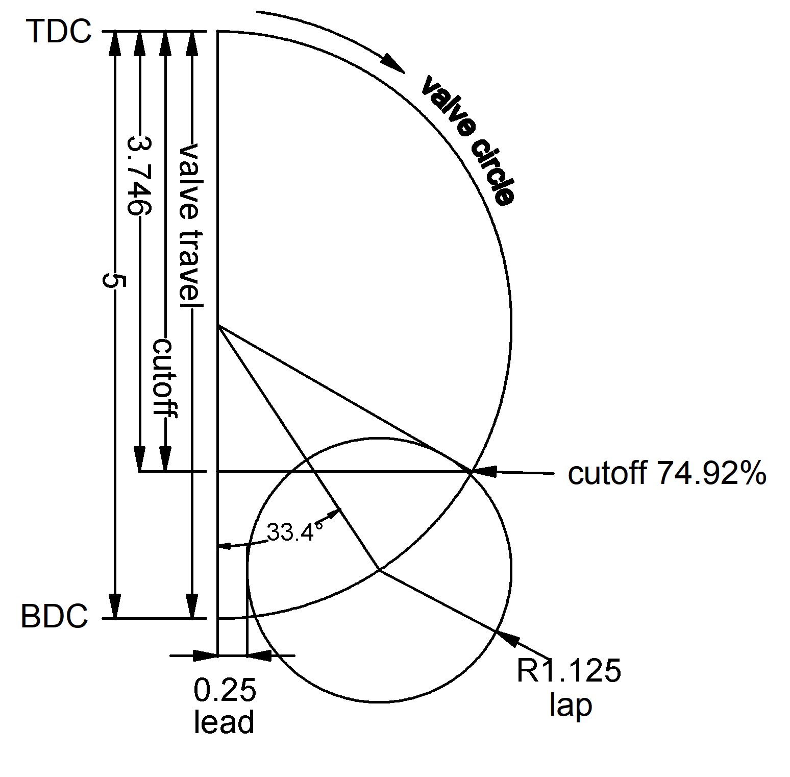

I struck up an offline conversation with Chris about the valve gear for the Sabino because he made a comment that he wanted to make this engine with a lot of detail. The only valve gear I have really studied is Stephenson link motion. This is mainly because of my interest in Shay locomotives which are essentially a marine engine on a locomotive. The very first Shay built by Ephraim Shay was a marine engine on a flatcar. A Shay locomotive is really just a marine engine that got lost in the woods.
When I discovered Bilgram's diagram I was thrilled as I thought my struggle to learn valve gears was ended. Bilgram's diagram is a powerful tool to design a steam valve but it does not really help in the design of the rest of Stephenson link motion or any other type of reverse gear.
It was easy for Chris to get accurate measurements of the link motion but when I asked about the angle of advance he gave me an approximate number because it is not really possible to say looking at a built engine where the center of the eccentrics are in relationship to the crank pin for the cylinder.
If the eccentrics were keyed to the shaft and fixed like a Shay and this was an IMPORTANT detail to the builder then the angle of advance would be a key piece of information. Lucky for me the valve travel and the angle of advance are listed on the drawing card index for every Shay.
With those two numbers and knowing that Shays used 1/16" of lead, I can calculate the cutoff for that Shay. I do not think it is a coincidence that this is true.
I was not sure what would be a good number for the cutoff for this engine but in the book "Machine Drawing and Design" by William Ripper, there is a design for a two cylinder launch with all the parts and a Zeuner diagram. I thought I could simply look at the Zeuner diagram and state the angle of advance but it is really not quite that easy even if you have drawn that diagram as a learning example. I took the easy way out and drew a Bilgram diagram using ONLY the valve travel, the outside lap, and the lead. This worked to 74.92 degrees.
I also told Chris that for model engines it is customary to set the lead to zero. This is a match to the advice given by Dave on the Sabino thread.
The last indicator card for Sabino that I saw was 75% cut off and just a smidge of lead.     I would dispense with the lead on an engine this small.

As I mentioned I only used three numbers to calculate the cutoff for the Ripper launch engine.
1) Valve Travel
2) Steam or outside lap
3) Lead or the amount the valve is open at TDC
Most readers will know that TDC stands for top dead center and BDC stands for bottom dead center. This gets rid of the clumsy naming found in a lot of old steam books where the ends of the cylinder are called crank end and head end. A steam engine had a head at both ends. I am mostly interested in vertical engines so I draw valve diagrams with TDC at the top and BDC at the bottom.
Here is the Bilgram I drew to find the angle of advance of the Ripper launch engine.
Cheers Dan

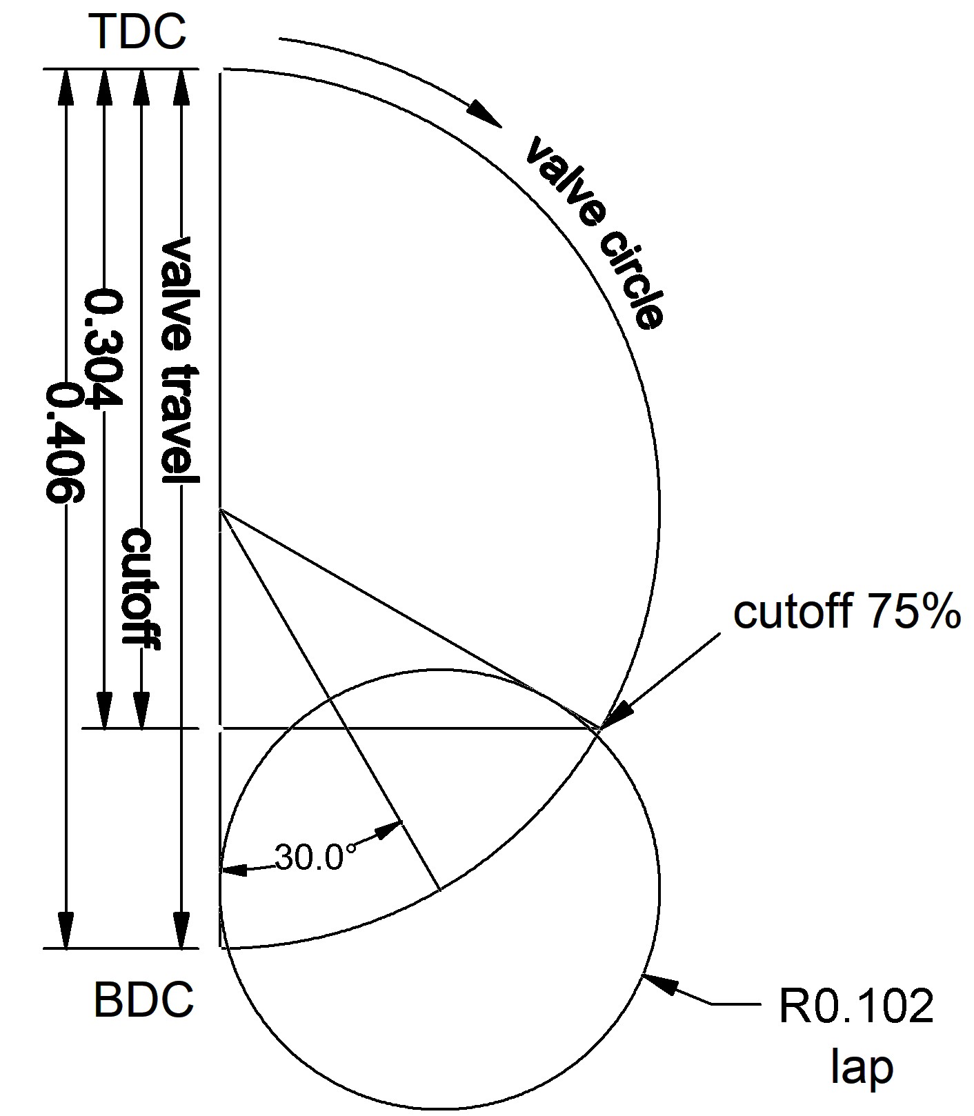

Chris, I can sketch one up it will be quicker than scanning Cecil H. Peabody who was the head of the Marine Engineering Department at MIT. If you have the book "Valvegears for Steam Engines" by Peabody turn to Plate XV in the back and read page 41 for the explanation. I can get this for the next post. The Sabino has a piston valve with inside admission and that is a new one for me and as you already know that flips the eccentrics just like switching to crossed rods.
With the suggested 75% cutoff and zero lead here is the preliminary Bilgram for the Sabino.
Notice that the angle of advance is now 30 degrees. This will be the case for any steam valve with 75% cutoff and zero lead.
I have made a physical analog of the Bilgram diagram in my head so I can easily make changes to see what is going to change with the valve.
I think the valve travel line is a pole. The steam lap is a tetherball. The angle of advance is the string supporting the ball. The lead is how much distance the ball is from the pole. With zero lead the ball is touching the pole. The Ripper launch is shown with 1/4" lead so that is the distance the surface of the ball is from the pole. For me, this works well so have a whack at the ball to see what happens.
Cheers Dan
