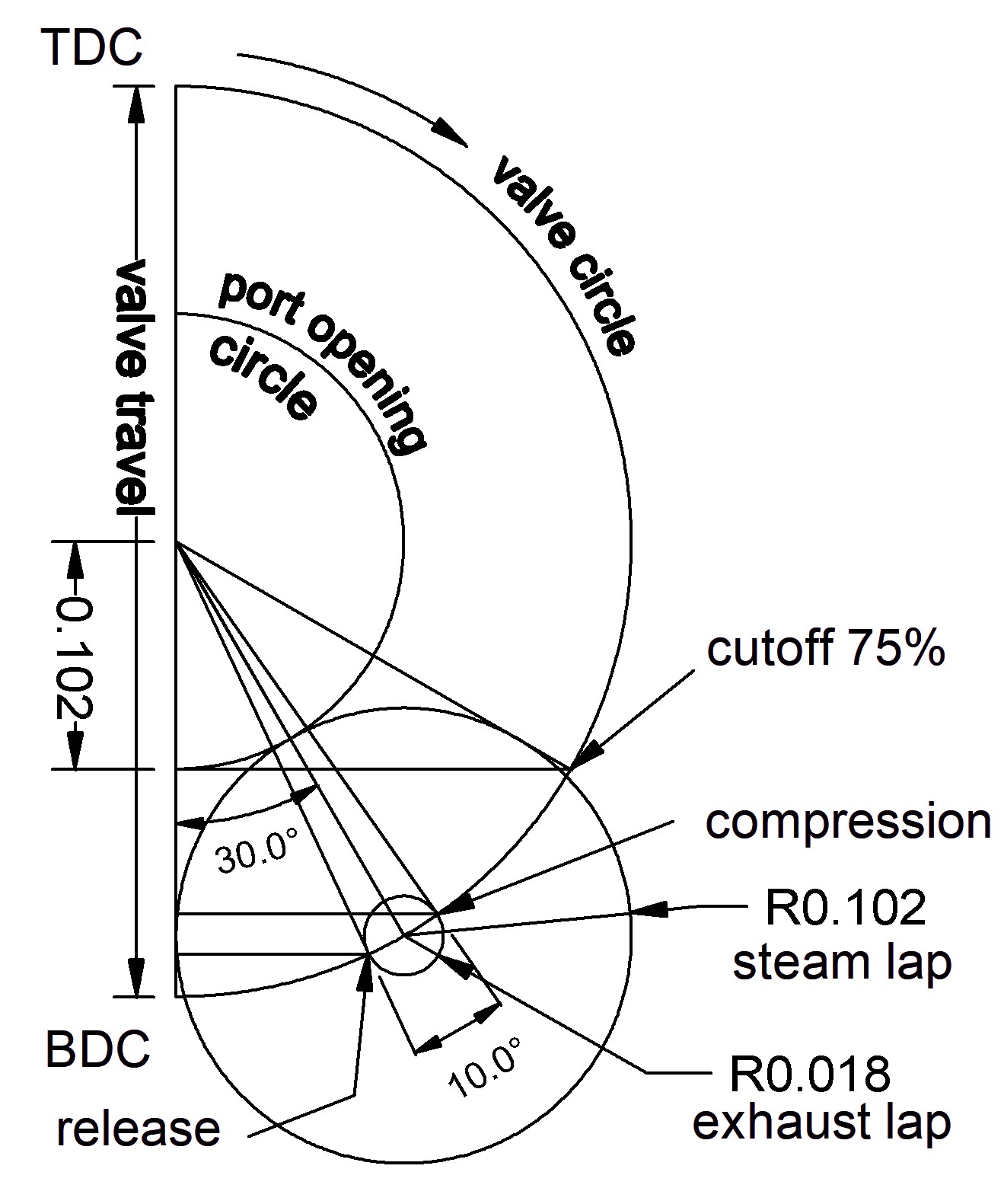

Zephyrin many thanks for that fine comment. This is not the first time I have written on this subject but this time I am trying to make this subject as clear as possible. Reader feedback is more than welcome to help keep this clear and simple.
Now to add exhaust lap to set compression and release. I am not sure what would be a good percent stroke for compression and release which is what inside or exhaust lap sets. I checked the Ripper launch and the inside lap ball is 9.5 degrees wide. I rounded that to 10 degrees for no real reason except to have whole numbers for the angles.
Here is the construction with inside lap which is a ball inside the steam lap ball. Just like the steam lap the center of the ball is on the valve circle and the inside lap has the same center point as the original lap ball.
Now I added a half-circle with the center point that is half the valve travel and is tangent to the steam lap ball. This is labeled port opening circle. The radius of the port opening circle is known as the port opening.
Now, this next bit is somewhat tricky as the words I will use seem like they mean the very same thing. The port opening is defined as the distance of the extreme edge of the valve at full travel to the extreme edge of the steam port. The other term is the port width which sounds like the same thing. For the initial layout of the valve, we will assume that port opening is equal to port width so the valve at the end of travel just completely opens the steam port no more no less.
In the next post, we will start laying out the valve with the starting point of full valve travel to reinforce the concept just made.
Cheers Dan

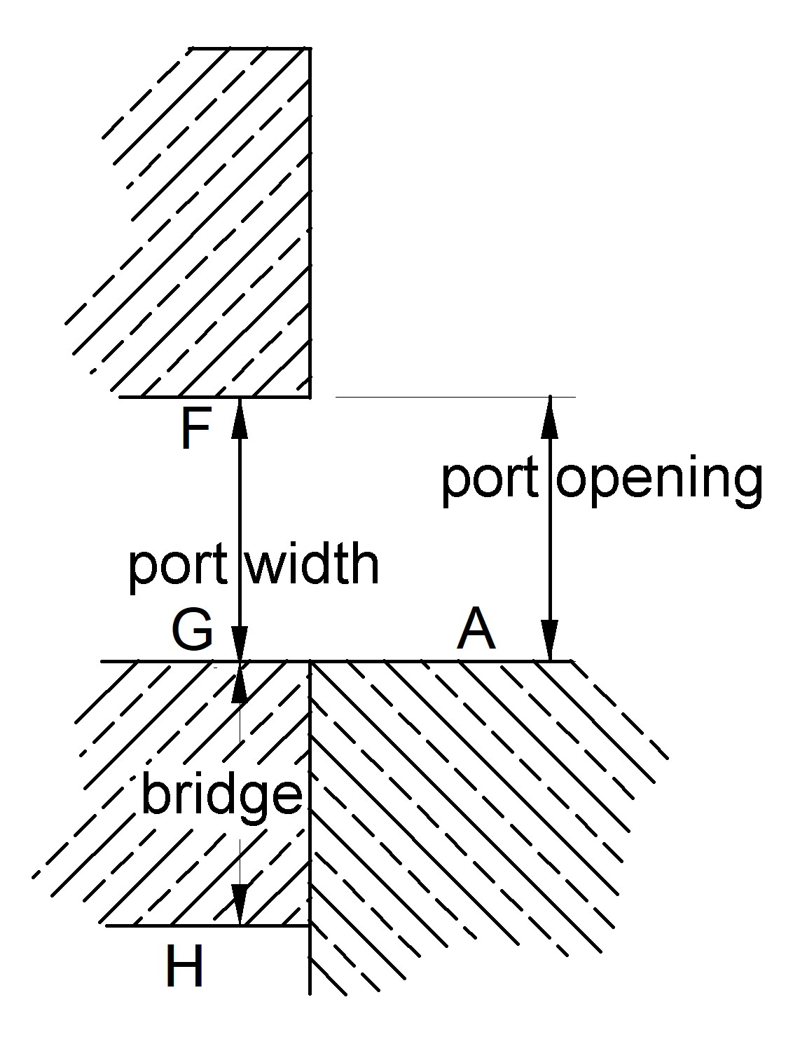

Now it is time to change books to “Audels Engineers and Mechanics Guide 1” This is where I first learned about the Bilgram diagram and there is a reference to Mr. Halsey’s book on slide valve gears, so I tracked down a copy. I also tracked down a copy of Hugo Bilgram’s book “Slide Valve Gears” 1878. This is the very same Hugo Bilgram that invented a faster way to make bevel gears using a modified shaper to generate the teeth.
https://openlibrary.org/books/OL7052737M/Audels_Engineers_and_Mechanics_Guide_1
I have constructed Bilgram diagrams for several Shays, all the model designs I have plans for and a few others like the Ripper launch. This is the very first time I have made a Bilgram diagram for an engine that I did not have a full set of plans for. It has occurred to me that with a full plan set there is no real reason to learn about a Bilgram diagram. I was a Marine Engineer by trade and am curious about mechanical things and the more you know about the main engine of the ship you are on the better you will be prepared when all the alarms go off and the light to your cabin did not come on. I have had to make decisions and give orders on the fly with limited information. Learning about an engine on the design level is a large part of the enjoyment I have building model engines. I have checked the library collections of most of the major engineering universities in the US and I have the same books that were used for teaching about steam engines and slide valves on my shelf in my drafting office.
Back to where this left off with port width and port opening. I set port opening equal to port simply as a starting point of this discussion. All the valve terms I am using are defined in the Audels book in chapter 4 see pages 179-210. On page 203 the first question on the page is “Ques. What is the relationship between the port opening and the port width? Ans. It may be either greater or less than the width of the port,” well dang it seems that they forgot to mention the condition of equal port opening and width. The term over travel is defined as the valve traveling past the full open position. It is no surprise that the term under travel is defined as the steam port not fully opening. I will get back to this topic after the valve is completely drawn.
The book gives the main dimensions of the engine used to construct a Bilgram diagram.
              “Example.—A 7-7 engine is to run at 450 revolutions per minute. What are the principal dimensions of the slide valve and ports for a steam velocity of 8,000 feet per minute through the port opening and 6,000 feet through the ports? Lead 1/16 inch, cut off ¾, release .9 stroke, length of ports .8 the diameter of the cylinder. And length of connecting rod 2 ½ times the stroke.”
The engine has a short connecting rod so it is most likely a vertical engine. If we changed the release to full stroke with no inside lap and slowed the engine to 300 rpm it would be a very good description of the early Shay engine with two 7” x 7” cylinders. They used the steam velocity with the rest of the data to calculate a port opening. This is the way to go when designing a full size engine.
There are several strategies for model builders to determine what to use for port width.
(1)    Full size plans can be scaled down.
(2)    Model plans with a similar size cylinder can be used The book “Manual of Model Locomotive Construction” by Martin Evans has a list of cylinder sizes with port dimensions.
(3)    The width of the bridge or the section of the valve face between the steam port and the exhaust port is a casting decision. The bridge is usually made the same thickness as the cylinder walls so the metal will flow and cool at the same rate. It is also very common to have the steam port width the same as the bridge width. The final piece of the puzzle is the exhaust width which is generally twice the steam port width.
Here is a drawing that shows port opening equal to port width. The valve is at the lowest point of travel and just about to start traveling up and the width of the bridge is equal to the width of the steam port. The letters may seem random but they match the named edges in the Audels sample problem. I will be using the same terms that have been defined in chapter 4. The letters are not really necessary I am simply using them to match the example in the book.
Cheers Dan

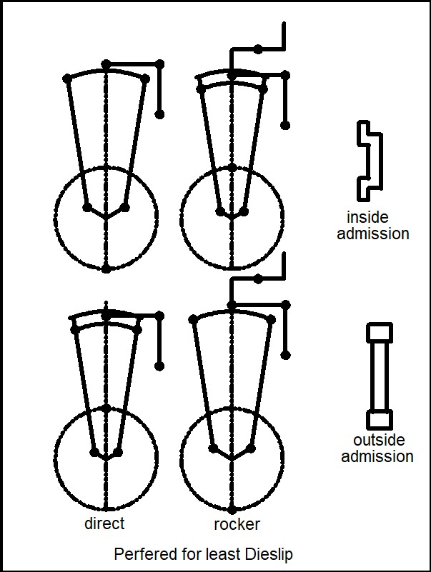

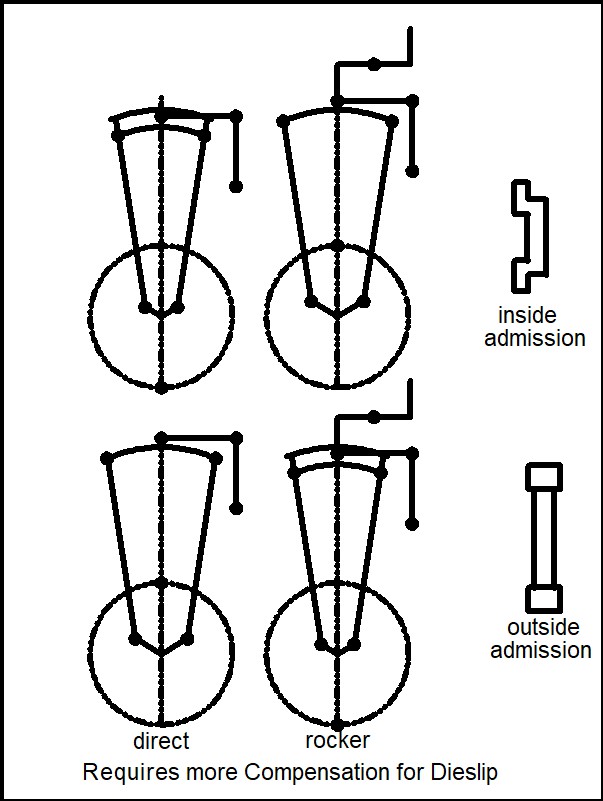

I am working out how to use a Bilgram diagram with a piston valve. It should be simple because the change between piston valves and D slide valves is just flip the eccentrics 180. Now that sounds like that would reverse the engine and that is correct. In order to show a D slide valve and a piston valve using the same Bilgram diagram one is going in one direction and the other is going in the opposite direction.
Chris asked me if Bilgram would predict what happens when the reverse lever is notched back with Stephenson gear. My answer was no it will not. I got long winded and mentioned crossed and open eccentric rods. The difference between open and crossed rods is flipping the eccentric. To read about what happens with this switch read the section in Audels on this subject. Page 322. This is really about Stephenson linkage and we are talking about valves in this thread, but one more factor comes into play and that is direct and indirect Stephenson valve gear. Direct is like a marine engine or a Shay locomotive. Indirect Stephenson uses a rocker shaft like a rod locomotive.
Okay, Blah Blah Blah.... time for the graphics department to the rescue. Here is a drawing lifted almost directly from Don Ashton's book "Stephenson Valve Gear for Model Engineers". The first page is the preferred arrangement for less dieslip with launch and 'locomotive or marine links'. The difference between 'marine or naval' links and locomotive links is locomotive links are made with a flat plate with a radius slot, and marine links are made from a set of curved bars.
This second page is the less preferred arrangements that have more dieslip and require more compensation.
Now to close this by throwing yet another monkey wrench at it.....ALL the drawings are shown with the most common arrangement which is open rods. To change them to crossed rods simply flip the crank pin 180 degrees.
Man I hope that cleared this up. It is all the possibilities of the eccentric orientation for open rods. It is left to the reader to work out what crossing the rods will do to the valve linkage.
Cheers Dan
« Last Edit: April 17, 2022, 01:08:43 AM by Dan Rowe »
ShaylocoDan
  • Posts: 18555
Re: Bilgram's valve diagram a graphical method to design a steam valve
« Reply #22 on: April 17, 2022, 01:20:19 AM »
Um, you show d valve shapes as inside admission and piston as outside, but piston valves can be either with the same shape, just different passages around them... On the Sabino the piston valves are one of each, with the exact same valve shape.
After this thread wraps up, we need to show the double d valves like Marion used with reversing and throttle built in, and are inside admission with outside help... But thats another whole discussion!
Offline Dan Rowe
  • Posts: 1170
  • Dripping Springs TX USA
« Reply #23 on: April 17, 2022, 01:30:59 AM »
Chris yes I know that now but that is the first INSIDE admission piston valve I have ever seen. I have never seen one mentioned in any valve gear book the assumption Don Ashton makes is ALL piston valves are outside admission as he did not label them.
If I had started with the LP valve with outside admission the graphics would be much simpler as it works exactly like a D slide valve.
Cheers Dan

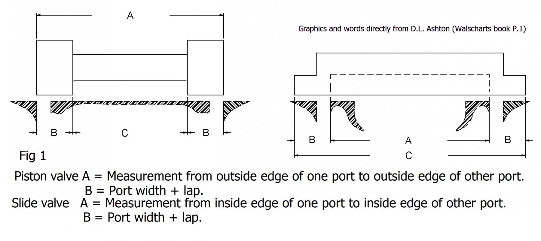

I have to give thanks to Charles for making me open a few of my valve gear books to find out just how wrong my impression that piston valves are just outside admission. I found a lot more information about inside admission piston valves that I could locate about outside admission piston valves.
I have always been laser focused on Stephenson valve gear and I think I should have read a bit widely in the valve gear books I own. A telling case is D.L Ashtons book “Walshchaerts Valve Gear for Model Engineers”. This book is really about both Stephenson and Walschaerts valve gear and the first three pages are for both types of valve gear.
Note that both valves do not have exhaust lap. Ashton states that is is very small in most cases and will not make much difference in a model engine. For the Sabino running on air all bets are off as to cutoff as air expansion is tiny compared to steam which is what the model wil be run on.
Page 2 of the Walschaerts half of the book is describing a 5” gauge loco. Here is a v very helpful quote:
“Since the passageways then to pass a high volume of low pressure steam their proportions should be adequate, (.156 & 0.187) and when they will cope with the exhaust they can more than adequately cope with the small amount of high pressure steam required at inlet.
