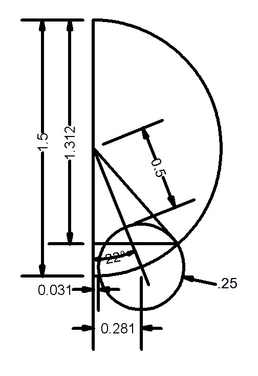

As I mentioned I only used three numbers to calculate the cutoff for the Ripper launch engine.
1) Valve Travel
2) Steam or outside lap
3) Lead or the amount the valve is open at TDC
Most readers will know that TDC stands for top dead center and BDC stands for bottom dead center. This gets rid of the clumsy naming found in a lot of old steam books where the ends of the cylinder are called crank end and head end. A steam engine had a head at both ends. I am mostly interested in vertical engines so I draw valve diagrams with TDC at the top and BDC at the bottom.
Here is the Bilgram I drew to find the angle of advance of the Ripper launch engine.
Cheers Dan

Thanks Dan...I understand the geometry OK , but will be interested as to where some of the missing values are resultants of what?   :Doh:
