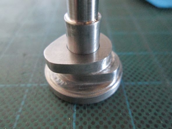

This is a little story about Dum A. Reidskenderian, hot shot cam maker.
Contracted to make a one piece exhaust cam for a little 50 degree V-twin, he first thought about what the angle between the lobes should be. One eighty degrees to account for the 4-stroke cycle, minus a 25 degree offset for the cylinder separation. So 155 degrees, done. He proceed to mill the cam profiles, finishing them off with some ECF work (Eye Controlled Filing).
Putting the new cam pair in place along with the pushrods, it quickly became obvious that Dum A. had overlooked something. With that lobe separation the exhaust valves would open within just a few degrees of each other. Dum A. went to bed that night still trying to figure out what he was missing. Eventually, laying there in bed, his head cleared enough for the screamingly obvious to become obvious.
The pushrods that the cams act upon are not inline with the cylinders, the way he was thinking about it in his simplified mental diagram, but are on opposite sides of the engine on a horizontal plane, 180 degrees apart. And that means the lobe separation should not be 180 – 25 degrees, but simply 25 degrees, the 180 is built into the mechanics.
Dum A. confessed his sin to me and I forgave him, while smugly thinking that I would never make a Silly A. mistake like that... :???:
Luckily there was enough extra thickness in the lobes that I was able to use a parting tool to separate the pair. Then I repositioned them, and soft soldered them and the camshaft all together.
The machining of the cams actually went well, even though the design was flawed. Here are a few process shots.
The cam blank was set-up on the diving head so the part could be rotated to the various angles to mill flats defining the lobe flanks first.
Then the base circle diameter was milled in, up to the lobe flanks.
After blending the profile in with files and wet/dry paper, the part looked pretty good. The cam profile is borrowed/copied from the Upshur Farm Engine. Too bad the separation is wrong!

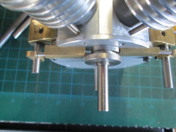

Here it is after repositioning the lobes and soldering the whole mess together; and in place between the pushrods.
The cam gear will be counterbored to fit over that shoulder left outside the cam pair, and will be screwed to it.

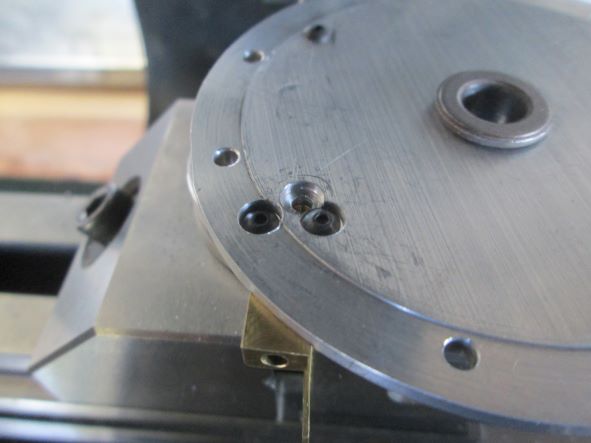

All four valves. One or two flywheels. Cam gear. The gear cover/breaker plate was made today (pic below). Probably some other little stuff I not thinking of right now. And the ancillary stuff like the breaker points assembly, a fuel tank, etc. 80% done, only 80% left to do.

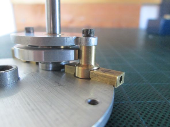

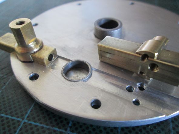

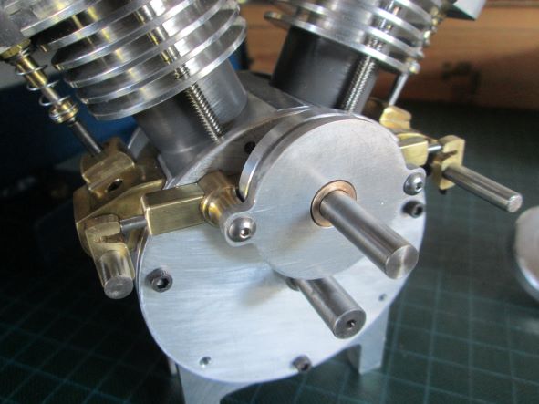

One of the stand-offs mentioned in the last post can be seen in the photo below. Originally these were to be soldered to the top of the pushrod guide/bushings, with a shallow counterbore to locate them. But I wasn't happy with the attachment of the guide shown, using a screw into it from behind. Because that pushrod is very close to the bottom of the guide, there is very little meat left for the screw threads.
So I redesigned the stand-offs to have a base that tightly drapes over the guide/bushings. Those then got two 2-56 screws from the back of the plate which fix both the stand-offs and guides. The original screw holes are no longer needed and won't be used.
And finally, a couple of pics show the completed assembly, and a short video of the valve train being exercised with a hand crank. (Yes, the rocker shafts do still need to be trimmed to length).

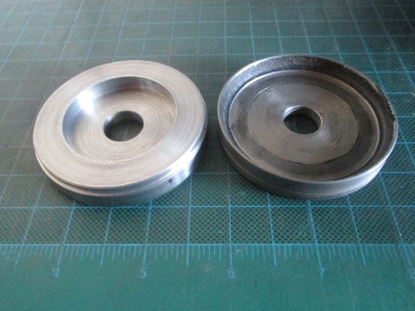

Return of the Fly (wheel).
Back in Reply #160 I discussed making a flywheel from a discarded cast iron dolly wheel that I wasn't too satisfied with. Having ordered and received a couple of mild steel "hockey pucks", I made a new, improved flywheel today. The 1st try weighed in at 111 grams, this one is 187 grams, better than a 68% improvement. :ThumbsUp:
The first picture shows the starting point of each. The second shows the finished parts. Not only is steel heavier than cast iron of the same size (higher density), you can see that the steel version has much more material out towards the rim, where it does the most good. The step in the OD is needed to clear the bottom of the pistons at BDC. It took a little while to figure out why it was locking up solid at that point! :headscratch: It wasn't much contact, and it wasn't easy to see, but at least it was easy to fix. :ShakeHead:
