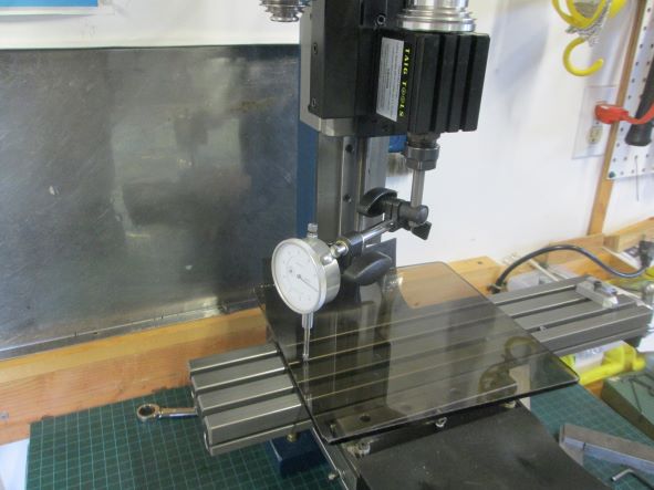

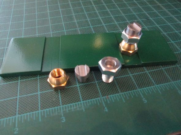

Before starting work with the milling machine, I thought it would be a good time to check the tram. Here's my set-up. The piece of glass serves as a surface plate.
I made what I call “tramming jacks” not long after getting the mill, which are little more than a pair of machine screws and nuts. Since the Taig has one of those columns that pivots on a single large bolt, they really help in getting it set, as well as add extra support at all times. The nuts rest in a groove in the green base plate so they don't rotate. The screw heads are counter-bored to take little steel pads that are free to rotate in the bore and slotted at the top to fit the wall of the column tube. Then the screw can be turned with a wrench to raise or lower either side as needed. You can see one in under the column in the phote, near the end of the wrench. They work well, but happily very little adjustment was needed.

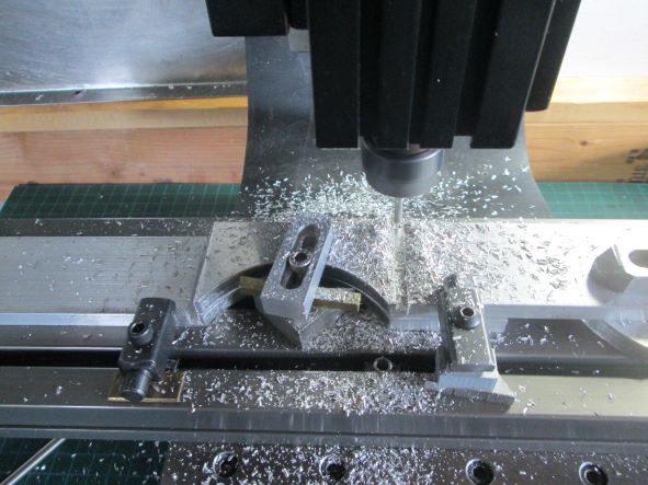

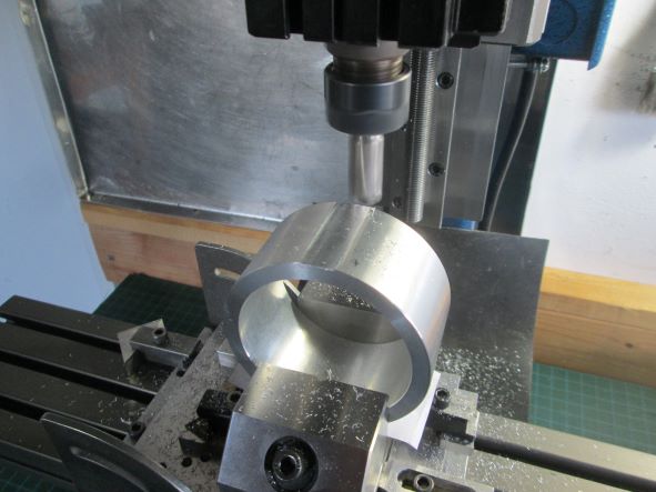

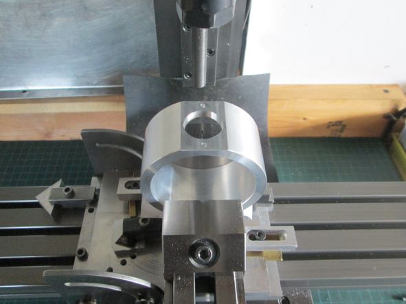

With that done, I set up to mill the cylinder landing flats in the crankcase. The first one is the easy one, it can be held in the vise flat on the table. I have the vise mounted to the tilting table though, so that I can roll it up through 50 degrees to do the second one.
Once the flat was finished I bored the hole the cylinder will plug into, and drilled for two 6-32 fixing screws.
Once I rotate it up for the second flat, I'll have just enough Z height left to mill the flat, but not to do any drilling or boring. That should be OK, since the flat will be there to key off of. I'll just reset the vice with that plane horizontal.

Ron,
Thanks for the tramming jacks tip.  My CNC mill is a Taig.  The jacks will work much better than tapping on the column to make adjustments.

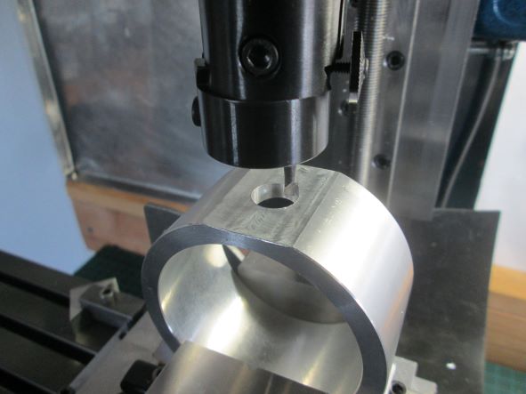

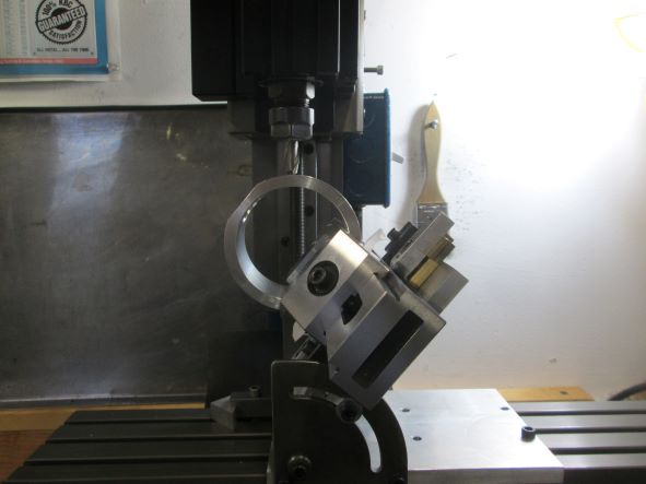

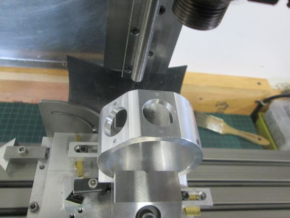

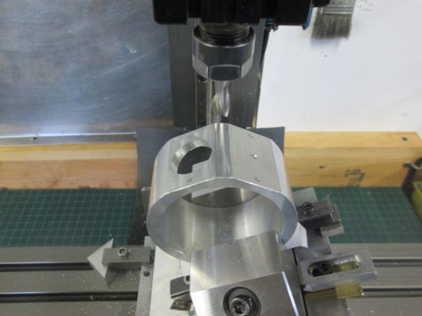

Here's the set-up for milling the second cylinder flat. In this view the mill head is virtually at the top of the column. Enough room left to do the job and even a bit of extra.
Contrary to what I said in the previous post, I was also able to pilot drill for the center hole and tap drill for the two cylinder mounting screws.
With that done I rolled it down to 25 degrees and milled a flat between the cylinders. This is not really necessary, but I drew it that way and it may come in handy later as a reference plane for orientation, such as when attaching the “legs”.
Lastly, I dropped the tilting table back down flat and re-set the part in the vice so the flat was horizontal  and perpendicular to the column. I did this both with a square, as shown, and by rotating the boring head (backwards) by hand with it just touching the surface, to ensure that it contacted evenly all the way around. Then I finished drilling and boring the center hole.

That's a nice setup to get the angles correct :ThumbsUp:  :ThumbsUp:  :wine1: I guess you found enough headroom for the second cylinder mount by holding the drill in the collet rather than using a drill chuck.
  • Posts: 1699
Re: The "2-Bits" V-Twin
« Reply #23 on: March 06, 2022, 03:00:35 PM »
Thank you, Roger!
Yes, holding the drills in a collet was the only way. Changing the drill bits without moving the table away was a close thing, even with the stubby drills I prefer. Of course center drilling was easy enough, the tool being so short, so I knew I'd be able to at least do that.

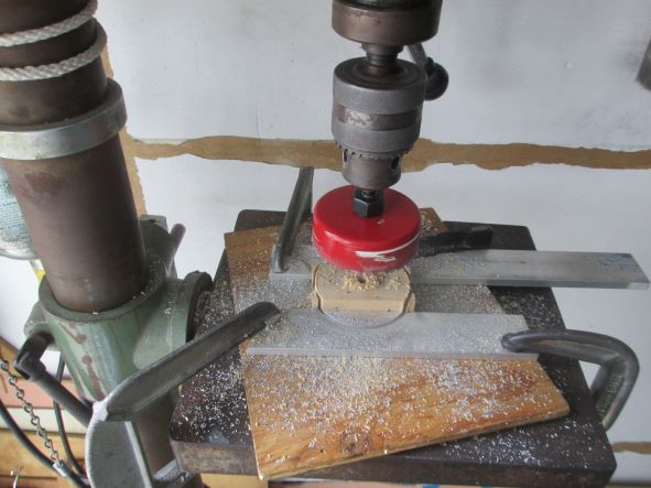

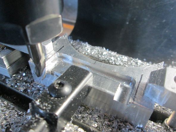

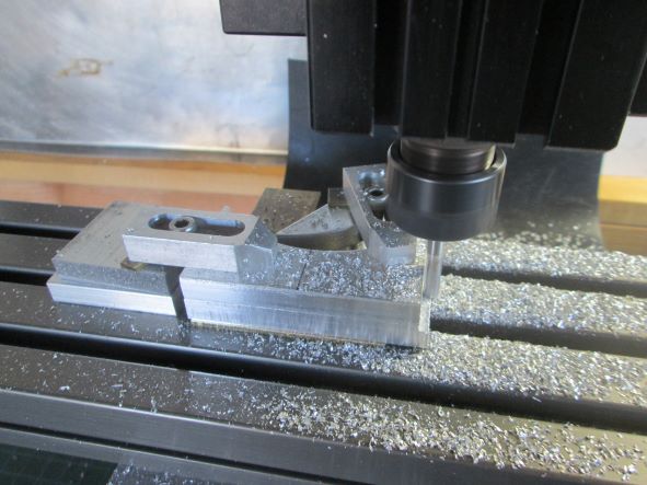

In order to keep the crankcase from rolling around like one of these guys  :ROFL: a base/pedestal/standards/legs/whatever is needed. I'd drawn a kind of saddle arrangement with a pair of bars cut to match the curve of the crankcase at the top with integral legs extending down from that.

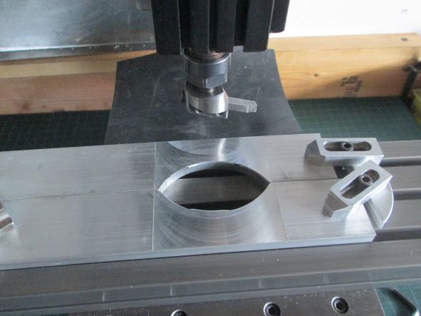

To cut that 1.5” radius curve, I considered several possible methods, including bolting the bar stock to the face plate on the lathe, or using the flycutter on the mill as a boring tool. But when I realized that I have a 3” OD hole saw, I decided to take that approach a second time. It would only need to go through 5/16” bar, so much easier than the crankcase job. I left the bar stock plenty long to make clamping easier.
That turned out well, so next I went to the mill to take a light flycut across one surface and cut the pieces free from the bar stock, still leaving some extra to trim in the next step.
Now the two parts were stacked with the arcs concentric, the edges were trimmed square and to size and the legs were cut in.
The finished articles are screwed to the crankcase from below with a pair of 4-40 button head screws each.

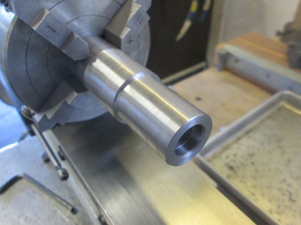

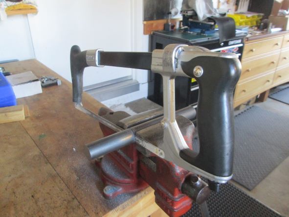

This afternoon I made a start on the first of the cylinder sleeves, for a change of pace after all the aluminum work on the crankcase. The sleeves are 12L14 steel and I borrowed the basic design from the Upshur engine with only minor changes in dimensions to suit this engine.
After cutting off a 3" long blank, I drilled the center out to 1/2" on the drill press, then chucked it up in the lathe to turn the "upper" OD. An aluminum cylinder block with all the fins and the exhaust valve housing will slip down over this portion.
Then I set up the steady and bored the cylinder. The nominal bore is 0.75", but I was happy with the finish at 0.748" so left it there. The pistons will be turned to fit, so the finish is more important to me than the last ooonnch of precision around a fairly arbitrary number!
I finished by reversing the part end for end in the chuck and getting it all dialed back in. Tomorrow I'll turn the short section that plugs into the crankcase and finish it off to length. Then do it all over again for the second cylinder.

Sawing off the blank for the second cylinder sleeve. Otherwise known as the MEM Upper Body Workout.
