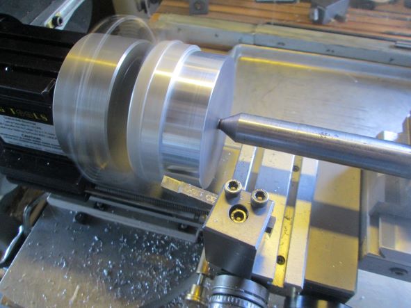

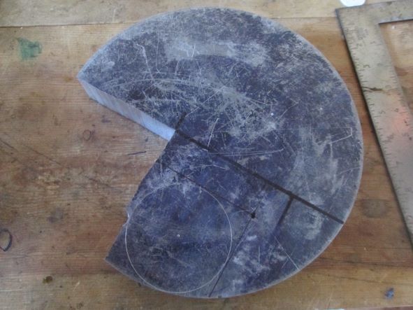

I commenced cutting metal for the crankcase this morning. My original intention had been to make the main body of the case from a piece of heavy wall brass tubing (3” OD, 0.25” wall), but at around $50 for a two inch piece of material I had second thoughts. The same size piece in aluminum would only be a few bucks and good second option, not least because the Curtiss engine did use an aluminum crankcase.
Then I considered those chunks of ali I brought home from Tx that have been a source of material for a few parts in other projects already. The larger one is 1.5” thick, which is just what I need. That's the “Pac-Man” in the first image below. And I have an almost unused (therefore sharp, hopefully) 2.125” OD x 1.75” deep hole saw. If I can get all the way through with that, then there will just a relatively small amount left to bore.

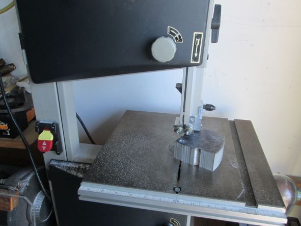

So I got to work cutting out a blank on the bandsaw. That poor thing must have been thinking “this isn't in my contract”, but it got the job done.
Then I mounted it in the 4-jaw to start turning one end to near size.

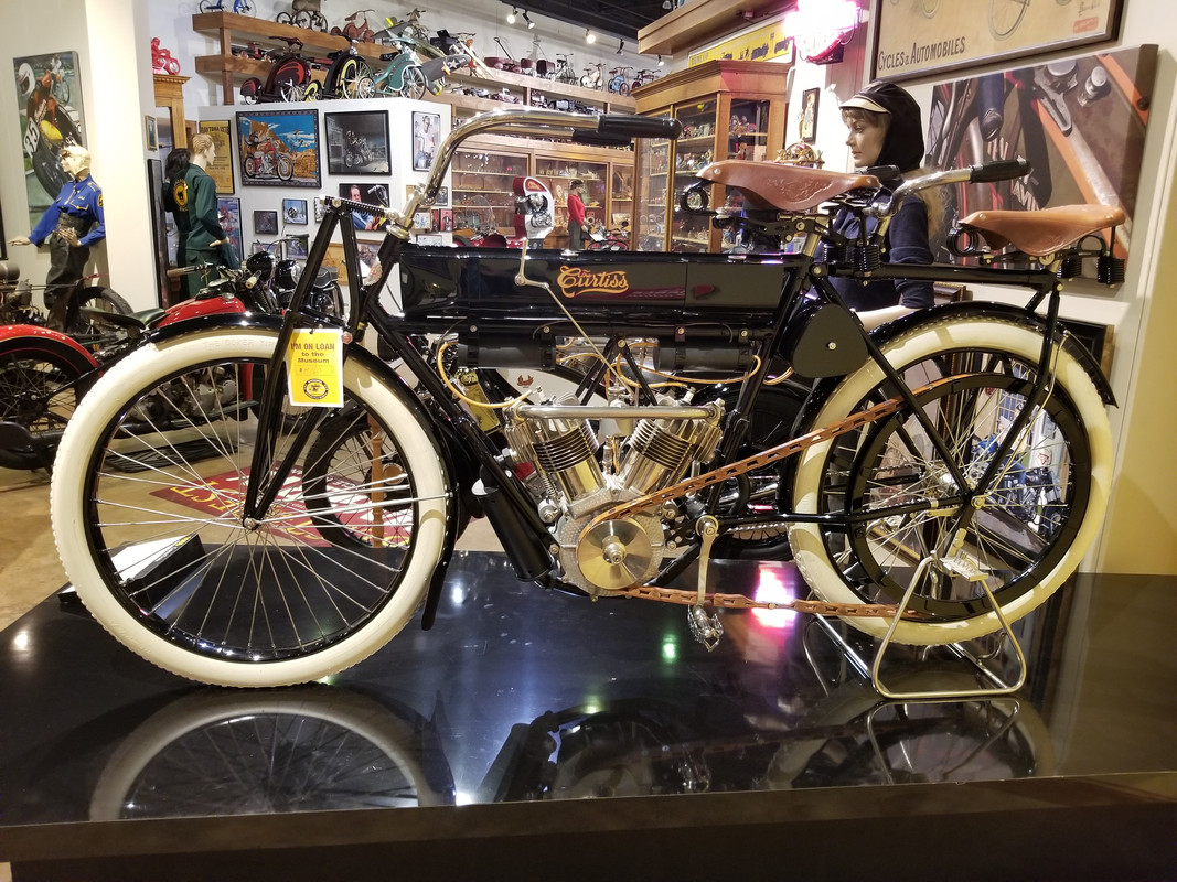

For our anniversary in Oct. 2018 we visited to the National Motorcycle Museum in Anamosa, Iowa. This was on display. It is a 1906 Curtis.
I personally am partial to the 27 Brough Superior but have no idea how to find enough info to build one, even if I didn't have 3 or so engines on the list to work on first.

Art - Apparently that rear seat w/ handlebars the bike in your photo from the museum has was an extra cost option!

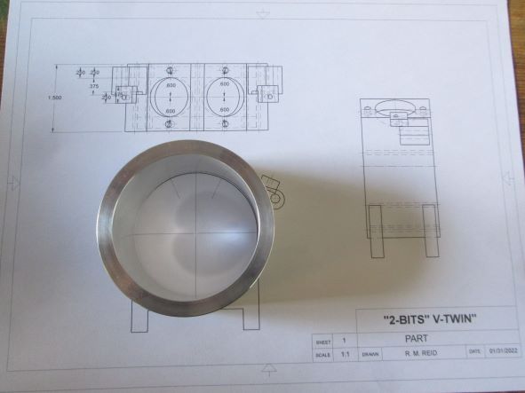

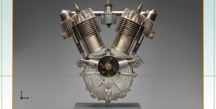

Hugh - I've put in a couple of drawings below with some of the other parts hidden or made wireframe, so as to shown the valves, cams, and rocker arrangement more clearly. For the front cylinder I've colored the intake valve green, the exhaust valve red. The intake is an atmospheric valve (pulled open by low pressure in the cylinder on the intake stroke), so is not driven from a cam.
Roger - That's correct, there is a cam for each exhaust valve. The lobes are just arbitrarily set at 90 degrees apart on the drawing.

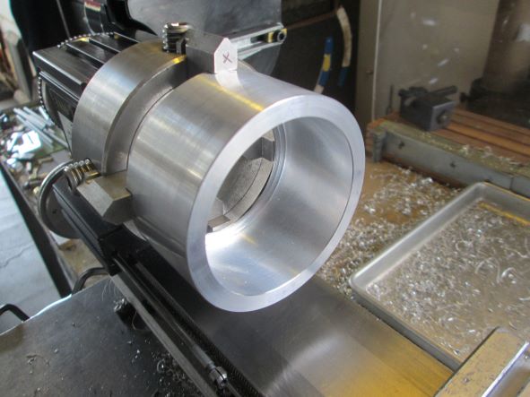

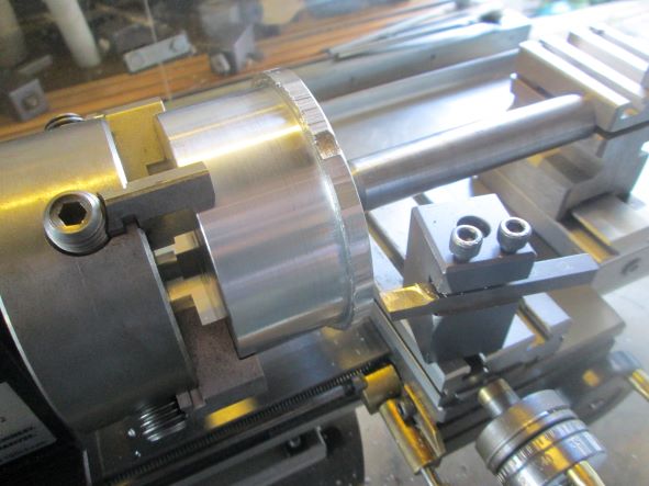

In the last installment, I was turning the OD of the crankcase blank. To finish that I had to turn it around so as to turn off the bit that had been in the chuck jaws.

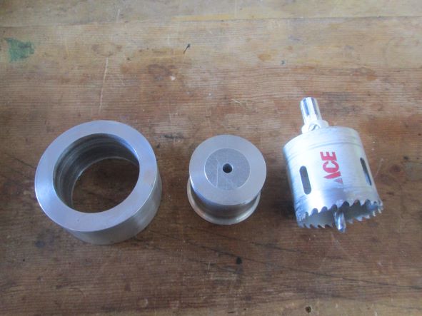

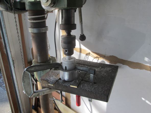

Then it was time to find out if a run of the mill hardware store hole saw, and my tired old drill press, would be up to the task of chewing through 1.5” of aluminum. Here we are about ˝ way through. So far so good.
And the answer is yes, it will work. Not quickly, not quickly at all, but it got there. I might have gone faster, but I couldn't bear down too hard without slipping the belts on the drill press. That's fine though, given that the clamping arrangement was a little marginal. Better the belts slip than the part!
Then it was back onto the lathe to bring the ID to size. Again I would have to turn it around to finish the last little bit because it was up against the jaws. You can see that bit in this image.
And done. Easier than buying a piece of heavy wall tubing? Heck no! Worth it? I don't regret doing it the hard way this time and I'm happy with the result, so sure. I just hope I don't mess up and have to do it again!

Very nice length of pipe you made there, Ron!  And you have the core to use in some future project to boot!   :popcorn: :popcorn:
