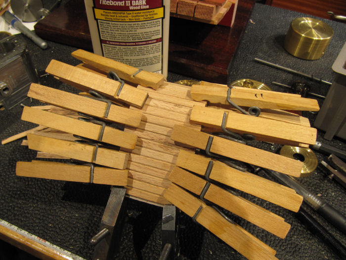

Got the length figured out for the cladding boards, and cut a stack of them down to size on the table saw (one of the little MicroMark ones). Have started glueing them onto the wood backer for the LP end.
Going to work my way around the length of that backer, and then can transfer the starting position for the boards on the HP end so that there is a smooth transition. There may well be a couple of narrower ones needed on the back side where the two ends come together, but I want the front side boards all to be the same width.
After all are on and the holes for the pipes made, I'll give it a coat of the stain and then varnish. With glue-drying time, this will be a slow process.  More time to sit outside and read!   :happyreader:

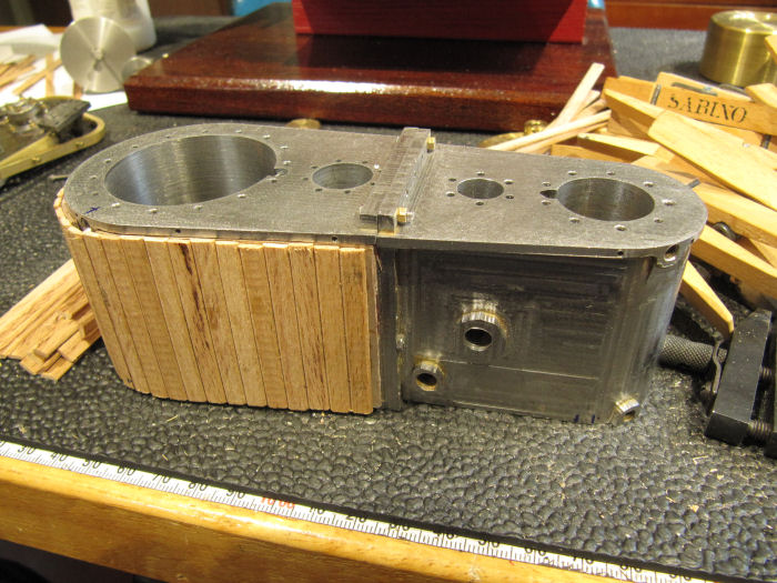

After a nice lunch out with friends, the LP cladding had set up enough to remove the clamps and spring it into place on the cylinder block. Marked out where the holes for pipes are, will open them up tomorrow after the glue has fully set, using a rotary tool.
 :Lol: Just noticed in the background of that photo, a clothespin with 'Sabino' on it. That was a test many many years ago of the rub-on letters used on the RC model of the ship! Wow, still have that pin!
Have gotten the location marked for the start of the strips on the HP end, and the first batch of boards are glued/clamped in place on it....

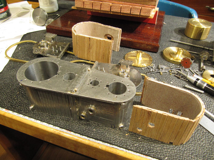

The glue was nicely cured up by this morning, so got the holes opened up for the pipes. Here are all the pieces:
and put together to test fit:
So, I think its ready for finishing. Did some more color tests on leftover pieces of the cladding strips, and decided not to use the stain, just the varnish, which gives it enough color by itself. So, will start coating the wood pieces, and can start getting the cylinder blocks assembled and painted. Or painted then assembled. Hmmm...  The joint between the two blocks and between them and the base plate will get a thin layer of gasket maker goop from a tube, goes on nice and thin and is still removeable if need be, and does not require as close a spacing of screws as a sheet gasket typically does. The cylinder head caps will be sheet gaskets.
