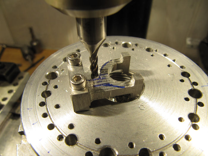

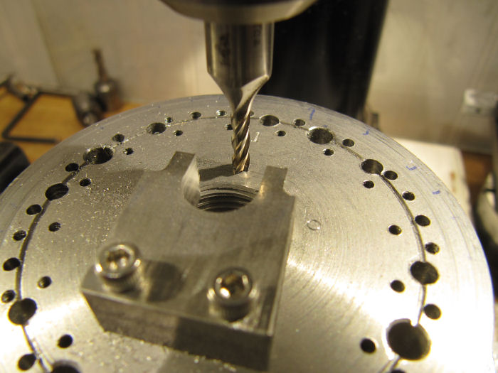

Next step on the yokes was to open up the round hole to the end wall:
Then took passes on each side to thin down the lower portions of each one:
The thick section where the two screws are will be trimmed off later. Next will start shaping the profile of the middle section, taking down the curved portioon to where it transitions to the single post out the bottom end....

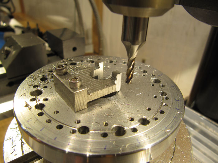

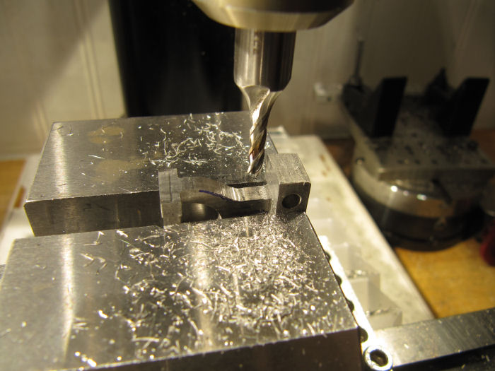

Using the rotary table/faceplate setup again, started nibbling out the loser sections of the yokes...
then squaring up the inside corners at the base - they will be cut off from the larger block with the screw holes later
leaving a nice selection of Y's for the scrabble board...
Almost done with these parts - still remaining is to drill the holes in the ends of the little posts at the top that will hold the bearing blocks, trimming off the base blocks, and drilling holes in the stems at the bottom to attach the eccentric arms with. Also some filing/sanding to clean up the tool marks left by the end mill.

From appearances it seems your rotary plate has 3 sets of threaded holes at different distances from the center.  I'd guess you start with stock that matches the set of holes to be used.
Re: The Sabino Compound Engine
« Reply #655 on: May 14, 2022, 12:14:57 PM »
Hi Kvom,
The faceplate started with one set of holes, and I have been drilling holes as needed to match the parts  being worked on, so far different cylinders. These faceplates are steel and bought from Penn Industries, they were made for woodturning lathes but have the same thread as the Sherline. Just needed to shorten the unthreaded end of the back post. Much cheaper and stronger than the aluminum ones Sherline sells, cheap enough to drill holes as needed, and toss if they get too Swiss cheesed, they make handy tooling plates. The Sherline rotary table has a handy adapter for the center hole with same thread as the lathe headstock.

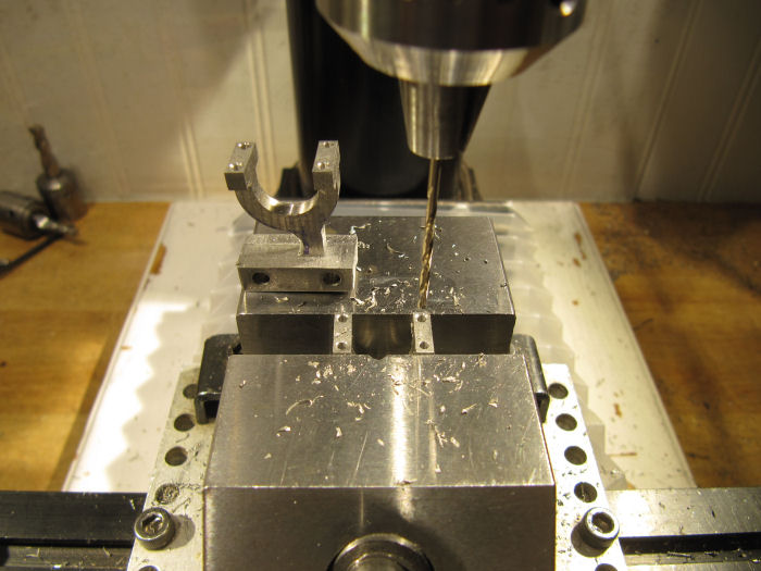

Got the holes for 1-72 screws drilled in the top of the yokes
Then cut off the blocks on the bottom and did some filing/sanding to smooth off the milling marks
Need to get the holes tapped, and drill the holes in the bottom of the stems to take the top ends of the eccentric rods. Then can either make the bearing blocks for the tops, or make the rods, whichever wins the 'what do I feel like making next' contest.
