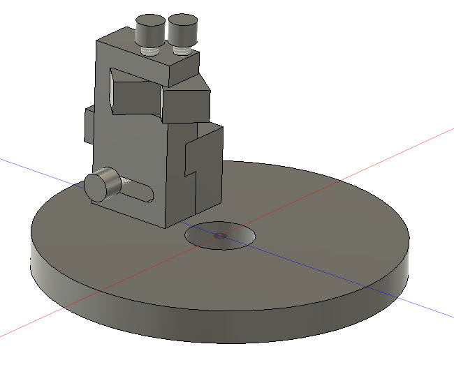

While waiting for the parts to show up in the mail (from tracking it looks like they have actually made it here to Rochester on time!) I took the time to make up something that I've wanted for a years but never got around to - a radius turning tool. Sherline makes one for their lathe, but I never really liked the look of the design, and I have also seen posts online of people who have used a boring head to make one, though the cutter geometry is a bit odd in that configuration. Wanting something that could use the same insert cutters that I use, I had the idea of rigging up a holder on the vertical rotary table on the mill.
Using the mill has the advantage of adjustability for the cutter position in each axis, and using the rotary table would allow nice smooth feeds around the arc rather than having to hand-hold/move a lever attached to the cutter head like most radius tools do. So, took a little time and drew up this in Fusion - the large disc represents a faceplate that would be attached to the center post on the rotary table, and the angled chunk represents the cut-off end of an indexable lathe tool (had some extras of those). The hieght of the tool holder is to allow the lathe chuck holding the part to clear the faceplate - wanted to be able to turn very small ball ends/arcs so the cutter has to be able to reach in close to the centerline of the chuck.
I made up the pieces from some 303 stainless bar stock left over on the shelf. One block is bolted from underneath to the faceplate, and has a notch taken out of the side to form a rail. The other block has a channel cut in it to fit over that rail and keep it from twisting, the other end has a 45 degree channel to hold the lathe tool. The slot in the bottom of the holder allows the holder to slide in and out to adjust the radius to be cut.

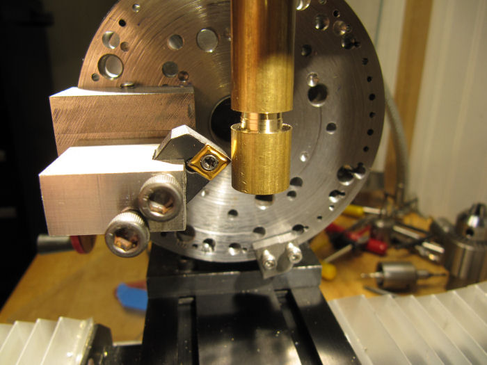

Then came the first trial run. I took a piece of 1/2" round bar, and used a parting tool to make a notch 1/2" from the end to give the cutter clearance to come around the center and keep going. The piece was chucked up on the mill, ready to line up the tool. First needed to adjust the height of the part and the position of the cutter - took a little back and forth adjusting. With the rotary table cranked around to put the cutter at the bottom, the mill table was moved to put the cutter on the center of the part, that should align the center of the rotary table with the center of the mill head.
Then backed the mill table off to the left so I could crank the rotary table 90 degrees to put the cutter up to the midpoint, moved the table back over to the right to put the cutter on the center of the part, and made two adjustments - moved the mill head up/down the column to put the center of the future ball on the center of the cutter, and moved the cutter in/out (by loosening the screw in that slot in the bottom of the holder) till it just touched the part.

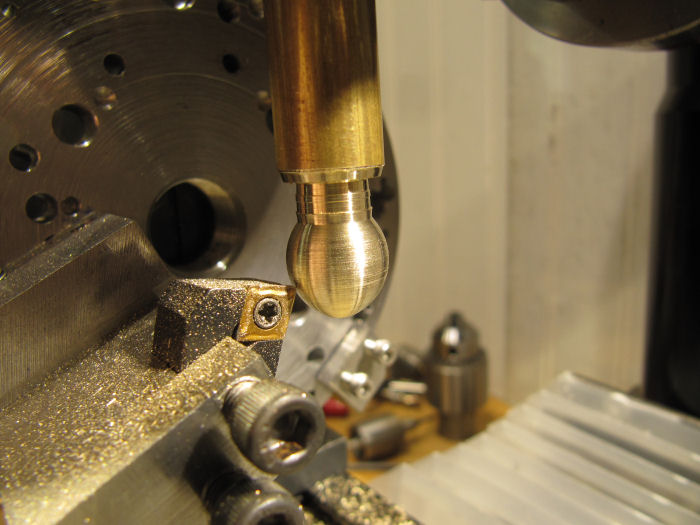

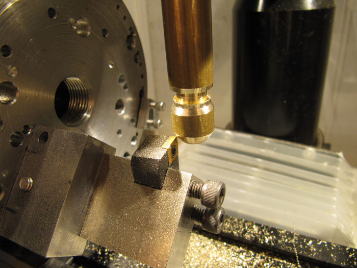

Now, if I had made the tool holder with a screw adjustment for in/out like a boring head has, I could have started with the cutter farther out for the first few passes and gradually moved it in. Instead I started out with the mill table moved over to the left, started the motor, and slowly brought the mill table back to centerline while moving the rotary table through the arc - this knocked off the corners of the part and started to round it. Not ideal geometry for the cutter, but for soft brass it worked fine. For steel, on a large diameter, it would make sense to either do passes with the cutter moved out farther, or take off some of the excess on the lathe first. Here it is after the first couple of passes, moving the table a little to the right, making a pass with the rotary table, repeat...
and after getting all the way to centerline:

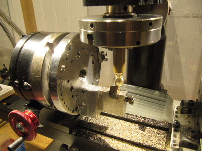

It took a few attempts, adjusting the cutter position and part height, the first attempts I had the tip of the cutter too far out, but got a decent result eventually. I like being able to make a slow even rotation through the arc with the cutter, gives a smoother finish than the ones I've watched videos of where the cutter was moved by hand with a long handle. Here is a wider shot of the setup:

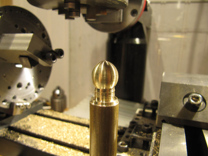

and the ball end it produced
Overall pretty happy with how it works. One thing this setup doesn't allow for is to do a radius in the middle of a longer bar with the end supported, like could be done on the lathe with the tailstock. Also, to come around onto the shaft next to the ball does require the part to stick out from the chuck a little ways, but thats true of most radius cutters.
