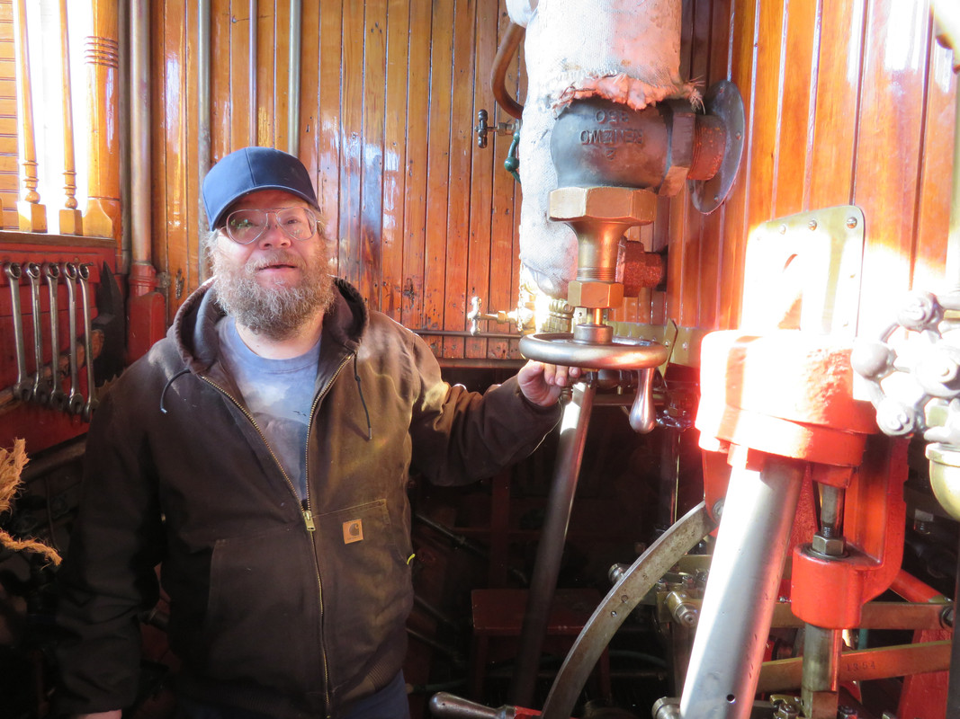

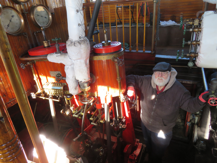

It was this past fall that Ron Ginger (who I got to know from this forum after he posted pictures of the Lombard log hauler up in Maine, which I eventually got to measure and build a model of) and I were talking, and he started doing some digging since he was also interested in modelling that engine. Ron was able to get just the right person on the phone at the museum, and arranged for us to get access to the ship to spend the day measuring the engine. More great fun, to finally see the engine up close from all angles rather than just looking down from the gallery around it. So, that day Ron
and I
spent the day crawling around the engine room with tape measures, rulers, calipers, protractors, and cameras getting all the detailed measurements plus close up pictures of all the pieces. Around that time I was also in contact with 'Steamer' Dave from this forum, who was the engineer on the Sabino for years - lots of great information from him on how the engine worked and was run, plus he got me some photos and drawings by Greg Young, another engineer there back in the day, who had build a truly amazing model of the engine that had a unique feature, the front of the engine block was removeable to show the inner passages.

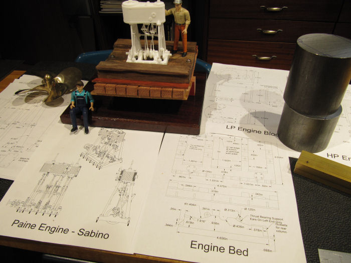

Using all those photos and measurements, this past winter I drew the engine up in Fusion 360, creating a CAD version from which I made a set of prints with full size measurements and also a version scaled down to 1:8 size for a model. Here is a render of the CAD model:
A copy of the full size plans went to the museum for their collection, and for reference I had a smaller scale (smaller than the 1:8 size) version 3D printed:
With the other recent projects all complete, its now time to finally get to work on the Sabino engine! I would have started it this past week, but when gathering up the bar stock I realized that the 5/8" thick bars I was planning to use on the engine bed were actually 1/2" thick....   :zap:    :wallbang:   So, the proper thickness bars are out for delivery today, I'll get them stress relieved in the oven this afternoon and can start making swarf after that.   :whoohoo:
In the meantime, the last couple days I decided to make the display base for the engine as a section of the ships hull. After digging out the plans for the ship from the pile, er, um, careful stack, I spent some time with the table saw, band saw, and glue, making up this base:
I already had picked up a 12" long bar of 1144 stressproof steel, from which a couple blanks for the engine blocks were cut. The engine block on this engine is an interesting setup - it is made from two pieces, joined in the middle between the valves with bolted flanges around the edges of the joint. The valves are spool valves, with the HP valve an inside admission, and the LP valve an outside admission arrangement. The two blocks can be gotten out of a 3.5" diameter round bar, and with the tapered shape of the blocks the stressproof steel seemed like a good choice. Plus, lots cheaper than brass these days, especially when I found a place that had the 12" bar as a cut-off drop at a low price.
On the left of the photo you can just see another great find - a 4-blade prop just the right size that I was able to get from the Prop Shop over in England, which specializes in scale props for RC models. They happened to have this one already cast in stock, and they drilled/tapped the hub for me as well. I may attach it to the engine as a (fairly dangerous) flywheel, or just have it sitting next to the model. It is the correct size/pitch for the model - its amazing how much power a small steam engine has to turn a large prop. The 3D printed model is sitting on top of the base in the photo, it is a lot smaller than the metal model will be.
