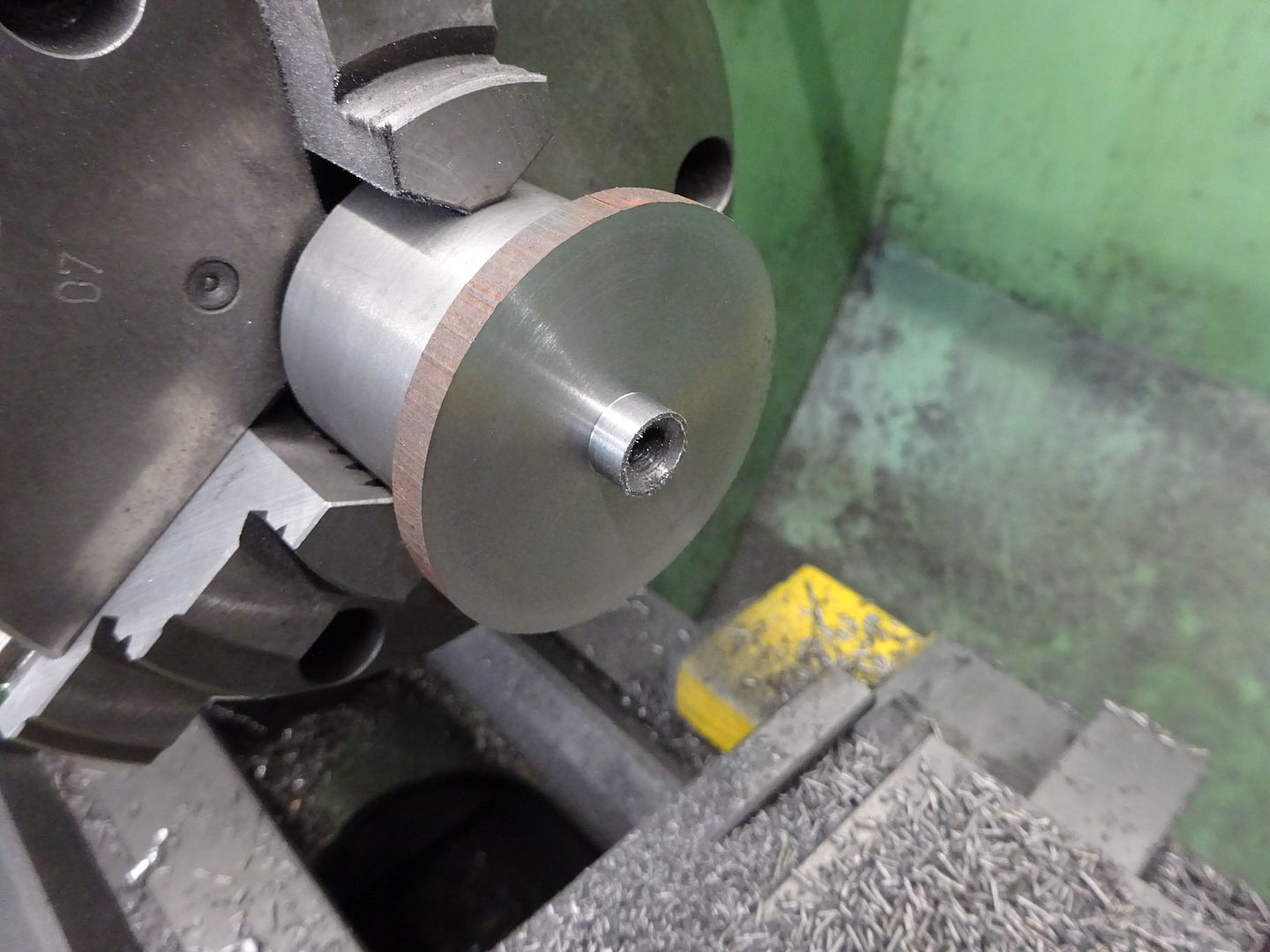

Willy, the original was cast as part of the entablature/front cover in gun metal.
I mabe my guide from 12mm steel boring and then reaming a 10mm hole right through and then milling the slots.
I then turned a spigot on the end of some CI bar using the guide as a gauge to get a firm push fit, after shaping the entablature and parting it off over thickness the two were loctited together.
To ensure the trunk guide was perpendicular to the cylinder mounting surface I then held the assembly in a collet and finished the face and cylinder location spigot to thickness
It could have been done from a single length of steel, CI  or even GM bar bar but that seemed a bit wasteful of material and would have needed a long series milling cutter for the guide slots. I did use the CNC to shape and drill the entablature but easy enough to do on a manual mill as it is just a case of milling the basic "H" shape, drilling a few holes and then rounding the 4 corners which could be done on a rotary table or with filing buttons.
