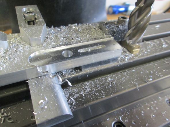

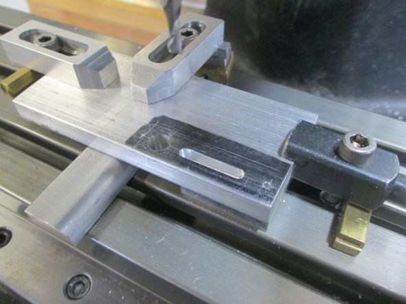

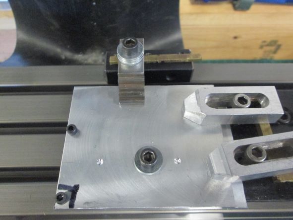

After all the work cutting the fins on the displacer cylinder, I moved on to the displacer connecting rod for a nice change of pace. Unlike the cylinder, this is a fairly small piece, but like it a number of steps were involved.
Work commenced with drilling the big and little end crank pin holes. While I was set up I also cut in the 1/8” slot that “decorates” the web. Then it was taken down to the specified major width.
The following steps were much simplified by making the simple mounting fixture shown here. After cutting the part free from the stock, the “scrap” was used to make the fixture. This allowed me to easily clamp or screw the part to the table or the face plate. The pins keep it aligned and allow for easily flipping it over to work on opposite sides.
The fixture was mounted to the mill table at a small angle (~2 degrees) for cutting the tapering shape of the sides of the web. It was a simple matter to just flip the part on the fixture to cut the same angle on the other side.
With that done, the fixture was mounted to an angle plate so the web between the big and little ends could be thinned down. I must have either staged the picture below “post-production” or there is a strange parallax effect in the photo, since the angle plate seems to not be aligned with the table very well! In any case, I know it was set-up properly when the cuts were made.
Now the fixture got screwed to the face plate and mounted on the lathe, where a big end boss (Big Boss?) outboard of the web was turned.

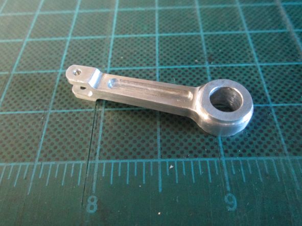

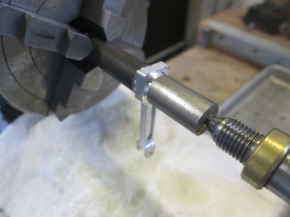

Two sets of filing buttons were made up for the final rounding of both the big and little ends. I just realized that I didn't take any photos at all of the work done at the little end (sorry, little end).
And the finished connecting rod.

The next parts I tackled are the Bearing Standards. After fly-cutting two plates of 1/8” aluminum to 0.94”, they were fastened together so as to be machined as a pair.
The standards get three holes drilled into the face. The lower two are decorative only, while the upper one carries the ball bearings for the crank. See the center-dimple to the right of the SHCS? It wasn't until I had already drilled and “reamed” (using a 3/8” end mill) the bearing hole, that I realized it was in the wrong place! It is meant to be 2.61” from the baseline at the left. To avoid possible counting confustion when cranking that far, I like to do the big round number first, then do the additional smaller amount. This time I duly cranked 40 turns to get to 2” and proceeded to make the hole. Completely spaced out on the  0.61” bit. DUH!  :facepalm:
Fortunately for me, I was able to start over without moving the piece by working “top down” instead of  “bottom up”. The larger, lower, decorative hole just swallowed up my mistake. The only visible evidence is the other center-dimple, and that will be hidden by the crank. Whew!
With that disaster averted, I used the same fixture as before, but with a bushing over the pin to fit the bearing hole, to cut the angled sides.

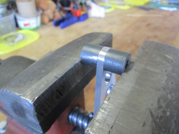

And another set of filing buttons (I found this pair ready for use in the junk drawer) to round off the end.

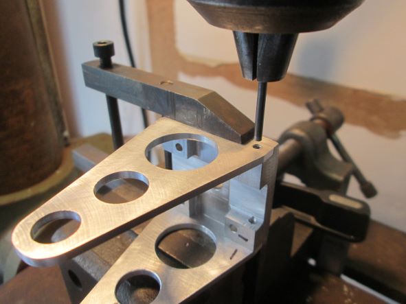

Finally, the two pieces were separated, and the tapped 4-40 holes used to screw them together at the lower edge were then used to match drill the Displacer Head. I like to use the shank of the tightest fitting drill that will go in for lining up jobs like this. In this case the #43 tap drill does the trick.
