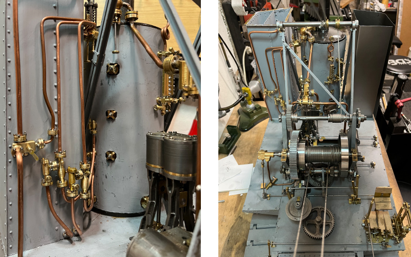

Recently I was working on boiler fittings. As I use compressed air the boiler is only used to hide the air connection, fittings have no function. The main steam valve on top of the boiler is not operational and always open. Now the injectors are completed.
The steam pump on the left in front of the water tank is the ejector for filling the tank. The two injectors pumped water into the boiler. The picture on the right shows a view from the boom. The container on the left is separated into water tank and a space for ballast. The not yet completed container to the right of the boiler was storage for coal and ballast.
Kind regards, Horst

Wonderful work!
On the left side of the picture, it looks like there is a steam line on the end of the main winch drum shaft - is this for a steam-operated clutch to engage the drum? The early-1900's Marion shovels used a mechanism like that to operate a small piston, mounted on and rotating with the drum, that tightened a clutch band.
Also, does the smaller gear that is on left end of the shaft above the drum move side to side to engage the larger gear under it?
Watching along, and thanks for taking the time to post the translations from here out!
Hello Chris,
The answer to both questions is ‚yes‘. The steam operated clutch is similar to the one on the Marion engine.
The gearwheel will be shifted by a lever mounted under the roof next to the operator‘s seat. It is used for lifting the boom. The boom is held in it‘s position only by the non-reverse ratchet on the right end of the shaft. I could hardly believe this when I first saw it on the original engine.
Horst
