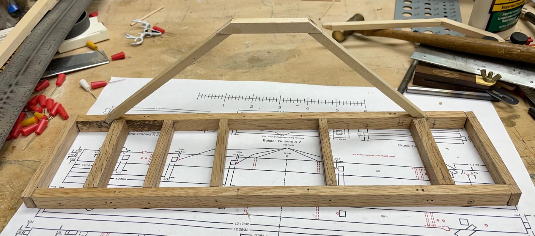

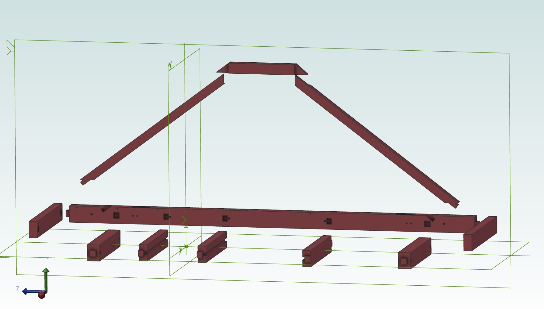

This will be the first Shay that I will be using 3D for the whole project. I am still using 2D as I know the program I use really well and I know how to get the line weights set to make the drawing look good in print.
Here are the wood frame parts are shown exploded to show the wood construction details.
Here is the model frame in Bob's workshop.
Cheers Bob and Dan

Great start on the free range steel (aka wood) parts!

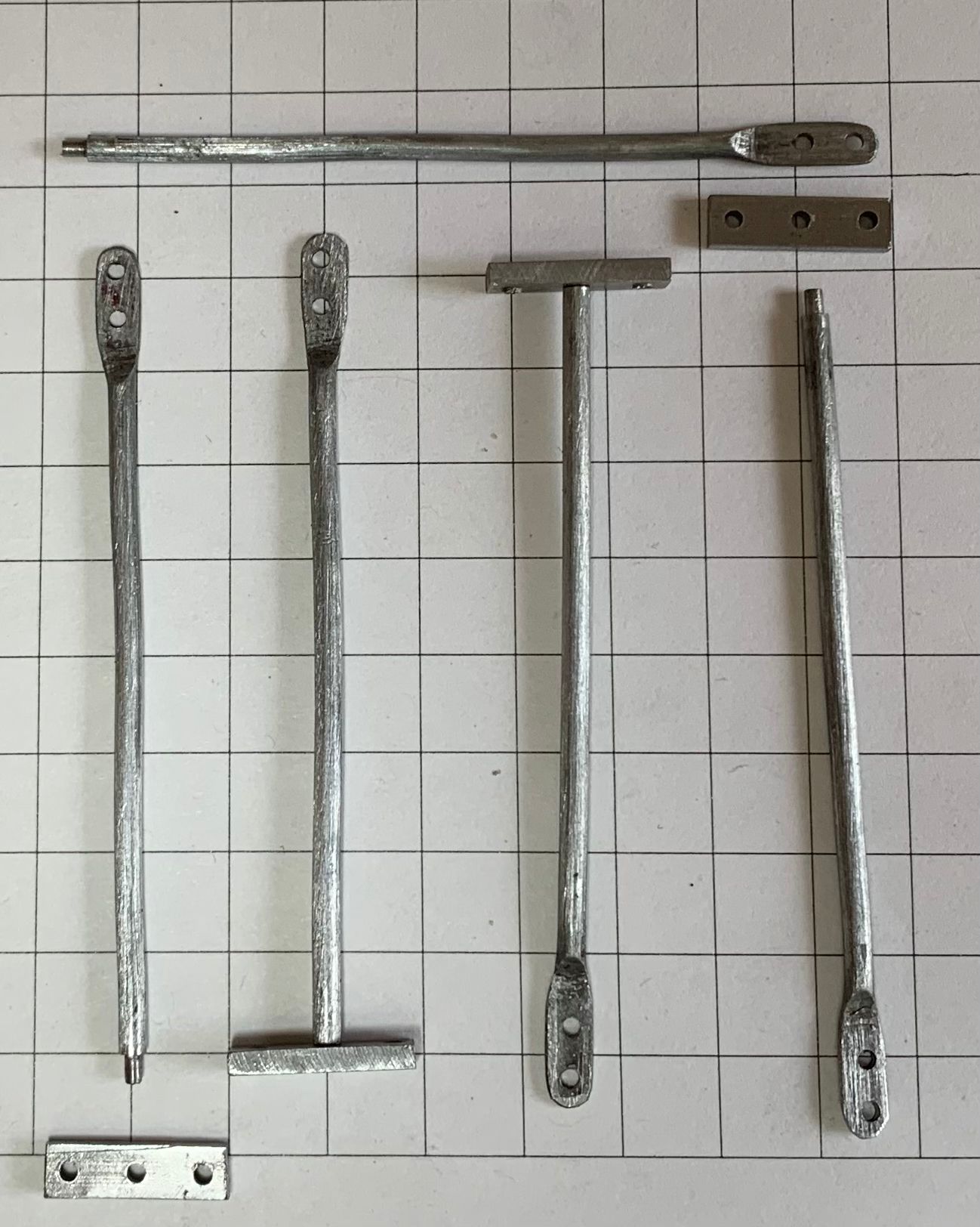

Dan......in reply message #8 [29/11]  shows another pair of 'steel?' structural rods....were these adjustable so as to act in tension?
Derek
Offline Dan Rowe
  • Posts: 1170
  • Dripping Springs TX USA
Re: S/N 10 Shay
« Reply #20 on: December 02, 2021, 03:51:14 AM »
Derek, yes those are steel truss rods which is a standard Shay feature. The rod that ends at the frame is really a U shape that has both ends attached to a flange with 3 holes just below the frame. The center hole has a single rod that bends at the queen post and attaches to the other U rod wrapped around the other end of the frame.
This assembly is adjustable and will add to the bend in the middle of the frame. Early steel I beam frames had a similar detail. Later steel I beam frames have 5 separate rods per side, not the U system.
This will be a working assembly on the model so details will be covered in this thread.
Cheers Dan

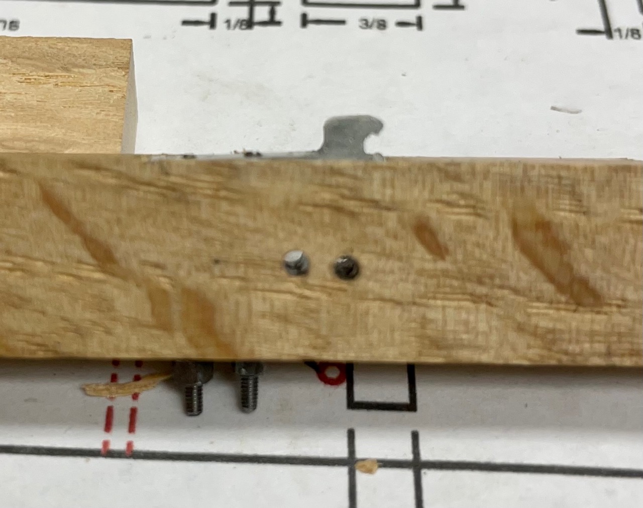

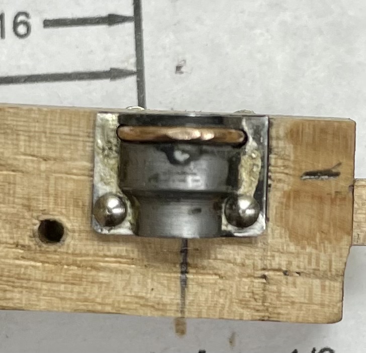

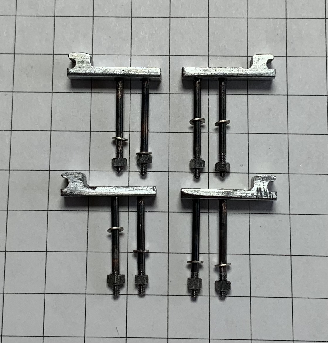

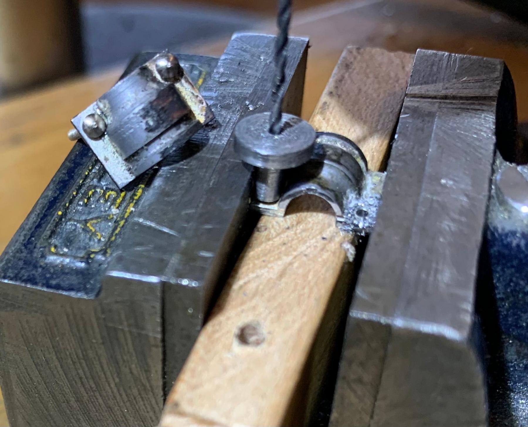

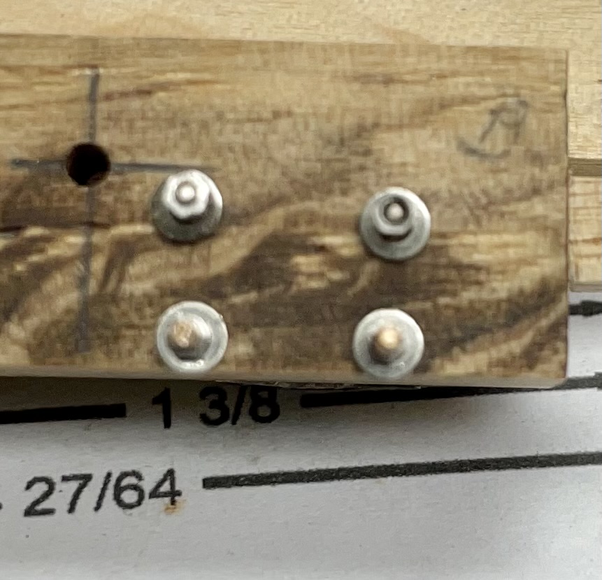

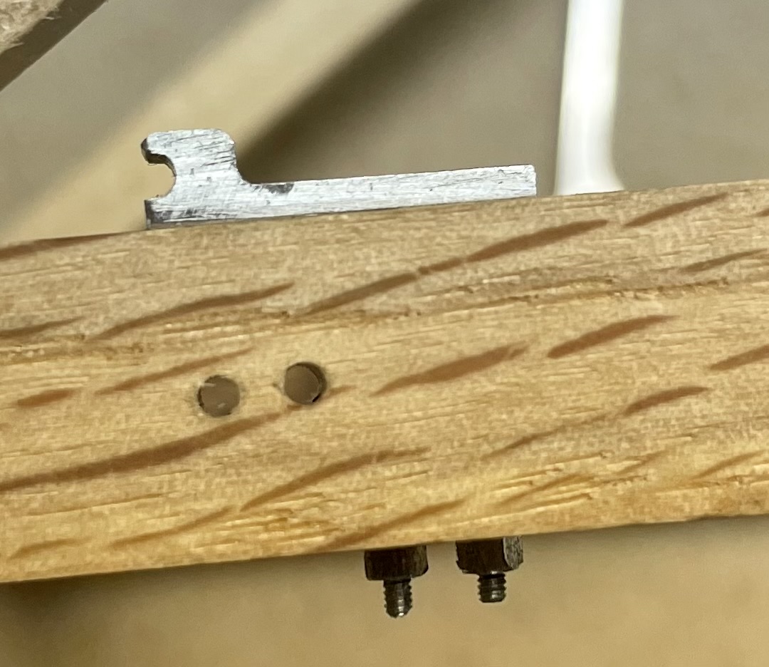

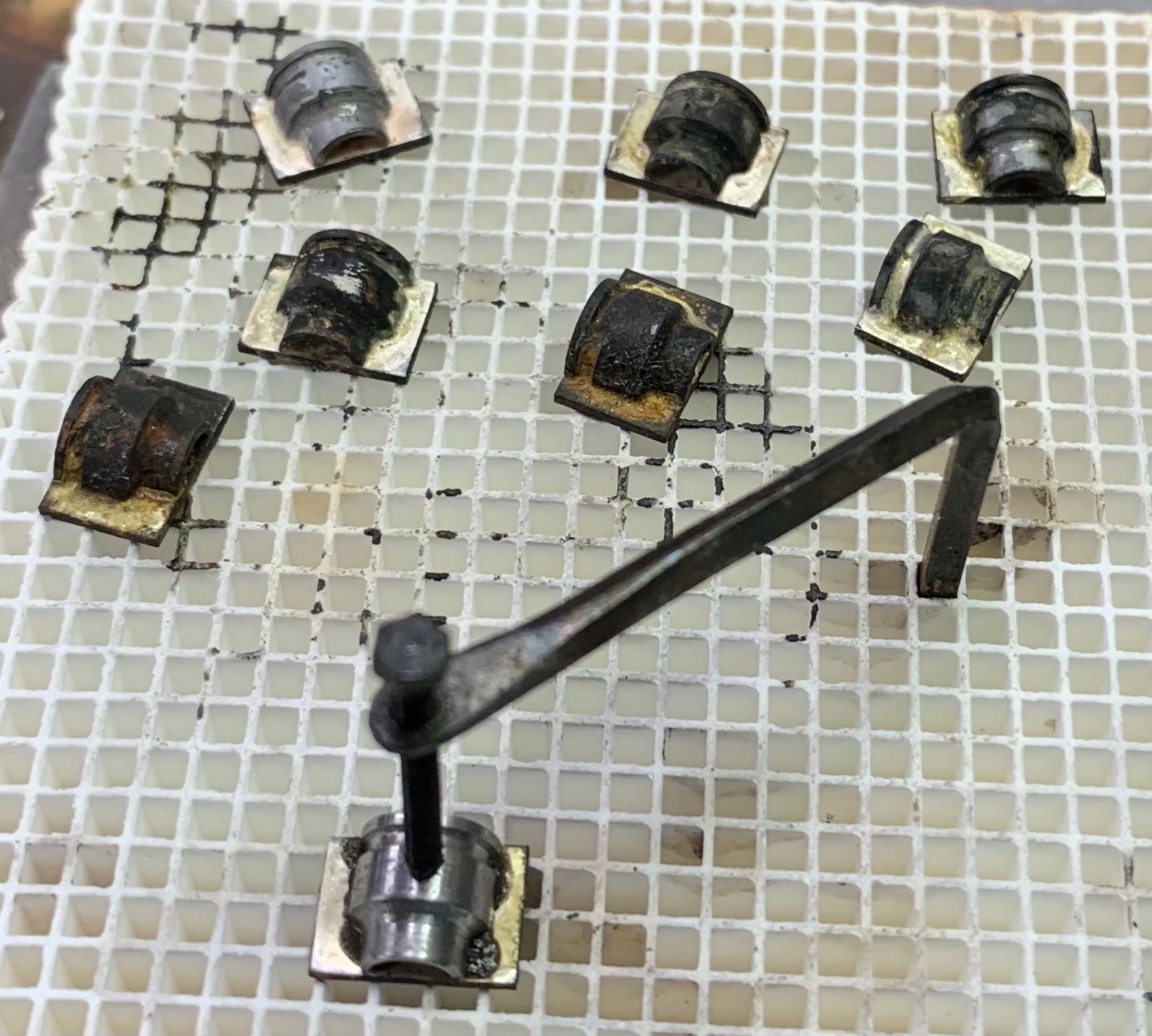

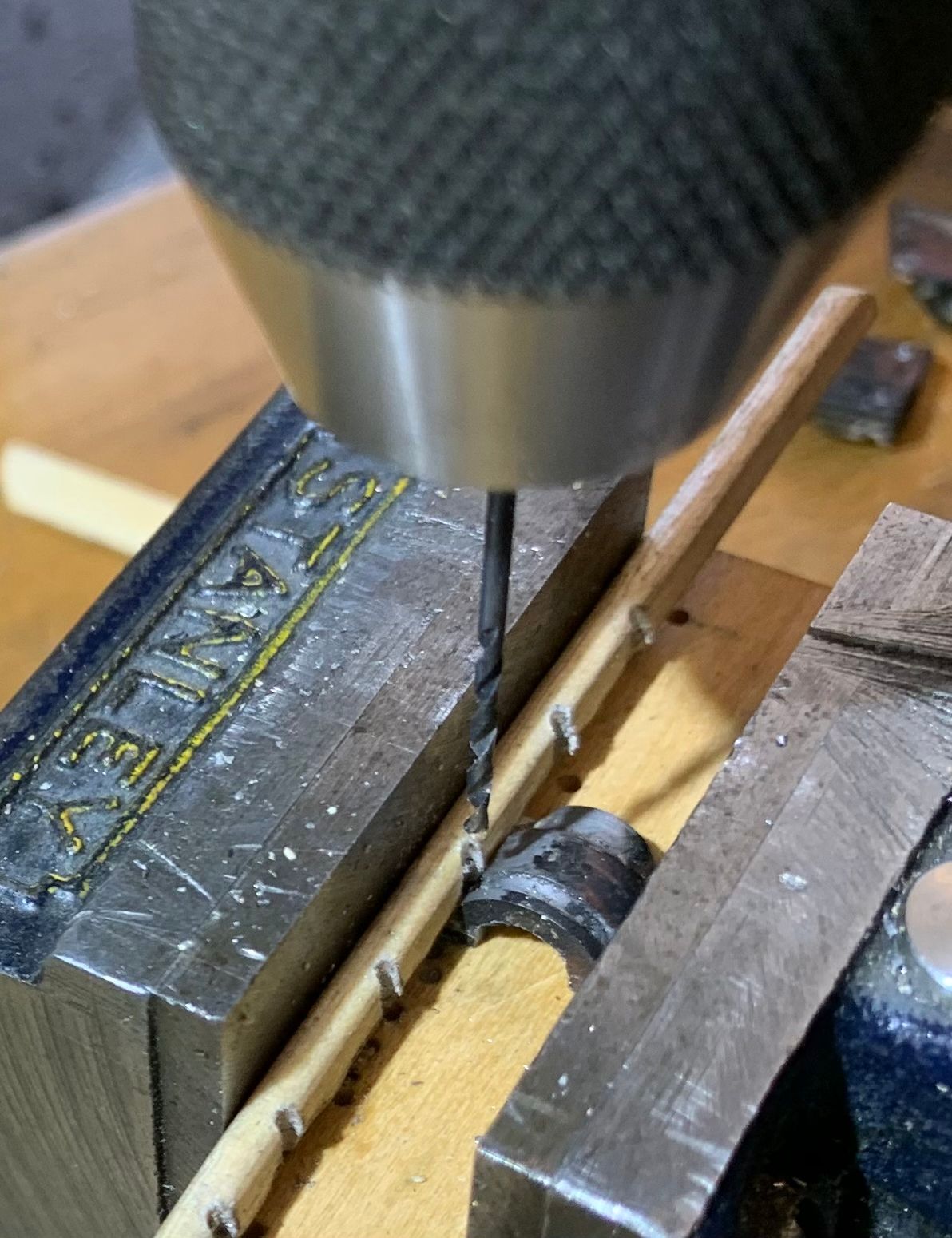

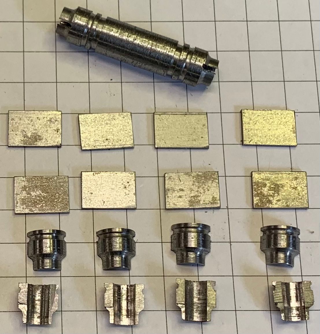

One of the first metal parts I made was the stake pockets. This was a fairly straight forward process. I worked out a set of lathe tools to make the details on a steel tube that I made for the work. I liked the profile so I used a slitting saw to cut it in half and make the rest of them.
Here they are with the backing plates ready for silver solder:
I bent a section of 2mm key stock and flattened the end and taped it for a 2-56 bolt for a hold down arm for my ceramic soldering plate.
I removed the middle section of the backing plate and filled the inside for the half round section of the maple posts.
I used a scrap piece of wood to clanp the piece and act as a drill guide to drill the holes for the U strap.
I made another drill guide to get the lower bolt holes in the correct location.
Here are photos of Bob adding them to the frame.
Now sure that all looks like it went to plan but I forgot to measure the height of the part and Bob noticed that things were not fitting correctly. After a long conversation over the telephone, I was looking at my drawing and Bob was looking at the real part. We finally worked out that someone had a bad day at the Loco Works and made the part too tall. Well, way too much work was done by Bob on the oak frame to start over so we had to come up with ways to fix the problem.
I still have to figure out how I will get the steel truss rods past the extra long stake pocket as the stop piece for the truss rod was already installed which will be in the next post.
Cheers Bob and Dan

Here is the photo with notes as to what I have decided to do with the visible frame details. The front of the loco is not in the photo so I just made front and back a mirror image.
The angle line is on the front and back truck and looks like it goes from the top bolster to the deck? I have no idea what it is for. The rest of the things except for the extra large hat rack will be used in the model and shown in detail as we get to the part.

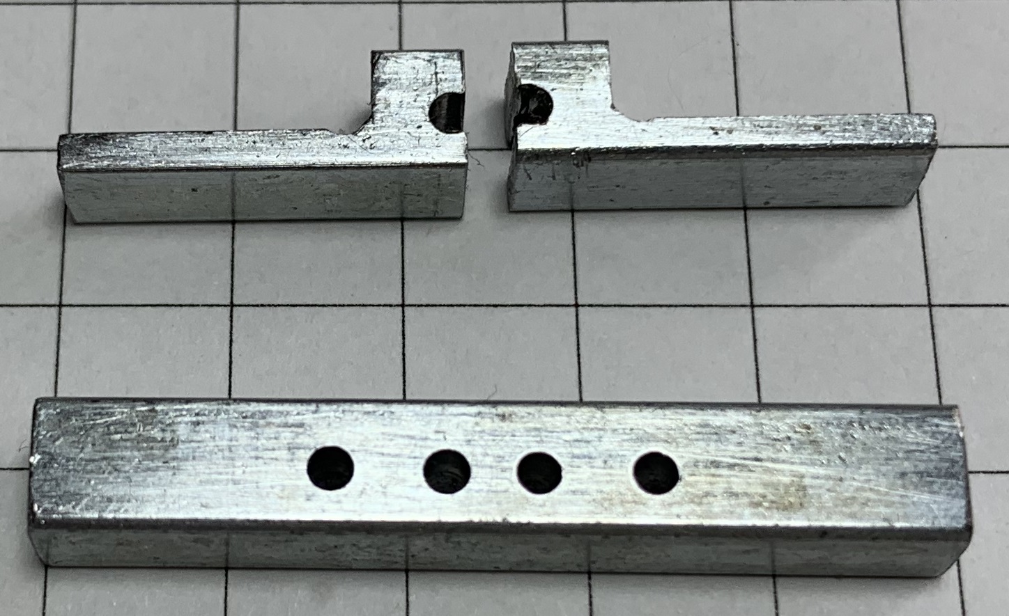

The truss rod is a U section at the top of the frame so it needs a stop to keep it in place. The early steel frames had a similar U rod and a casting riveted to the I beam. Here is my take on the same part for a wood frame.
Here is Bob's shop work installing them flush with the top of the frame so the decking will cover the thin section.

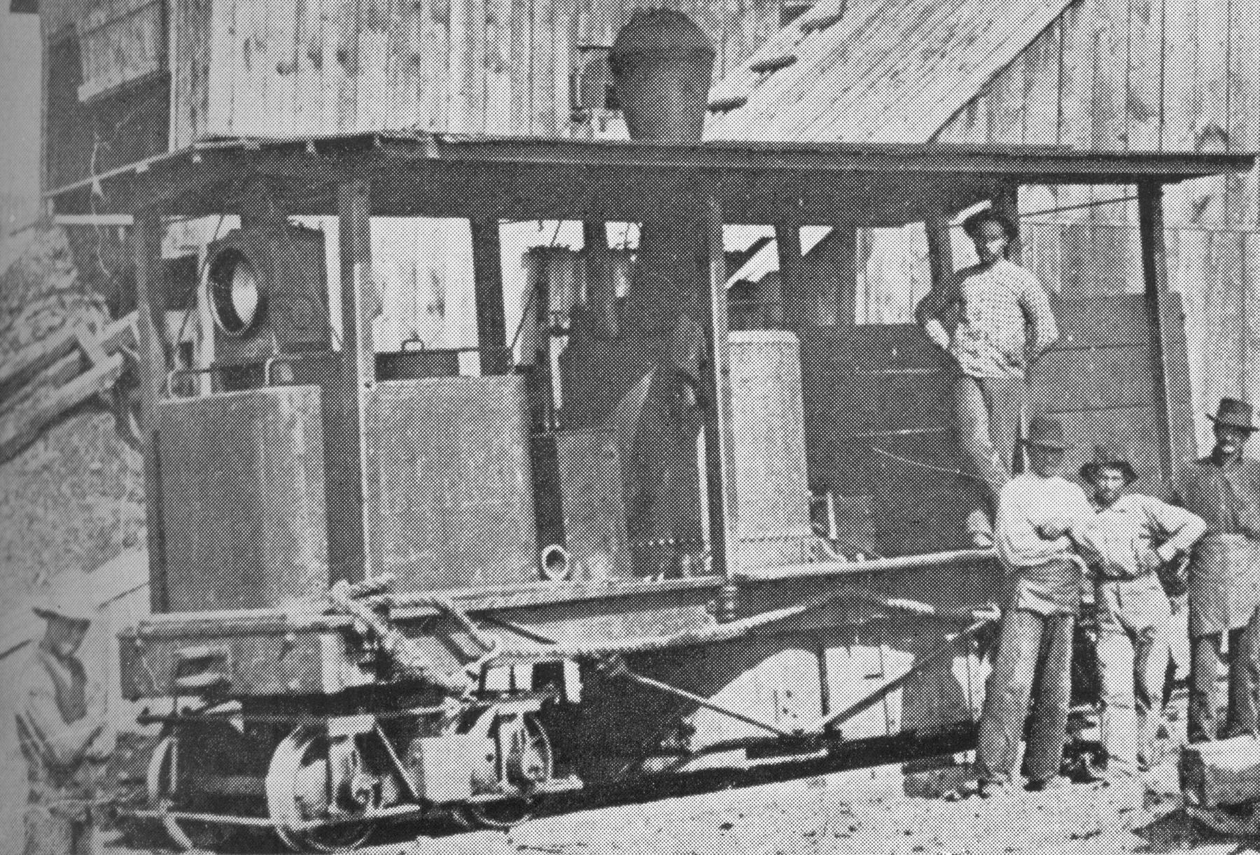

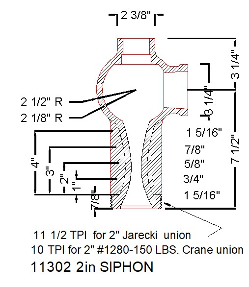

Here is the 2" siphon used on small Shays Lima card 11302.
I am planning a dummy casting to slip over the gas line to hide it in plain sight.
The photo of S/N 21 from the LEFT side is the earliest left side Shay photo I know of. There are a few key things for this build.
The bolts on the end timber made my decision to use them and the set of side bolts on the photo of S/N 10 as a timber brace rod. I simply flattened some fence wire for the two frame bolts and made a T section for the end timber.
Notice the truck pedestal bearing and the arch bars. They look just like a log truck arch bar and pedestal and are not offset like almost every other left side photo of a Shay I have ever seen.
This build will have that early feature so maybe someone will give the left side of a Shay a glance or two...if only to say 'hey that ain't right'.
Cheers Bob and Dan

« Reply #27 on: December 04, 2021, 10:48:01 PM »
That left view show the side opening of the siphon unit nicely. Also a clearer view of the boiler. Looks like the firebox is down between the frames, just above the rails? Behind it is another metal box, is that space for shoveling and raking, and to keep embers from falling out onto the rail bed? Also noticed the side to side angled rods/wires next to the light to brace the roof. Amazing what shows in the pictures.

« Reply #28 on: December 04, 2021, 10:51:05 PM »
The left side pic shows another box between the boiler and the water tank, above the siphon. Do you know what that is? Toolbox, condenser, giant lunchbox?

« Reply #29 on: December 04, 2021, 11:14:08 PM »
Chris, yes I think you are correct although I had not worked it out that the siphon is vertical and we are looking at the hose connection. Normally the siphon is on its side attached to the left frame rail.
The firedoor is at the frame level or just below. There are no vertical boiler drawings available but catalog data states the number of tubes and the length of the tubes and that the boiler is a submerged tube type. That last bit took me a bit to figure out but the boiler has the upper tube sheet below the waterline so a rough estimate of the design is possible. There will be a submerged tube boiler on the model.
The box behind the boiler is wood I believe and the pit irons can be seen again. they are metal straps that support the pit floor and sidewalls. The fireman has to work the fire by standing in the pit and chunking logs in the firedoor.
Yes, we will have the little wire angle brace also. and the roof will have the same design.
The box between the water tank and the boiler is the sandbox.
Good eye Chris and thanks for working out what that round thing was. Seeing the siphon print vertical did not work for me as I already knew how a siphon was usually mounted.
