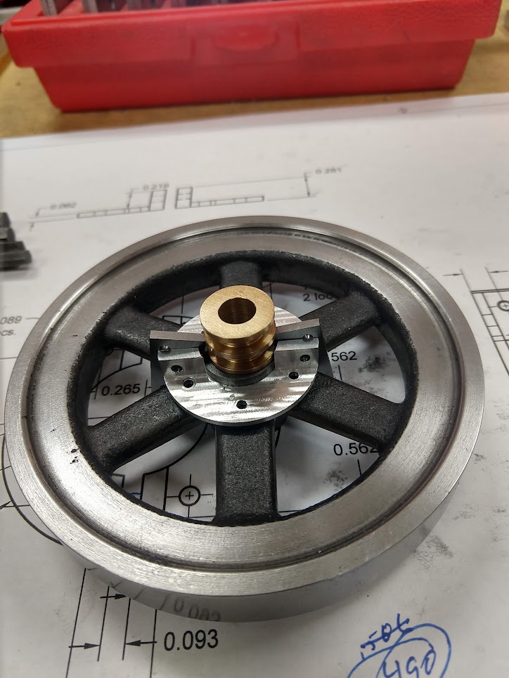

Here's where you can see why I used a square fixture for this part.  Now i turned the fixture in the mill vise and drilled thru tapping size and then tapped 2-56 on one side and the other side was opened up to clearance for 2-56.
And here's the finished carrier on the print.  Note that i changed it up a bit from Upshur's original design.  I left just a bit of material so that the 2 halves of the carrier remained together.  My thinking is that this would assure easier alignment when installed on the flywheel.
And here's how it will fit on the flywheel.  This is just showing the general arrangement.  I knew that I needed to trim down the hub of the flywheel and that became obvious when I started to fit it.
So it was back over to the lathe with the flywheel to reduce the height of the hub on the inner side of the flywheel.  I used a boring bar to do so as it could easily reach into the area and it cuts well.  I also machined the spoke area completely flat so that the carrier would fit securely on the flywheel.  I didn't want to mark up the OD of the flywheel but yet I wanted to not have a bunch of runout on the flywheel as I was machining the hub.  What I ended up using was as single layer of aluminum foil tape which is most commonly used for duct sealing.  This stuff is very sticky and is completely uniform in thickness at right at .004".  And it worked!  No marks on the flywheel OD after machining.  It's a good product and I'll certainly use it in the future.
Then back over to the mill to drill and tap 6 locations 2-56 to hold the carrier.  I just centered the flywheel under the spindle and used xy coordinates to locate the holes.  Note that I continued to use the foil tape to protect the OD.  It continued to work!
Here's a mod to the flywheel that I had to do after I started trying to fit the hnm mechanism.  Since I used a cast flywheel, the hub and distance at the spoke hub webs was larger than Upshur's design.  So where the hnm arms are located I used a 3/16" end mill to remove the material at the 2 locations so that the hnm arms would close properly.
Here's part of the fitting process.  Everything mounted but the shoulder screws that I wanted to use were interfering just a bit on their heads.  Plus you'll note that they prevent the 2-56 mounting screws from being installed at 2 locations.
And here are some fitting mods to the hnm arms.  I rounded the ends and kept trying them until the fit the spool properly.  I also shorted the other short arms so that they'd allow movement toward the hub.  I had to do this since my hub OD was a bit larger than Upshur's original design. Rounding was done on a belt sander after bluing and marking with a radius gage.
To cure the interference issue on the 2-56 screws, I made a couple of .093" pins out of drill rod and made grooves on each end of them to accept a 3/32" e-clip.  I didn't use anything fancy for grooving.  All I did was to grind down a bit of HSS to .020".  The grooving actually went very well as the tool was sharp and I didn't have to go very deep.  In case anyone hasn't used these very small e-clips before, my advise is to buy some extra ones as they are extremely likely to launch themselves into another dimension, never to be seen again, if you slip at all during installation or removal.  The best tool I found to use was a pair of the locking type of hemostats.

Now that I managed to get everything moving freely and pretty well as it should be moving, I moved the hnm mechanism by hand first to its 'hit' position, that is low rpm and made sure that the lever did NOT engage with the stop.  That can be seen in this pix.
Then I moved the mechanism by hand to the 'miss' or 'ball-out' position and as you can see the lever clearly engages the stop which in turn locks the exhaust valve open.
And here's a view of the hnm mechanism fully installed showing the weights and springs in their 'hit' position. So far so good.
