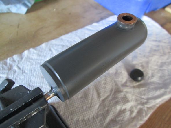

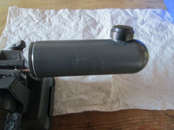

One thing I enjoy at least as much as making parts from raw bar stock is re-purposing discarded “junk” into useful parts. Flywheels made from old cart/dolly/caster wheels are one example. A fuel tank made from an empty CO2 cartridge is another.
The cartridge was originally in a self-inflating PFD, or life vest. The rip cord wasn't pulled because I fell in, but only because I wanted to test the thing (honest!). That was 5 or six years ago, and the empty cartridge has been knocking around looking for work ever since.
I started by cutting off the end with the threaded nipple. A scrap bit of 12L14 was turned with a short step to fit into the now open bore, and drilled at the lower end for fuel delivery tube (a piece of 5/32 brass tubing). The top of the cartridge was drilled 3/8” near the opposite end to accept a filler neck. This is just a hardware store flanged bushing, also from the “left overs” drawer. Another bit of steel was turned to make a vented cap. This was heated to red and dunked in veggie oil for a "blacksmith's finish".
These various pieces were finally all soldered into place (except the cap), and a coat of grey primer/topcoat was applied.
An easy-peasy job to fill some time while I wait for the ignition coil I ordered to arrive.
