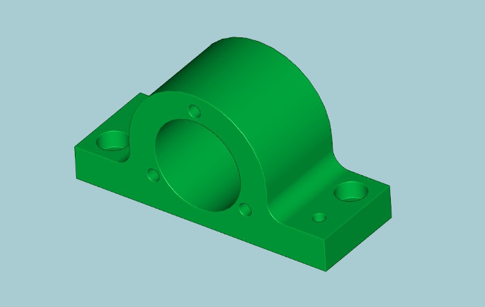

I built a bearing mount recently and had some trouble. It's made of CR 1018 and looks like this:
I cut the large hole for bearings first. SOP so the larger stock is easy to hold in a lathe four jaw. Very nice fit. Then went about hacking off the outside curve in the mill. When finished the hole for bearings was definitely not round. So I tried again by first annealing the 1018 stock. I'm not sure which reference I used but the temperatures can be found here.
For annealing just heat up to temperature, leave at temp for an hour or so (guidelines give time at temp versus thickness of part, but it's an hour or two). Then turn off the oven and let cool overnight. (Avoid the temptation to open the door and look inside.) For 1018 temperature is 870-910 deg C. For stress relieving it is 500-700 deg C, but let cool in still air rather than overnight in the furnace. I don't know the colors to go for if using a torch for heating.
On the second try I cut the outer curve first and made a jig to hold it in the lathe for the hole. So I'm not sure how much the annealing helped, but the part came out well.
For a crank it may be best to cut the basic shape leaving dimensions a good bit oversized. Then stress relieve, followed by finish cuts.

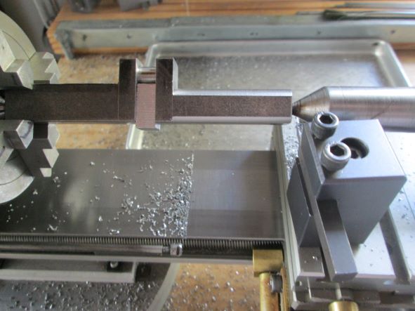

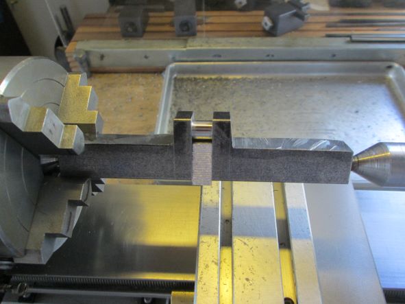

Got the crankpin turned before lunch. Not much I can do about leaving material there, since the centers for turning it will be removed preparatory to turning the main shafts. So it's finished to final size. It'll be interesting to see what happens after I hack off the surplus material from both ends and start turning the mains.
  • Posts: 1697
Re: An Upshur Farm Engine
« Reply #28 on: September 18, 2021, 01:02:30 AM »

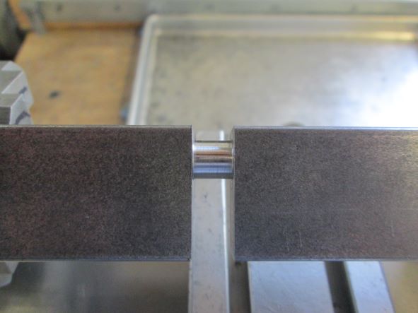

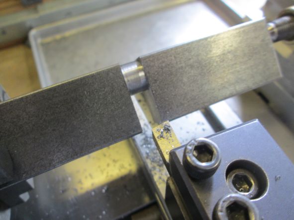

As mentioned above, I turned the crankpin this morning. I worked it down slowly, alternating between using left and right turning tools to face the web cheeks, and a parting tool to turn the OD.
So far, so good.
I cut away most of the waste material outside the main shafts with my trusty ankle grinder and a hack saw. Then remounted it on the other set of centers. The block of aluminum is a light tap fit between the cheeks, and is secured with a bit of Loctite. Once the turning is done I'll remove it.
My plan is to work this down slow and easy also. Once I knock the corners of the first end, I will turn it around and do the same to the other end, plus take it down a little farther on the OD. I'll continue swapping ends like that until I get to the final size. Hopefully this will help mitigate the warping tendency.
