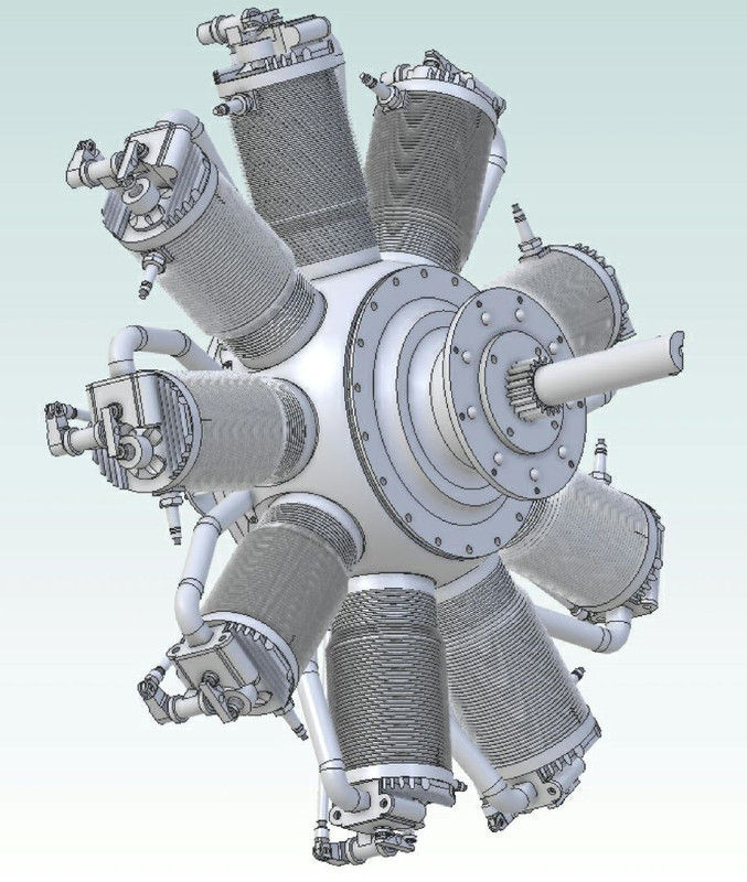

Ever since I finished my last Otto & Langen model, I’ve been trying to choose my next project.  I had several in mind, but nothing really immediately inspired me.
I have been fascinated with WWI rotary engines (where the crankshaft is bolted to the airframe, and the whole engine rotates with the propeller) since I was a child.   Probably every American kid of my generation was introduced to Baron Von Richthofen, the “bloody Red Baron“ and his Fokker Triplane (powered by a Le Rhone) through the immemorial Carl Shulz and his peanuts comic strip with, Snoopy flying his doghouse as a Sopwith Camel (also powered by a Le Rhone) and constantly being shot down by the Baron and his Triplane.
I started some research on the Le Rhone, the rotary engine that powered 80 percent of the WWI aircraft.  The reading was fascinating and before long I was hooked on building a model of the Le Rhone.  So we all know the engine I’m planning to model, below are a few photos of an original engine.
And this is a youtube video of one being started and run at the NW Biplane Fly-In 2009, Felts Field, Spokane Washington.
<a href="https://www.youtube.com/watch?v=WfEEmdz7-Fk" target="_blank">http://www.youtube.com/watch?v=WfEEmdz7-Fk</a>

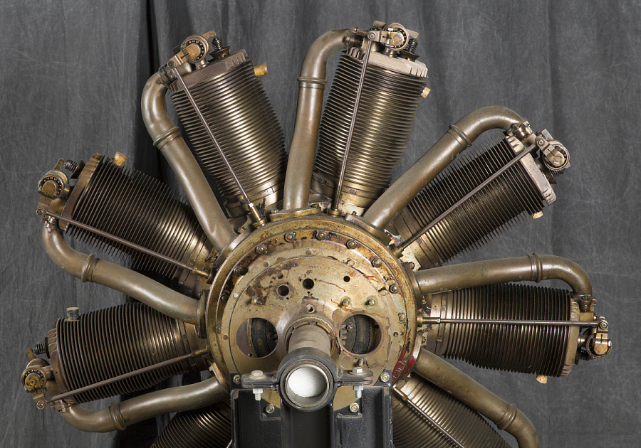

The Le Rhone came in various models, with the 80 HP 9C being the most widely built during the war.  I personally think it is the most attractive of the different versions, with the intake pipes out in front of the cylinders where with other versions (such as the 9J) they are positioned behind the cylinders.
Lest you be misled; I’m not trying to attempt a model such as the exceptional radial engines that Mike has built.  His work is just fantastic and I won’t begin to compare what I’m trying to accomplish to what he’s done.  As I’ve built in the past, this will be a “sort-of-scale” model of the Le Rhone.  None of my scale models will pass close scrutiny, but they look pretty accurate from a few feet away.  That was the plan I had as I began design of the Le Rhone.
As I got into the design I began to realize that an awful lot of stuff whirls around inside the engine case and getting it all to fit, let alone preserve the needed clearances was going to be  difficult.  This became so problematic that as the design progressed, I started doubting my skills in building something as complicated as the design was becoming.  Reluctantly I decided to switch my efforts to designing a free-lance rotary engine with five cylinders.  With a free-lance design you aren’t held to any specific dimensions, and if something needs to get bigger or move, you’re free to do so.  The design of the 5-cylinder rotary was well under way; but the more I looked at it the more dissatisfied I became.  Realizing that I couldn’t really get excited building this free-lance engine, I took another hard look at the Le Rhone.
This current design has been worked, and re-worked, and modified countless times until I think I have everything inside the scale size engine case with the clearances needed and I’m thinking I have a good shot at being successful with the build of this model.
The model will be a bit under ½ scale; being a bit short of 18 inches across the diameter of the cylinders, valve rocker to valve rocker.  It’s a bit larger than I wanted but if I build it smaller, the parts get so dang small that I won’t be able to see what I’m doing and then building stops being fun and why build if you aren’t having fun?
Don’t expect this model to be built quickly, I’m through with spending eight hours a day, seven days a week in the shop, so the build pace will be at a much more leisure pace than in the past.
Before I leave you, I’ll give you a few views of the design from my CAD software.

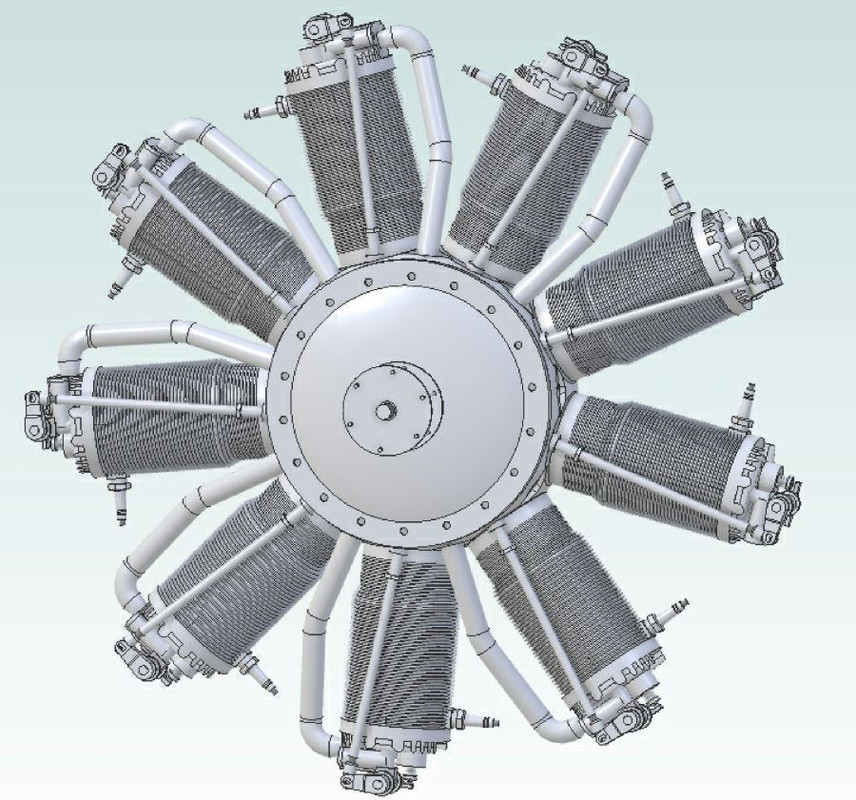

I hate to be the one to point it out, but the intake pipes on the 80hp LeRhône 9C are on the trailing side of the cylinder. Rotaries had the exhaust on the leading side maximize cooling of the hottest bits of the cylinder heads. In the case of the 80hp LeRhône, things are rather more fortunate than its contemporaries as there are drawings of most all of the components as it was built under license by Union Switch & Signal in Swissvale, PA. Some of the drawings (photocopies) are very difficult to read, but in most cases the dimensions can be figured out from the mating component drawing. It does save a lot of experimentation and guesswork of proportioning the parts so they all fit together. Of course you might still simplify it dramatically just to make it easier to build. I got most of the way with my CAD model, less the rocker and valve gear before running out of steam.
The situation is almost as good with the 110hp LeRhône 9Jb, with most of the drawings available. The first pics in your post are of the 110hp, which had the intake pipes on the rear side of the crankcase. I did not get as far with that so not entirely sure what is missing in the drawing package until you go to look for something and find it is not there. Most other engines you end up scaling a cross section view from a handbook. Though in the case of the Clerget 9B I was able to borrow an original Gwynne built version, disassemble, clean, and reverse engineer it in the process. And if you have a British built Clerget 9B you have a third of the Bentley BR1. Not to be confused with the slightly bigger Bentley BR2 popularized by Lew Blackmore's serialization in Model Engineer and publication as a book.

Mike: don’t know what I was smok’in yesterday.  The scale is actually much closer to 1/3rd size than ½.  The distance across the cylinders (rocker to rocker) is a tad over 12 inches (not 18??).  One of the places where I’m deviating from the full-size engine is in the area of the cylinder head.  The full size has blind cylinders with the valve guides set into the end of the cylinder (head).   I’m not looking forward to boring out a blind cylinder and then reaching in about 3 ½ inches to cut valve seats and expecting to have much success, accuracy and a smooth valve seat is paramount; therefore I’ve designed the heads to be separate and I’ve decreased the bore of the cylinder so I can bring cap screws up from the bottom of the cylinder to ‘blindly’ attach the head.  This should give the appearance of the head and cylinder being one integral unit on the model when in-fact they are not.  In order to do this I needed to thicken the head so that it can accept the threaded ends of the bolts and an attentive observer will recognize this in the model.
The bore/stroke of the full-size is 4.13 x 5.51 inches.  The bore/stroke of the model will be 1.125 x 1.425 inches.  You can see that I’ve shortened the stroke (to get things to fit in the engine case) and decreased the bore (to accommodate the fasteners for the heads).  The model will have close to 9 cubic inches of displacement so I doubt the decreased bore will be a concern in allowing the engine to run.  I’ll probably need to use a smaller propeller.

Doug:   :-[
Sometimes you get so deep into the forest that you can’t see the trees.  I have no excuse, but I’m sure glad you caught this.  I’d have made a scale model of a “nothing” had you not pointed this out.  THANKS!
Finally, Dave:  Glad to have you along!

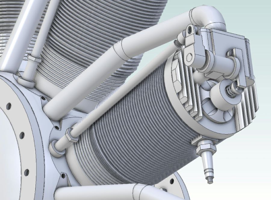

So, let’s try this again…. A few photos of the Le Rhone 9C
I’ve revised the CAD drawing.  Fortunately, the required changes didn’t cause too much of a fuss inside the engine case, and in-fact the re-positioning of a few components might have helped a bit.
