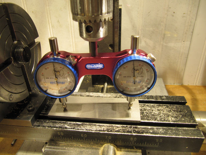

This afternoon the 'mini' version of the Edge Pro Tram that I had ordered arrived. The mini version has a 3" span rather than the 6" of the larger one, and has a 1/4" shank vs 1/2", so it fits better on the Sherline mill.
Very interesting - turns out the tram was out by 10 thou over 3" the way I had the headstock mounted. By loosening the headstock holding bolt (which allows removal or rotation of the headstock) and lifting it to one side to retighten, I could get rid of over half of it. Since I have the mill riser block in, which gives more reach over the table, doing the same on the riser block let me get rid of the rest of the error. The Sherline has a square key in a slot under the headstock and under the riser, which gets the position very close, but there is still just a little qiggle room to the fit on it. The tram in the other direction, in line with the column, was good.
The check and fix of the tram took maybe a minute overall - quite quick and easy. I've noticed in the past that sometimes I was not getting it square, easiest to tell with things like the fly cutter and larger end mills, when seeing the pattern it would leave as it went across a surface, but never had a good way to measure or correct it. On the lathe, where I rarely move the headstock, I would check the alignment before boring pistons/cylinders to make sure I would not get a tapered cut.
Quite happy with the purchase! Given how often I add/remove the riser, it will be well worth it. Thanks for posting about it Kim! I also looked through their catalog, and saw the mill end stops they sell, those would be very easy to make to fit my t-slots on the table, I had been bolting down the 1-2-3 blocks as stops for long items, the style they make would be an easy, um, imitation, to make for myself. This tram is something I could have made, but it would have taken a bunch of time, and also the cost of some bar stock plus two good inidicators which is not that much savings. If I rarely changed the headstock setup, it would be less worth it and could make do with other methods.

« Reply #24 on: August 15, 2021, 01:06:12 AM »
Pictures please!!!     something like that would be nice on the Aciera F1
Here ya go!
Given that my mill table has some obvious scratches in it (it does get just a wee bit of use) I tried it with and without a piece of flat plate - got same readings both ways, and with the plate it didn't dropt the tips into the slots when turning it to measure the lean in the column (none). It comes with a little magnetic post for calibrating as mentioned in earlier posts here, since my mill table is aluminum it just stuck itself to the indicator tip rather than the table! Other than that it worked great. Checked it rotated around the axis to make sure that the drill chuck was not introducing any error, it was not. Holding it in a collet would be better, but I dont have one for the headstock.

Despite suggestions earlier in the thread do be careful if using Gauge plate or Ground Flat Stock to run the tool against as despite it's name the FLAT only differentiates it from round stock. Tolerance is something like 1mm over 1m length so a 150mm square which I what I would need could be 0.15mm out.  ::)
The material is "flat" while it is being ground on the bed of the grinder but can bow or get accidentally bent if poorly stored or handled.
