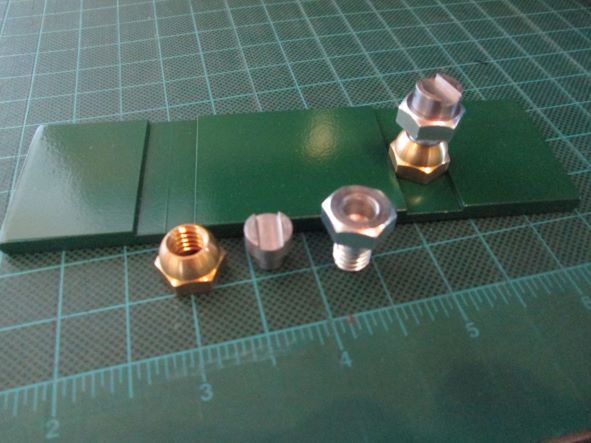

Stuart - I made something like what you're talking about for my Taig mill. They do help a lot.

That's a cool upgrade for the Taig, Ron.  I always just did the 'loosen it a little and bop it from one side or the other' method.  It mostly worked, but this looks much more controlled for sure!

Yes - exactly the kind of thing I was thinking of.  :ThumbsUp: :ThumbsUp: :ThumbsUp:
