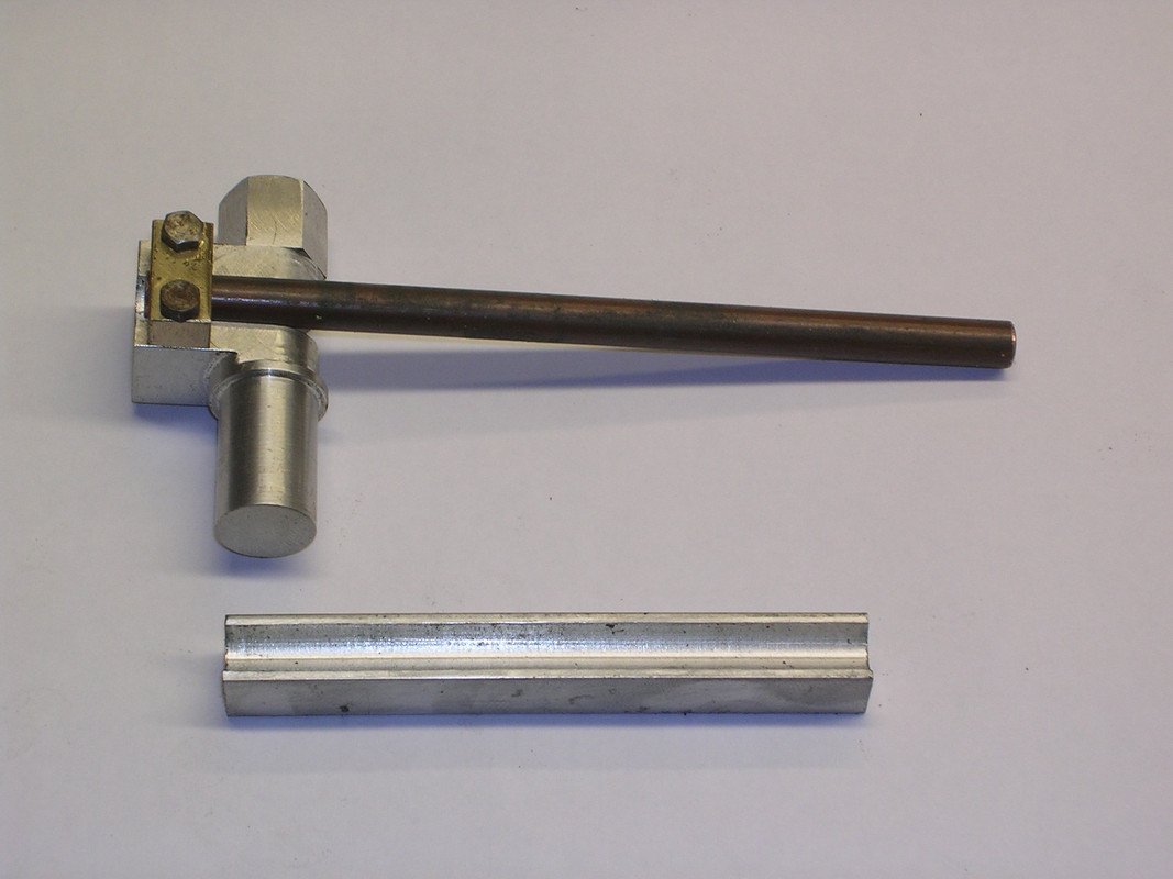

I decided to have a go at making a small bend radius pipe bender specifically for 5.0 mm copper tube. I based my pipe bender on the design used by Steve "Old Bill" to bend the external pipes on his 1909 Mercedes aero engine.
It did not take long to make, using offcuts and scrap pieces from the 'come in handy one day' box. There are one or two changes to the "Old Bill" design; I use two bolts on the adjuster to stop the slide bar from rocking, Similarly I added a third roller for the same purpose. This bender is designed to bend 5.0 mm copper pipe around a tight 5.5 mm internal bend radius. However is can easily be adapted or modified for other sizes of pipe or bend radii.
The 5.0 mm diameter groove in the slide bar and the rotating bit were made with a 5.0 mm ball ended cutter. The 10 mm AF hex was quickly done by indexing on the 4 th axis unit. The three brass rollers spin on hardened steel shafts, but this is realy not necessary to harden the shafts as they do such little work.
The pipe bender can easily be adapted for other tube/pipe diameters by machining a different diameter grove in one of the other faces of the slider and making another rotator with an appropriately sized groove at whatever bend radius is required.
A few 90* test bends pointed out the need for an internal bullet to prevent the 5.0 mm copper tube from flattening on the outside. A piece of angle iron was used to anchor a length of 4.0 mm steel rod inside the copper tube. The steel bullet rod needs to be clamped sufficiently far away from the bender to allow for a long length of stock tube.

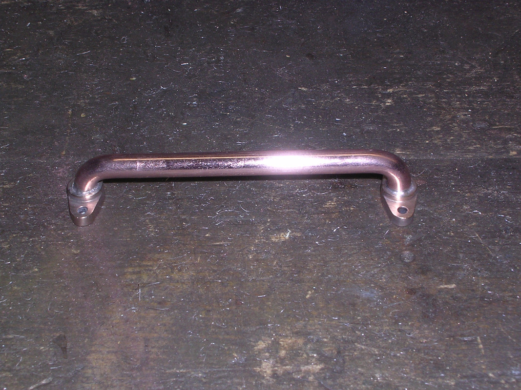

In the photo below; the bend on the left was made from, as delivered, hard copper pipe without the central bullet. You can clearly see the flat on the outside. The middle bend was made the same way after the copper had been annealed (heat to bright red then quench in cold water). The flat is much reduced but still there. The final bend on the right was made with annealed copper and with the internal steel bullet rod, as you can see the bend is perfectly formed without the dreaded flat on the outside. The internal bullet is positioned inside the copper tube just short of where the bend commences. Somehow it prevents the outside of the tube from collapsing inwards
The bending part was easy, once the bender was set up properly. Not so easy was getting the second or third bend in the correct place or at the correct angle to the previous one. Lots more copper pipe found it's way into the scrap bin until I eventually discovered the knack.

... The final bend on the right was made with annealed copper and with the internal steel bullet rod, as you can see the bend is perfectly formed without the dreaded flat on the outside. The internal bullet is positioned inside the copper tube just short of where the bend commences. Somehow it prevents the outside of the tube from collapsing inwards
You really got a nice bend there!  I'll have to remember this technique.
So, is the bullet rod the exact internal diameter of the tube you're bending?  And what shape is it on the end?  Does one assume its 'bullet' shaped since that's the name of the rod?
I would have thought the 'bullet' needed to go in the end of the jig that turns, so the bullet could stay tangent to the part of the tub that is bending.  But in your jig, it looks like it is in the stationary part of the tube.  Is this right?  Or maybe I'm not following it very well?

To answer your questions:
The bullet rod needs to be a reasonably close fit to the copper tube but not a tight fit. Initially I turned a bullet shaped end which I thought would conform to the bend radius. It seemed to grab the tube, so I cut the end of the rod off flat with a tiny radius to stop it scratching. The internal bullet is positioned inside the copper tube just short of where the bend commences i.e. at the point where the tube is tangent to the rotator. If the internal bullet is too far inside the bend, the pipe buckles and kinks. You may need to do a couple of 90* test bends to find the sweet spot.
And yes the bullet rod is held stationary. The copper pipe is pulled over the bullet rod as the bend forms.  The bullet rod does not enter the bend, it just stops the copper pipe from collapsing. With this design, the copper pipe is pulled and stretched round the bend, it is not a simple case of being bent.

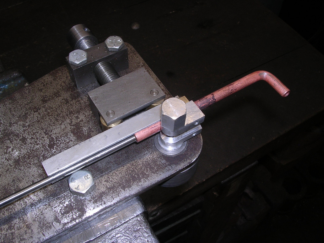

So if the slide bar moves with the tube, how is the bullet rod held in place? Looks fascinating - gotta make on of these...

Out of the picture to the left, there is an aluminium block clamping the bullet rod to the angle iron. The bullet rod remains stationary,  The slider and the copper tube move to the right as the pipe is pulled and stretched around the rotating part. This is not a simple bender, it stretches the pipe round the bend. Not sure if the inside gets compressed.
The length of the bullet rod and the angle iron depends on the stock length of copper pipe. It's always best to start with the stock copper pipe as long as possible.
The copper must be fully annealed before you start bending. The process of stretching the pipe around the bend quickly work hardens the bent bit of pipe, while the straight bit remains soft. These hard and soft patches makes it difficult (impossible?) to correct a badly positioned bend. Best to scrap that piece and start again.

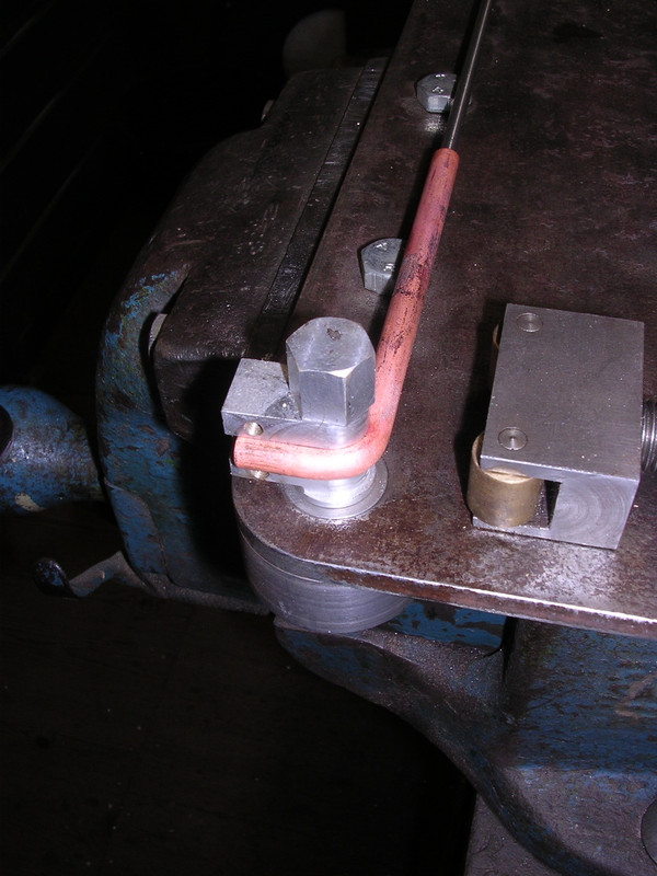

This is how I set up and use my small radius pipe bender for 5.0 mm copper pipe. The first photo shows all of the bender clamped in a vice at the dirty end of the workshop
The second photo shows the bullet rod positioned a fraction to the left of the bend centre line. The bender is quite sensitive to the position of the bullet rod so you will need to experiment. Note: I have also machined the position of the bending plate to be closer to the bend centre line than the Old Bill version.
I have marked the position of the start of the bend onto the annealed copper pipe, before moving it in to position and installing the slider bar.
It takes very little effort to bend the annealed copper pipe. I make the bend in one slow and continuous movement. I usually push on the slider with my left hand (when it's not holding the camera)
Then I mark the position of the end of the first bend and also the distance to the start of the second bend before moving the pipe into the new start position. Remember to rotate the copper pipe if the two bends are at an angle to each other.
I think I may have discovered the subtlety in how this bender works. The annealed copper pipe is held between the half round groove in the slider and the half round circular groove in the rotating part with the bullet rod up the centre. Everything fits tightly and totally constrains the annealed copper pipe both inside and out.  When the bend commences, it pulls and stretches (extrudes?) the outer edge and sides of the pipe into the tight bend. The stretching immediately work hardens the bent part of the copper pipe, making it strong enough to resist the flat forming on the outside of the bend. The softer unbent part of the pipe being held open by the bullet bar.
The bent section is noticeably harder than the straight unbent section. You can use this to your advantage. The soft straight section will twist easily if you need to correct the angular position of the two bends.
I also discovered that trying to rectify incorrectly positioned bends does not work. Best to start again with a fresh length of annealed pipe, so be prepared to get through a lot of copper pipe whilst you experiment.
