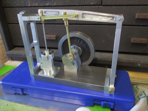

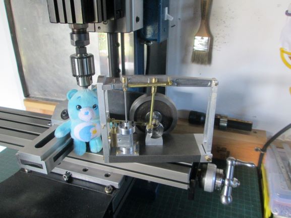

Been whittling away on Grasshopper parts. Using the lathe headstock as a rotary table worked OK, but without any positive stops or even means to increase the rotating friction, it was tricky working up to those little shoulders. I got it close, then finished off with files. (photo 1)
Also got the bearing blocks and the crankshaft done. The Allen screws are acting as set-screws for the bushings, and are temporary stand-ins. I plan to make a couple of little brass oil cups to go in their place. (photo 2)

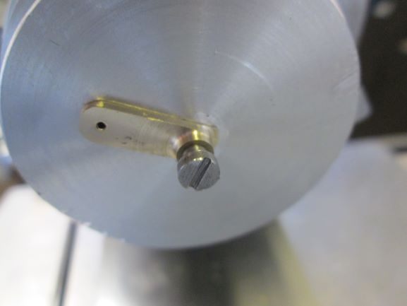

The plans call for notching the steel base for the upright arm that pivots on a pin and supports that end of the beam. I decided instead to make a separate aluminum bit to serve that function. Faced it to dimension on the lathe, then notched it and drilled it part way on the mill with a 10-32 tap drill. Then I clamped it to the base plate and drilled through into the base on the drill press, after which the hole in the ali part got clearance drilled. (photo 3)
That upright arm also gets a squared notch at the top to receive the beam. Here's the wrong way to set that up. This didn't look rigid enough to me, and so it proved. (photo 4)
Here's the better way. (photo 5)
Followed by the vertical set-up just to square off the bottom. I also realized that I could drop the part down into the table slot, reducing the height above the top of the angle plate. This worked fine. (photo 6)
That upright arm will be getting some cosmetic openings cut into it, but here is how it all looks so far. (photo 7)

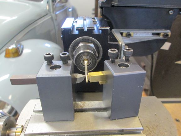

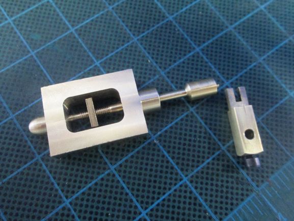

One handy little accessory I ordered along with my milling machine is the little fixture shown below. It's threaded 3/4-16 to match the Taig lathe spindle nose and bolts to the mill table. I don't imagine it's a Taig original idea, and many of you probably already have something similar, but if you don't you might want one! Being able to move the chuck or collets from lathe to mill table and back without disturbing the part set-up, or just moving parts between mounted collets as shown here, is really convenient sometimes. (image 8)
The part I'm working on the upper fork for the connecting rod between the crank pin and the beam. I'd already mounted the bar in the 4 jaw and turned a ¼ in spigot for the 5-40 threaded portion. That was used to mount it in the collet above, then back to the lathe to drill and tap. (image 9)
To round of the end I went old school. I parted off a piece of ¼ rod to be a snug fit between the jaws and used that as a filing guide. Started with a mill file and finished with needle file and wet/dry paper. (image 10, 11, 12 13, 14)

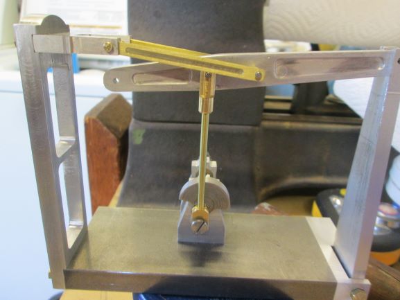

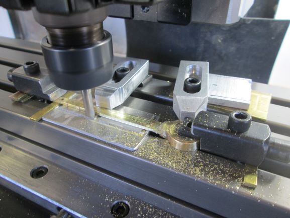

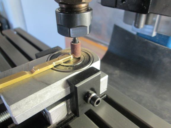

The links that connect the beam to the fixed vertical column are simple, but also pretty plain as drawn. I thought I'd add a relief to them similar those in the beam itself, to spiff them a little.
I clamped a piece of scrap ali to the mill table and drilled it to match the holes in the links.
That way I could mount the links over pins and be sure the cutting is uniformly in line each time.
I think the result looks much better.

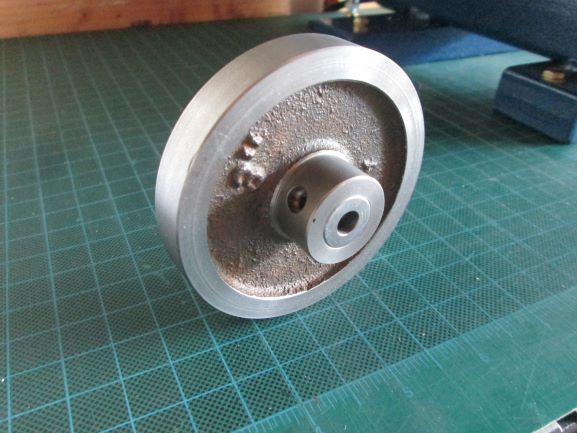

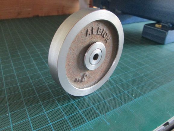

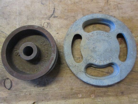

There is a great combination hardware story, pipe and metal supply, and salvage yard in one of the neighboring towns near me. The salvage yard is the main draw for me. It covers several acres and is an absolute scrounger's delight. Unlike many such places it is somewhat organized, much of the stock is on shelves inside open sheds, and you are free to wander all you want. Like a good bakery or sweet shop, it's probably just as well that it is not quite close enough for me to just casually “pop in for a look around” whenever I want.
I went down there the other day looking for potential stock for the Grasshoppers flywheel, which should be at least 3” x 1/2”  (76x13mm) and found a 3” cast iron caster wheel. The diameter is just right, but it's too wide and has a worn out ½ inch bore where I need a ¼ inch bore. Perfect! I also picked up a slightly larger piece with “future project” written all over it.
Since the a 3” diameter won't clear my cross slide I had to reach across with a right cutting tool to reduce the width. I cut back the first side chucked on the OD, as well as skimmed the OD and trued up the hub.
Then I turned it around, chucking on the hub, and brought it to the final width. The hub on that side was shortened to be flush with the outer edge of the wheel, and the bore opened up to 9/16” (14mm) for a sleeve I made from steel rod.
A few pictures of the end product. That extended hub looks the business for a flat belt PTO, and I left most of the “meat” on in case I want to reduce the diameter or cut a groove for a v-belt or o-ring later. I know the wheel  should really be spoked, but I'll wait until I acquire a proper rotary table to do that job. At least it looks OK as is.
  • Posts: 18688
Re: Elmer's Grasshopper
« Reply #21 on: April 30, 2021, 02:45:22 AM »
Nice find, looks great on the engine. Sounds like a fun toy store, I mean salvage yard!

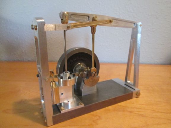

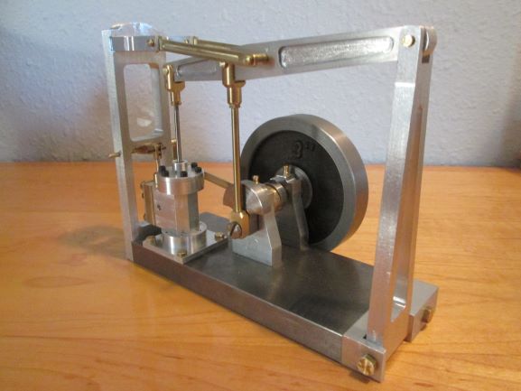

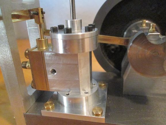

The last couple of days were spent mostly tying up some of the little loose ends that accumulate during a build. The biggest of those was getting the cylinder assembly located, fastened to the base, and connected to the beam. It's fastened to the base with four 5-40 machine screws cut from 3/16 hex brass. When I made that die holder I started to skim the OD, then realized, not having a knurling tool, that it'd probably be easier to grip with the mill finish.
The base was tap-drilled using the already drilled cylinder base as a template. The tap wrench I'm using was my great-grandfather's. The other one shown was also his. I have no idea how old either one is, but they both get lot's of use. I never knew him, he passed before I was born, but I imagine he'd be pleased they're still in use.
Still ahead are the steam chest and all the valve and valve motion parts. Before that though is vaccine jab #2 tomorrow morning.

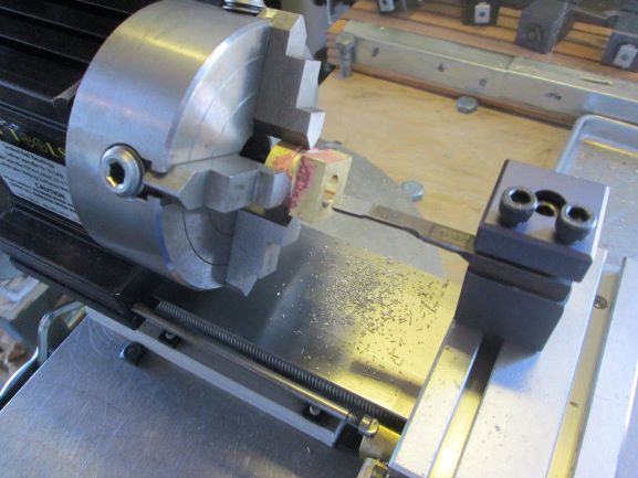

Got a start on the valve related components today. Used my 9” bandsaw to take a slice off a piece of 3/4” square brass (can you tell that's an after the fact staged photo?).
The thin piece will be used to make the steam chest and the big-end of the eccentric strap. The main focus today was to turn that stub of 5/8” mild steel into the eccentric.
That went fine until almost the last step. After skimming the larger diameter, I swung the tool over to chamfer the edge. I made sure the tool was clear of the smaller diameter and started the lathe. At that moment I realized my mistake. The smaller diameter is offset and it's not going to clear for long!
Luckily I switched off almost as soon as I switched on, so the only result is a minor scratch. Whew!
Normally I turn the spindle by hand first to ensure all is clear, but that time I didn't. I was thinking maybe I could report dumb-headedness as an after effect of the second Covid shot, but in reality it's a pre-existing condition.

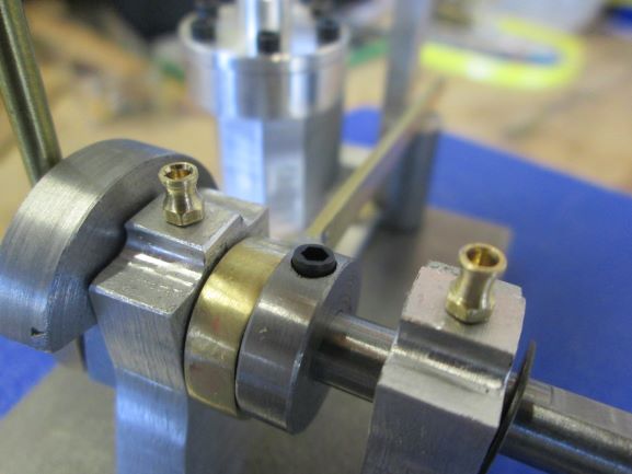

I was happier with the first of two oil cups for the crankshaft bushings I made at the end of the day today. Now I just have to make a second one that matches!

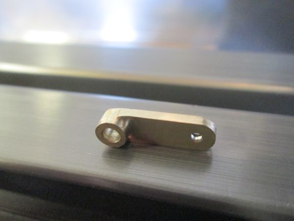

Today I started by making an oil cup for the other crankshaft journal to match the one made yesterday.
Then I moved on to the “valve crank”.

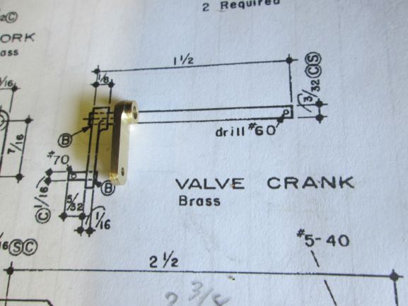

After I reduced the bar I started with to size and drilled the two holes, I tried something different to round over one end. In an order for some odd and ends, Taig mistakenly sent me their radius turning tool rather than one of the things I actually ordered. OK, similar value, so rather than make a fuss I kept it and ordered the bit I really wanted later. I clamped the radius tool in the little mill vise and a small diameter Dremel sanding drum in the spindle. With a pin through the part into the swivel of the tool, it was simple to swing the stock against the sanding drum, advancing the table a bit each time. It did help that the stock wasn't cut to final length, so it was easy to hold. And less frightening than an end mill.
Next, I mounted a piece of Al in the 4 jaw, drilled and tapped the center 3-48, then moved the chuck over to the mill to drill a 1/16” hole 7/16” away from center. Back on the lathe, the now cut to length part was screwed and pinned to those two holes.
This allowed me to thin it down to 1/16” for most of the length while leaving a 3/16” boss at the end with the larger hole. I used a brass pin (happened to be brass tubing), so it just got turned down as I went. You can't see it, but it actually is still there in the photo.
  • Posts: 7929
« Reply #31 on: May 09, 2021, 05:36:19 AM »
Nice series of ops for the valve crank.  One more part down!   :popcorn:

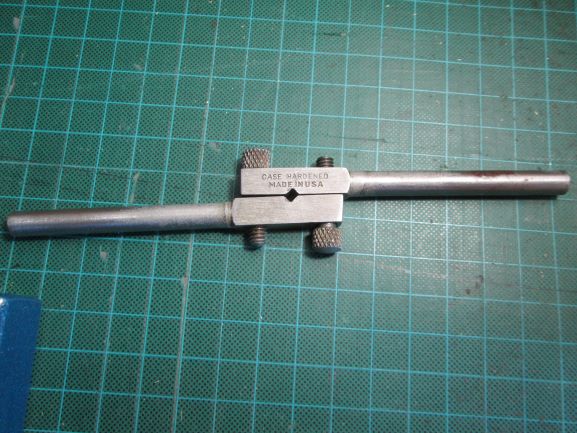

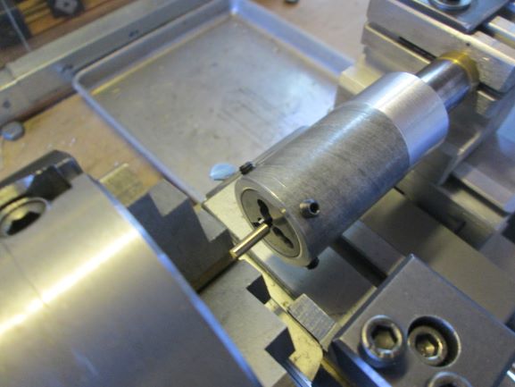

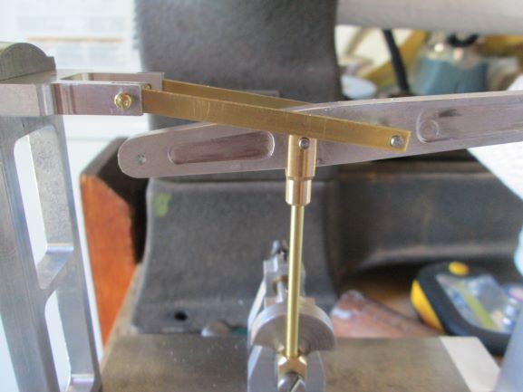

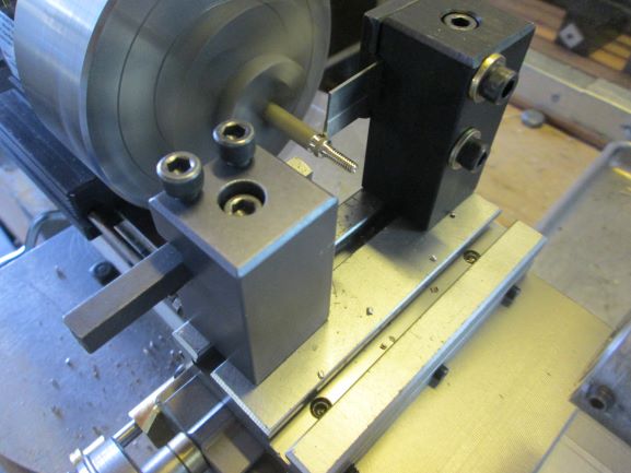

Here's one way to kluge a follow rest:

Looking good! Clever use of the radius tool too. I wonder if that tool will fit my Sherline.  :thinking:
Eric

Thank you Eric. As for the radius turner, I don't know, but if it doesn't fit the Sherline as is I'm sure it could be adapted, we being machinists after all!  I was using it upside down, with the tool holder clamped in the mill vice. Here's a catalog picture. In general, as much as I really like the Taig machines, their accessories aren't as nice as those offered by Sherline in my opinion, of which I have a couple.
Offline EricB
  • Posts: 128
« Reply #36 on: May 15, 2021, 05:21:27 AM »
Sherline's radius tool cost 5 times as much, is much more complex, takes two hands to operate, and puts you dangerously close to the chuck. I can't justify Sherline's cost but I want a radius tool of some type.

« Reply #38 on: May 20, 2021, 08:37:40 PM »
The Grasshopper is almost complete. I want to paint the steel base, but before taking it apart I wanted to make sure it runs OK. I think I'll leave all the other parts “natural”.
Here's a few photos and a short video. I need to make up a throttle valve for the air line, the trigger on my air nozzle is too sensitive, even at only 10psi. I'm holding it just barely cracked.
<a href="https://www.youtube.com/watch?v=B8qBQvoKT6Q" target="_blank">http://www.youtube.com/watch?v=B8qBQvoKT6Q</a>
Offline EricB
  • Posts: 128
« Reply #39 on: May 20, 2021, 08:44:46 PM »
 That's a good looking engine!  :ThumbsUp:
You should throw a size reference in the pictures so we can see how tiny it is.
Eric

  • Posts: 7929
« Reply #40 on: May 20, 2021, 11:09:34 PM »
Congratulations on a runner!  That's always fun to see it working for the first time!  :ThumbsUp: ;D
Now you can go a d paint it knowing that it works!
  • Posts: 1699
« Reply #41 on: May 20, 2021, 11:18:43 PM »
Thanks Eric! Thanks Kim!
I can do that. It's not all that tiny, especially compared to Elmer's "Tiny", the one on a wood base.
