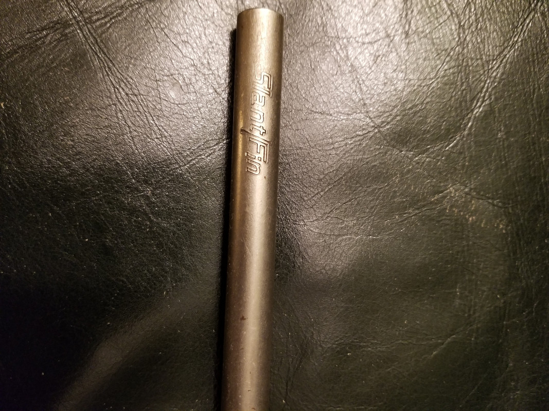

Hi everyone,
We're cleaning my parents home in preparation for its sale. I found this tool in the garage.
It looks like some sort of punch, the knurled end has been pounded on. The sleeve had a 1/2 inch OD and 3/8 ID. The tube is 8 7/16 long and the punch when run all the way down is about .040 longer than the tube.
This is the only identification on it. When I look this up I find base board heating equipment. Anyone Have a clue?

That is a nail guide tool - sort of a hammer-powered power nailer. Look at page 10 here:
https://www.google.com/url?sa=t&rct=j&q=&esrc=s&source=web&cd=&ved=2ahUKEwixkZuM3PzvAhXuGFkFHdSQAiAQFjABegQIAxAD&url=https%3A%2F%2Fwww.slantfin.com%2Fwp-content%2Fuploads%2F2016%2F01%2FBaseboard-Installation-Instructions-103.pdf&usg=AOvVaw3fOryBf7WEGr-VYUTUpaQM
You put a nail in the open end of the tube, put that end inside the opening where the nail will go to hold the baseboard heater in position, and hit the other end with a hammer to drive in the nail.

Thanks that makes sense, dad built the house and installed a boiler with baseboard heating.
