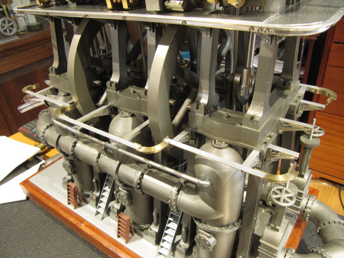

Wow, you'll have all the catwalks done soon!  How much is left to do?
PS Didn't you remove more of the insides on the other brackets?  Are the lower catwalk brackets different?
  • Posts: 18681
« Reply #2041 on: January 18, 2022, 01:17:58 AM »
Hi Kim,
The brackets on all three levels are different. On this lowest level they step back at the bottom so there is less of an opening.
After this, whats left? Railings, dashpots, gauge board, the cutaway insulation walls at the top, and testing the pumps. Pretty close to done!   :cartwheel:

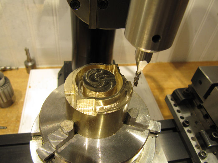

This morning I got the rest of the brackets screwed onto the engine frames, then turned my attention to the angle channel rim around them. On this lower level, there is a center section by the flywheels that sticks out farther than the rest, so there are eight corner pieces rather than the four on the other levels. Also, these corner pieces have half the radius of the others, and I don't think my trick of bending the channel around a pipe will work well with such a tight curve. So, I am reverting back to how I originally thought all of them would have to be made, milling them out of round bar. The corner pieces take a 90 degree arc, then have to straighten out to match the long straight runs, with a notched end to fit behind the straight channel so they can be screwed together.
After some time laying it out, I started milling the first pair into an offcut end of a round bar, using the rotary table on the mill with a couple sizes of end mill. The curves were first done with 90 degree turns on the table, then the straight sections run in, leaving two corner piece shapes:

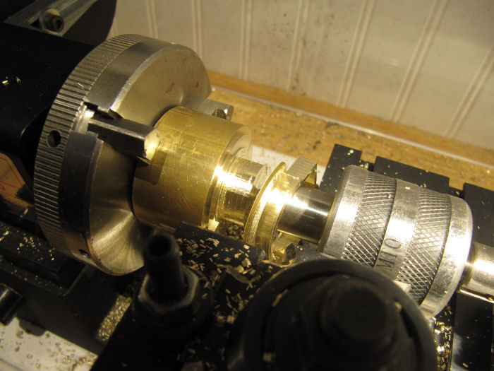

Moved the bar over to the lathe to part off the shape
Leaving this:
The corners were then cut through to seperate them, and the little inside corner left by the mill filed square so the channel will butt up against it. Here is one corner piece with some channel stock set next to it to show how it will go together:
So, two corners down, six more to make...

And today was 'going round corners' day!
All eight are shaped, ready to drill/tap the holes in the end flanges to attach them to the straight sections (which have not been cut to length yet)
  • Posts: 18681
« Reply #2051 on: January 20, 2022, 02:59:10 PM »
And today is 'bolt the corners on' day!
Two more straight sections to make for the ends, then will take them off to paint the brass corners...

« Reply #2054 on: January 20, 2022, 04:32:46 PM »
Chris those corner bits are really nice. Is there a block of metal to make the double 90 connections that are on the outside edges of the flywheels?
