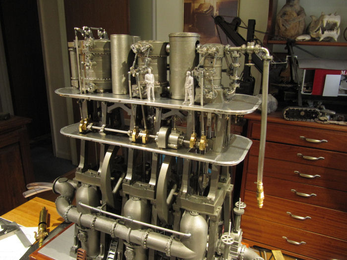

Yesterday and this morning got the curved corner sections and deck plates for the second catwalk made:
Next will be the lower catwalk, which is at the bottom of the engine beds. This one is the most complex, since it steps in and out in the center, and has sections next to the flywheels. The brackets for it have to step back in where they fit around the top of the pump frames too. The techniques will be the same for the brackets, just with more shaping.

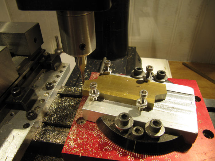

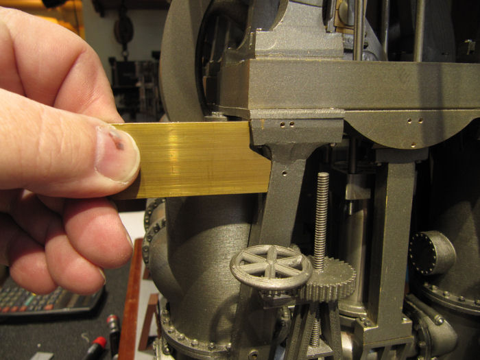

Gotten a start on the lower level catwalk brackets. Since these step down from the engine bed to the angled frames underneath, the large ends need to be stepped in first. Did that with the parts hanging off the end of the jig. This level also has different width floor plates in several places, so more sizes of brackets to make.
Here is a test fit of the first one, all good, so will start shaping the bracket frame next...
As before, am making the in pairs from each bar to save metal.

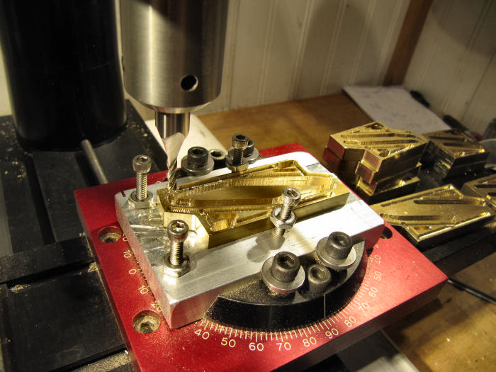

Been plugging away on the lower level catwalk brackets, down to the last couple cuts on each. There are four different shapes to the brackets on this level, and most of them step back from the upper to lower mounting holes.
