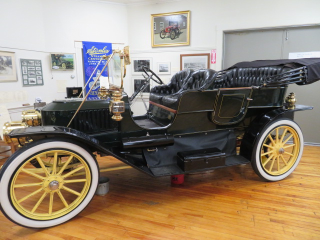

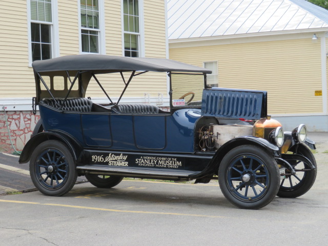

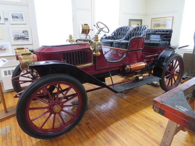

For the short version, here are the three cars we rode in:

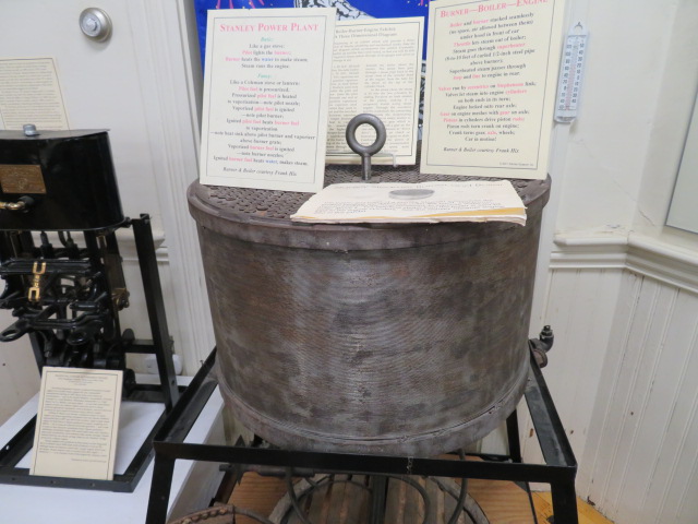

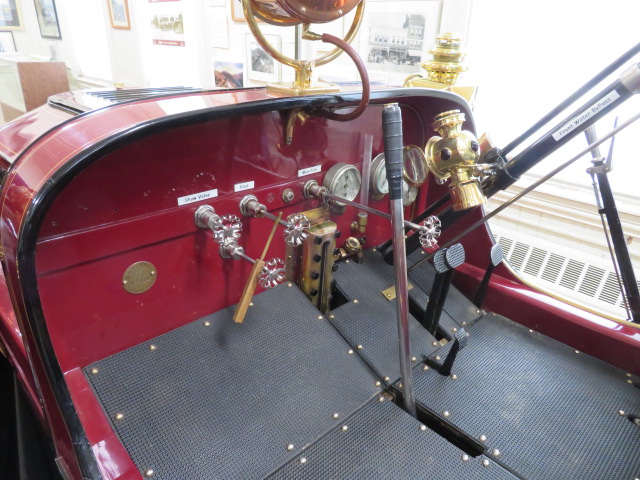

Here is what the engine from one looks like, two cylinder with reverse, directly geared to the rear axle with no changeable gears, capable of speeds in the 40 to 70mph range (we got up about 40 max, mostly we were on side roads). This is like the model engine that I built.

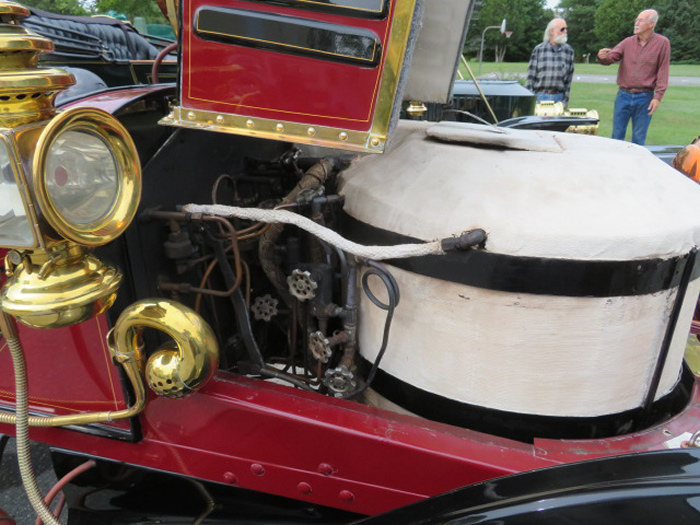

This is the boiler under the hood
and what it looks like inside - outer cylinder is wrapped in 3 layers of piano wire so they could use thinner metal and make it light weight. It runs at up to 600 psi. Many vertical firetubes, low water volume, has a kerosene burner.
All it needs is a driver!
And no, I did not get to drive, it takes a bit of training to operate these, lots of controls! Did get to spend several hours out riding around in them though.

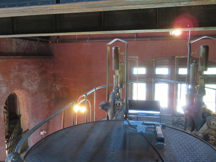

From there we worked our way all the way up all the levels of the engine, till we were standing on the top, 60' up from the base

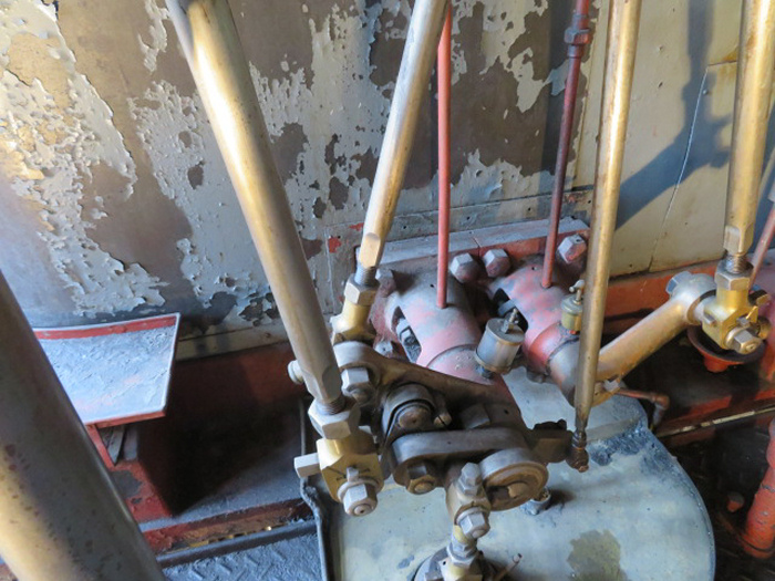

Along the way got a lot of detail pictures of things like the governor and valve assemblies, will be useful on the CAD model since the plans show all the pieces but not much on how they go together!

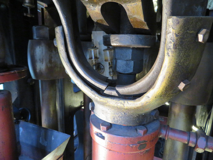

One thing he pointed out was the damage on the valve guides for the poppet valves on the LP cylinder (most are Corliss, the IP exhaust and all LP are poppet)
You can see the broken piece at the bottom center of the curved part - looks like it metal fatigued the cast iron and cracked. Some were worse than this, and had been repaired at some point with a bolted on surrounding piece. These engines ran from late 1800s till 1970.

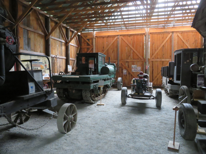

and I just had to stop in and see my favorite machines, the herd of Lombards in the machinery hall:

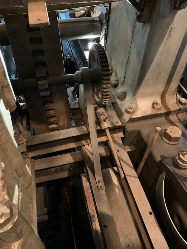

Oh, and while touring around the Leavitt engine at the waterworks museum, we came across that worm gear that was mentioned much earlier in this thread by Sid:
I explained to the director about how worm gears work, and how it would not be possible for the flywheel to get the worm gear to turn to drive something else as Sid's tour guide claimed. He remembered back when the engine was put of for Landmark status, they had an event where the engine was turned over by a small motor for a demonstration - this worm gear is likely the remnant of that event. I could tell that the stand it is on was a home-made addition, and the gear put into the barring holes IS in mesh but there is no provision for swinging it out of the way other than removing the bolts in the stand. The metal bar is quite lightweight, and would never stand up to actual engine speeds regardless. The Leavitt engine ran at 60 RPM, which along with its odd off-center design (so that it would fit the existing building) was most of the reason it broke down so much. Now, this is the Leavitt engine in Boston, same building but different engine than the Allis that I've been showing other pictures of.Also on the Leavitt, it was mentioned about what looks like a ships steering wheel up at the valve eccentrics next to the lay shaft. While there I was able to follow the control linkages and the gearing, and determine that it was put in to be the barring method - it has a bevel gear reduction set that connects to the lay shaft, with a lever with dog clutch to engage it when desired. That wheel would give a large gear reduction to the lay shaft, which itself is directly geared to the crankshaft, to allow them to turn the engine by hand for starting - it would only take a small turn angle on the crankshaft to get it off of a top/bottom dead center condition on the HP cylinder to allow it to self start. There are barring holes on the flywheel, but the only place that you could put a long lever in to use them is obstructed by one of the catwalk support poles!

« Reply #1049 on: September 01, 2021, 01:18:00 AM »
Hey Chris
The barring engine, or wheel in this case, wasn't used to get the engine off dead center....They would use starting valves for that  which were live steam fed manually into the either the IP or LP cylinder when the engine was on HP TDC or BDC..      but a good engineer would never stop it there....but thats something else
The Barring engine or wheel was used to push condensate out of cylinders without starting the engine.  This would allow the condensate to exit the condensate valves slow enough to not hammer the cylinder heads and blow them off.
We would do this to good effect on Sabino when she was started cold, and the 750 HP tug engine when we got it running.
