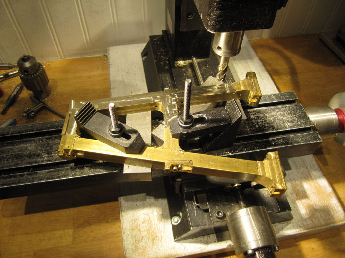

Thanks guys!
This engine didn't look quite so complex when I first saw it, just enormous! This afternoon I got the screw holes all drilled to attach the guide frames, but before I attach them for good I want to lay out and drill/tap the holes in the top horizontal rails that will be used to bolt down the cylinder blocks. Each pair of frames has a different hole pattern since each cylinder is a different size with a different base/valve/piping layout. While going through the LP one, I noticed that the pattern didn't look quite right, and it wasn't! The spacing of the bottom rail on the cylinder was transcribed from the paper blueprints wrong - fixed that right away.

Thanks guys!  I've been plugging away on the frame parts, got the cylinder mount holes all drilled and tapped, working on the last of the corner inserts.

All the corner inserts went in yesterday, now have started the facing passes on the frames to get them to final thickness. This also cleans up the little gaps at the edges where the bar stock had rounded corners.

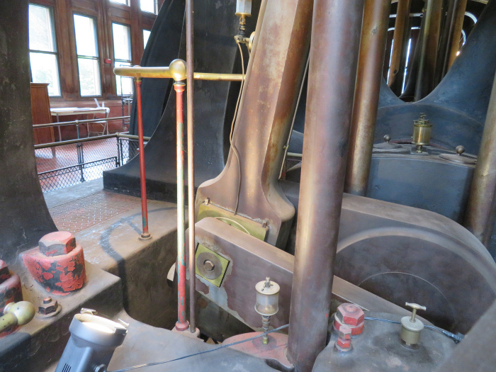

Back on the crankshaft joints on the Allis and Holly engines, I did come across this picture showing the connection on the HP cylinder crank on the Allis engine, you can see the square hole and the gaps at the inner/outer ends quite clearly. Also neat to see the way they put the lubricator resevoir on the side of the con-rod, just visible at the top/center of the picture with the lines running down to the bearings.

How often did they shut down each of the engines?  Filling those oilers under motion would be tricky.
  • Posts: 18723
« Reply #985 on: August 21, 2021, 02:34:16 PM »
Yeah, a good trick to play on the new apprentice!  Since they were pumping to a reservoir or water tower, they could shut down periodically.  I took a bunch of pictures when I was there, but now I realize how much I missed, lot more angles to photograph next visit.
Chris, Nice photo I have to remind myself that the square brass part is 15" square while looking at it. I have been thinking about this and there is a big difference between this type of large engine and large ships engines either steam or diesel that I did not think of.
Large ship engines are built on a bedplate that is a casting or a series of castings bolted together. This gives a very strong and rigid way to attach the main crankshaft bearings. The modern Sulzer engines have a welded bedplate but it is just as strong and rigid.
There are three separate bedplates for the Holly engine and then another three bedplates supported by the lower A-frames that have the main crankshaft bearings. Now, this might be strong but the crankshaft forces have a much longer moment arm or lever to the fixed bedplates.
I think the crankshaft would have to be much stiffer to resist deflection without the drag box which makes the crankshaft two pieces so the bending force is not transmitted through the box joint.

« Reply #989 on: August 21, 2021, 02:57:55 PM »
...."square hole and the gaps at the inner/outer ends quite clearly"..... :insane:......
Could these be square covers over round pin/bush holes?
Loose square pegs in square holes would be non-rotational or flog  :facepalm: sh*t out of the rotating clearance elements in pretty short time
