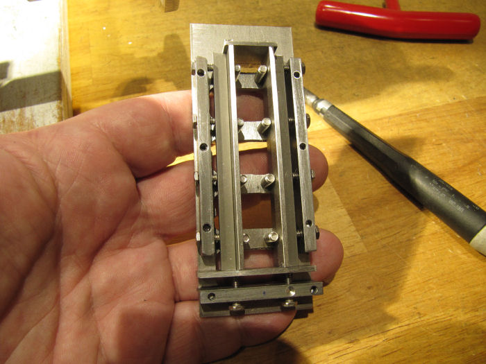

This morning I worked out in the CAD app the dimensions for a silver-soldering jig for the crosshead guide parts. Need to make six of them, so well worth the time to make up a jig. The weather today is SO nice compared to the high heat this past week, so rest of the day is outdoors!

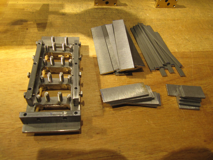

The last two days have been used to get the jig and bar stock ready for the crosshead guides that go in each of the engine frames. Here is the jig for silver soldering plus the rough cut bars for the guides:
The taller posts will hold the 1/2" wide bars on edge at top/bottom/sides, and the shorter posts along the sides will have the narrow bars laying flat on them, held in the middle of the 1/2" bars to form a T shape. The screws along the bottom and sides will hold things together for soldering - will show pictures of that once the bars are trimmed to length. Bunch of time in the jig, but the bars are too thin to use screws to hold them together for soldering, and this setup should give repeatable results. I cut the large holes in the back of the jig to let the torch flame pass through, keeping the jig from getting quite as hot - the bars are thin, so they should get up to temperature quickly.

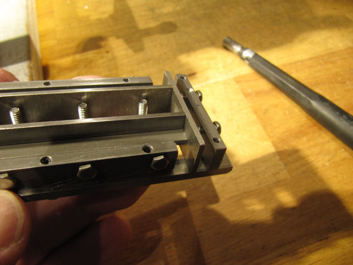

Got the bars prepped for soldering, took them all to length, doing them all ganged up a size at a time. Clamped them in the vise, trimmed the ends square, then grabbed the ends with a small clamp to hold them together to flip them around and trim the other end to length. For the shorter pieces, that means using two clamps - one to get them out of the vise, attach the other clamp to the un-cut end, remove the first clamp, and put them in the vise using the second clamp.
and a few shots showing the first set all held in the soldering fixture - two long/wide bars for the crosshead guides, two long/narrow bars for the T shape next to them, a short bar at the top and a long bar for the bottom.
The narrow bars are held up in place so they land in the center of the wide bars, a view at the top
and from the bottom end
Tomorrow I'll set up the torch outside and get started silver soldering them all together....
