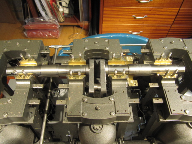

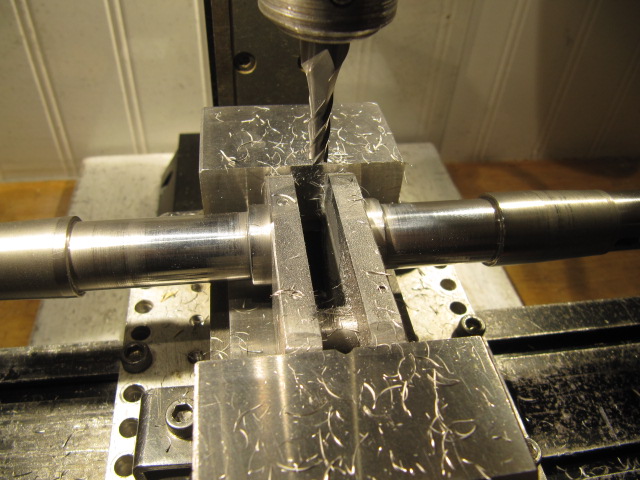

Today got the crankshaft bearings lapped in, started with the coarse grade of Timesavers powder and oil and worked down to the fine grades. Then took the plunge and cut the center section of the main shaft away from the webs - all good fortunately! Still a nervous cut. I sawed away the bulk, then used the mill to trim the cut ends back flush with the webs.
Here it is on the bearings

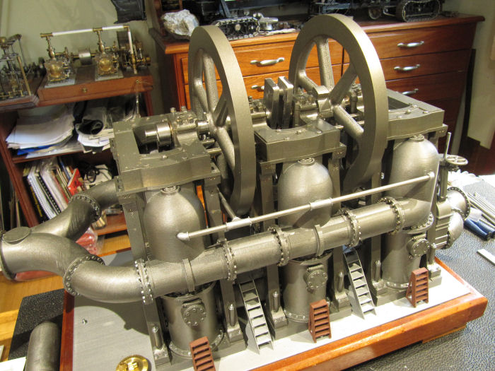

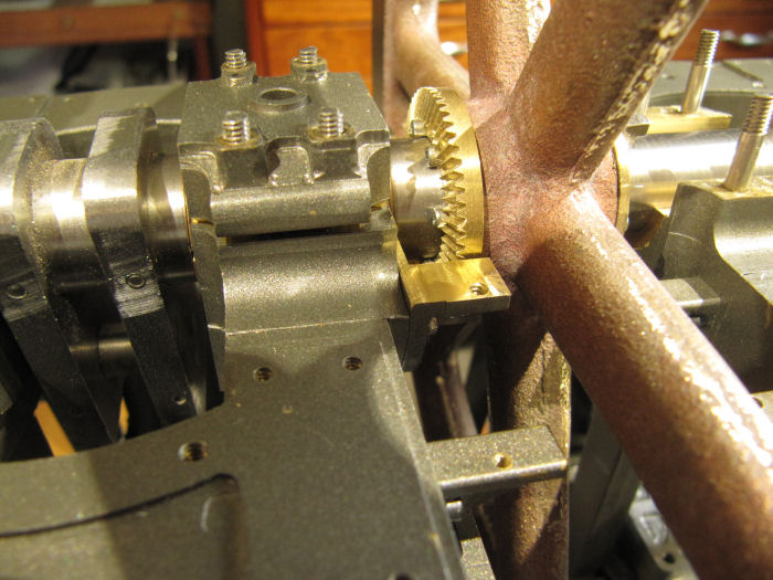

No surprise, I couldn't wait till tomorrow to get the flywheels and crankshaft assembled and on the engine:
A quick video proving that yup, they do go round and round!
