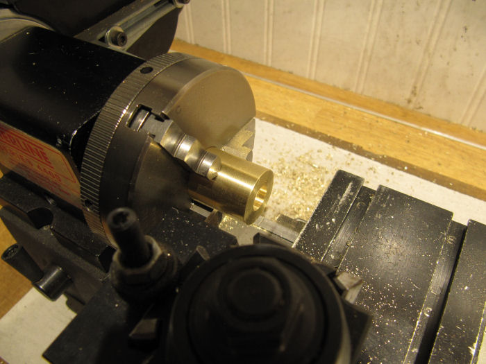

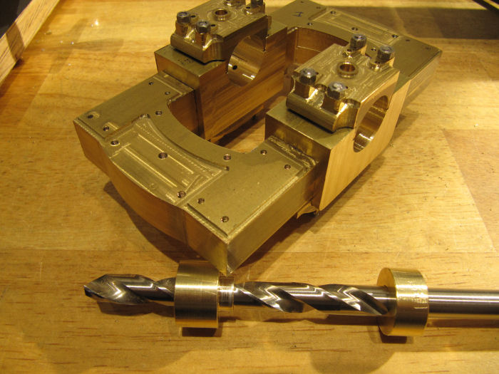

Then, since I didnt need the post in the alignment fixture anymore (other two beds have one hole each since the end cranks are open style) I reused the post for the marking fixture I need next - bored a hole through it to match the long 3/8" drill I have, and parted it into two sections:
so the two sections slip over the drill
and the guides slip into the engine bed holes to hold the drill centered
Now I can re-assemble the engine beds onto the vertical pump colums, the center section plus one end one at a time, and use the drill to mark where the center of the crankshaft lands on the two end ones. Should be able to either turn the drill by hand or use a slow speed hand drill, just need the mark where it lands to guide me in setting up the two other engine beds for boring. That will get the centerline very close, and my straight-edge checks show the angle alignment will be close as well. I am expecting there to be some slight binding points unless I get really lucky, but a little Timesavers compound should fix that. So far, so good!

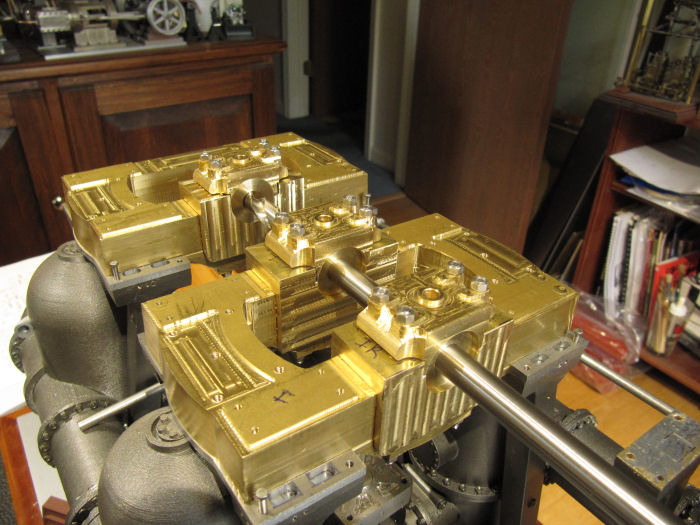

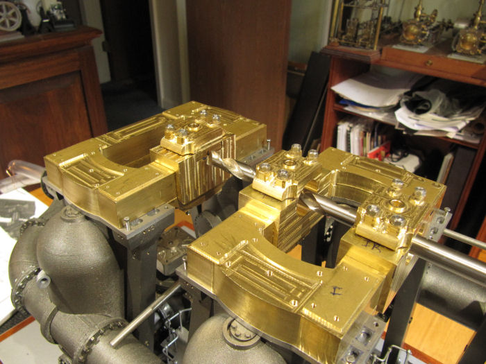

And I got the parts assembled back onto the model to mark the crankshaft centerline. Here is what it looked like marking the HP engine bed end. The long drill is run through the guides in the bearing holes, and was turned by hand to make a mark on the side of the bearing block/cap. On this end, the mark was dead center on the cap/block seam horizontally and vertically.
and marking the LP bearing block. On this one, the mark was dead on vertically, but horizontally it is slightly off. Checking measurements show that somehow I goofed when notching the side rail for the bearing block - the block is off to one side a bit. Must have mis-measured something, or miscounted crank turns. Its still close enough to work though I'm glad I did this marking, to know where the centerline actually wound up. If I had not goofed something on the bearing block it would have been spot on, so I am pleasantly surprised things are stacking up so well given the number of parts involved.

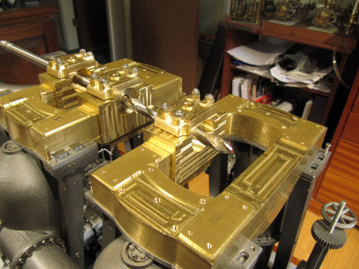

This morning got the LP engine bed bored for the crankshaft bearing. The drill-marking trick has worked, this one was the one where the bearing block ws a little off to the side, so if I had gone from measurements from its edge it would have bound up the bearing. With the long drill slid through the drill guides (had made four slices, one for each block) on the three bored so far, it rotates freely.   :cartwheel:   You can see the drill guides in the bearing holes - the drill is .375", the bearing holes are .828".
That just leaves the HP bearing to drill for...

Thanks Kim! Very pleased with how well it worked. Just finished boring the last bearing block hole,
and things line up for that one as well - at least as much as I can tell with this drill, dont have a length of 3/8" rod the right length handy, and I dont want to cut a longer one down just for this test. The drill is a couple inches too long to fit within the bed rails on either end.
So, with each set of three lining up very well, I'm going to call this a roaring success and move on to shaping the sides of the bearing blocks down to final profile - full width under the cap, then they swoop in and blend with the sides of the rails.Before that though, this afternoon/evening am off to my cousins place at the lake, an old tradition there to hold a lake-wide party called the Ring Of Fire the night before the Fourth of July (Independance Day here in the US). Bonfires all round the lake, fireworks in all directions, parties at all the cottages, huge fun.

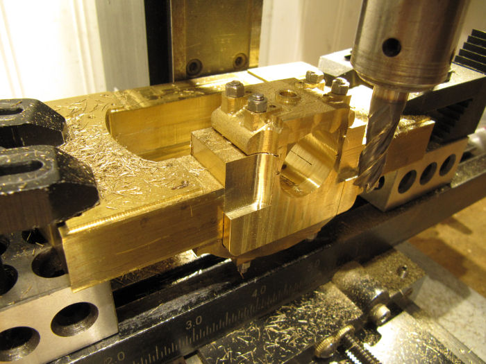

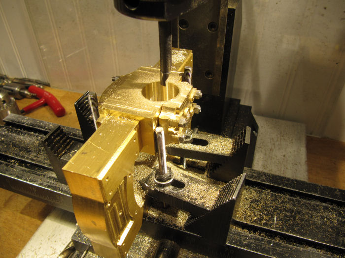

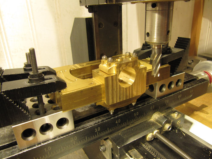

Coming down to the last few steps, well, maybe a dozen steps, on the bearing blocks and engine beds. This morning got started taking the sides of the bearing blocks down to final profile. Here is what they are looking like before this step:
The sides of the bearing blocks are just that - blocks, sticking out from the side rails. With the engine bed squared up to the mill table and clamped down, the sides were taken down at the ends to be flush with the side rails. Started with the top half - tried a longer end mill to do it all at once, but the finish was not smooth so I went back to a standard length cutter.
Did the cuts on the inside and outside rail edges, then flipped the part over to do the bottom halves of all four corners
Will do the same on the other two engine beds, then move on to doing the top ends, to get them shaped to the top of the side rails. One of the bearing block faces, the one on the IP cylinder facing the HP cylinder side, gets a different shape than this, to form the mount for the lay shaft drive gear. That will be done last, as will rounding the bottom edges of the bearing blocks.
