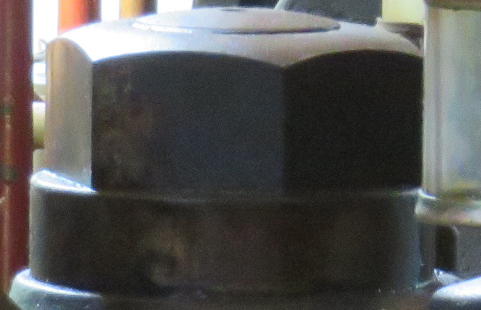

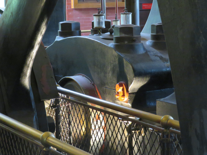

Just one very, very minor observation Chris.  Nuts with each face chamfered are not usually encountered in this class of heavy engineering.  The face against the part being retained is usually flat.  Double chamfers are for general purpose nuts in the hardware store is my understanding.
I went back and looked in the photos I have of the Holly engines, and you may be right on the chamfers - the outside end definitely has the corners relieved, the inside end its harder to tell with the layers of old paint and dirt but they do appear to be flat!  I have close-up photos of the ones on the Allis engine in Boston, and on those I can tell that just the outside is chamfered.

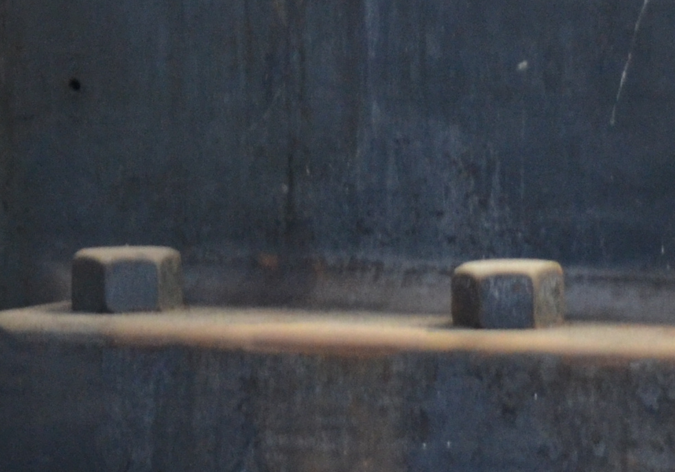

Derek, sounds like you are talking more about how flat the faces are, I think SwarfMaker is talking more about the relief on the corners on the end faces.  Here is a closeup snipped from a photo on the Allis engine that has and extreme chamfer/roundover:
The Holly engine does not go this far on its nuts, it just has the corners of the flats rounded off, here is one on the Holly engine:
On both, its interesting to see that they sized the studs to end at the top of the nuts in most places rather than come through a thread or two - I can see in other photos that they are not bolts, they are studs/nuts. I do not have good pics of the Holly bearing cap tops, from the walkway I could only get within 40 or 50 feet and they are in the shadows. I do have a good shot of the bearing caps on the Allis, where I could get a lot closer, they are very similar in shape to the Holly:

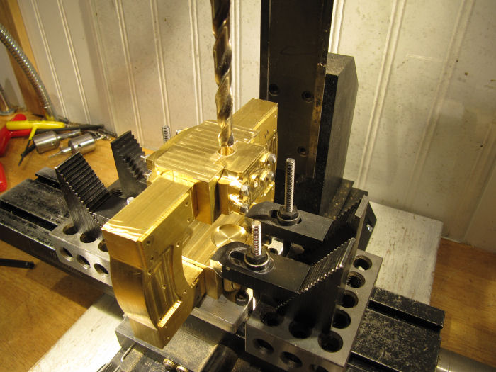

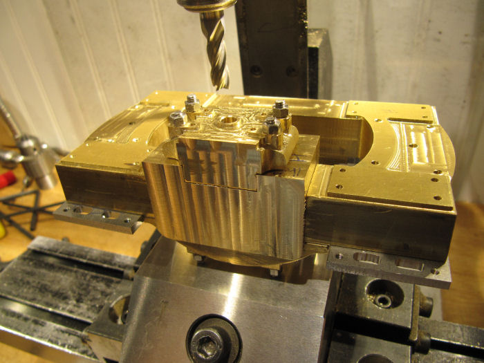

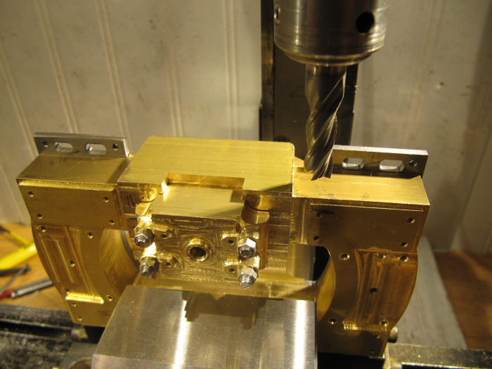

Okay - back on the build, catching up on whats been happening the last couple of days. Before boring the bearing holes, the sides of the bearing blocks needed to be taken down to width, matching the width of the bearing caps, so that there would not be an interupted cut when drilling/boring the bearing holes through them. This picture shows the block before milling off the outside:
and after:
This was done on all four blocks, and likewise milled off the inside faces.

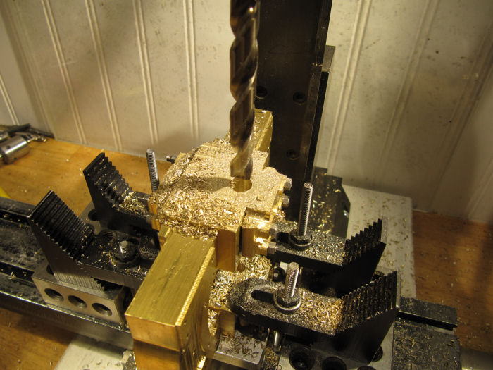

Then on to actually boring the holes. Since the engine beds are over 3" wide, no way I could use the boring head to do it all from one side, and as described in an earlier post the option of line boring would not work out for all the beds. So, I needed a way to align the holes through when drilling from either side. Went through a few methods, and settled on this one. I took a piece of offcut aluminum from the bin, and drilled/counterbored so that it could be bolted to the mill table. This piece has a recess in the underside so that I could bore in from the top, and break through without harming the mill table.

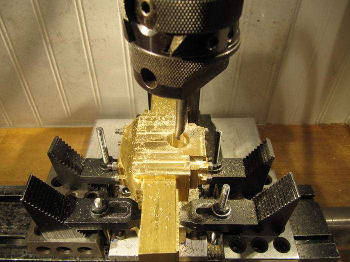

With that block bolted to the mill table, the IP engine bed (center one with bearings on both sides) was clamped down over the block on its side, with the location of the bearing hole roughly centered over the recess on the bottom. The mill table was adjusted till the drill center was lined up with the center of the bearing hole, which is on the center of the seam between the bearing block and the cap. At this point, the mill table X/Y movements were both locked down and left locked for the rest of the steps.
After checking that the bed was square to the table, and the center of the drill was lined up, drilled the starter hole for the bearing. The finished hole will need to be 0.828" diameter.

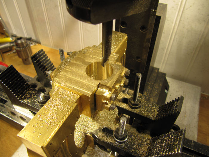

Switched to the boring head, and started enlargine the hole...
A lot of cranking later, and the hole was out to size:

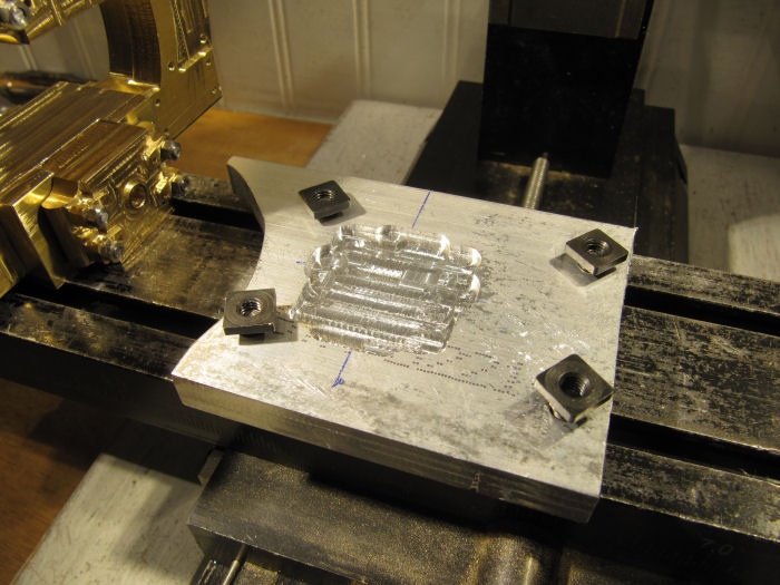

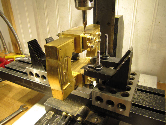

So far so good. Now to put the alignement block to actual use. The bed was unclamped and all the swarf dumped into the shop elves sandbox for them to play in. Then, drilled a starter hole through the alignment block and bored it out a ways - size of that hole is not critical, just needed to be on the same axis as the hole bored in the bed, and since the mill table was locked down that should be the case. The recess in the bottom of the plate let me bore through without harming the mill table. Carefully...

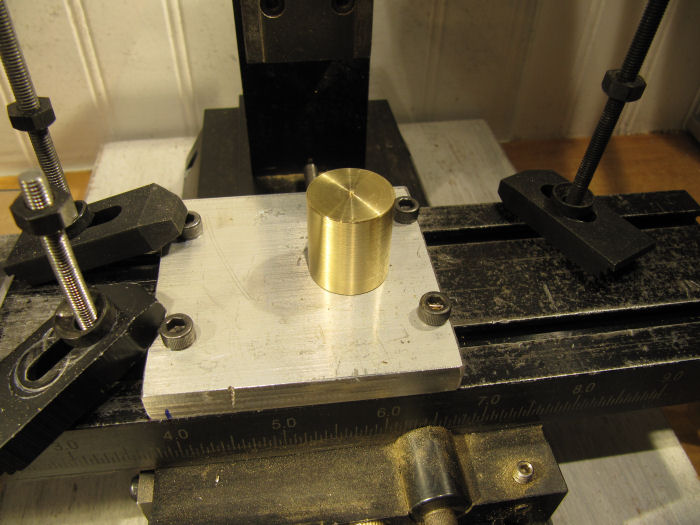

Then popped over to the lathe and turned up this little chunk of roundbar to fit the bore in the engine bed. A short nub was turned on the end to fit the hole in the alignment plate - worked out well, press fit in the plate, and sliding fit in the engine bed hole.
Then the moment of truth - slid the engine bed over the post,

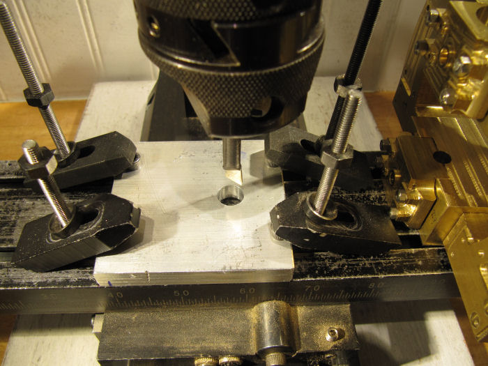

 and clamped it down to the table. Then ran a drill down to the starter hole, and .... it lined right up!!   :whoohoo:
So, all lined up, now I can bore the matching hole in the other side out to size. The shop elves have gotten the boring head reinstalled on the mill for me.
