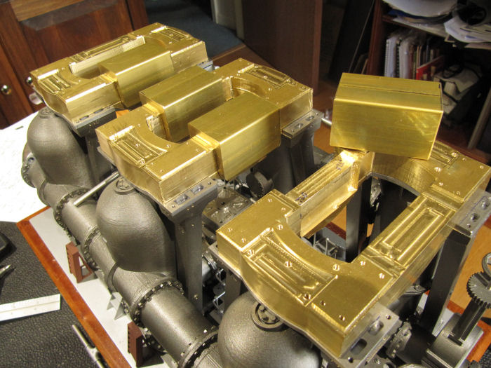

Bearing block number three is fitted, one more to go:
After the last one is fitted, I can start notching them to take the bearing caps:
Still lots more shaping to do on these blocks - notching for the caps, drilling for the mounting bolts, taking them to width, and shaping the bosses on the sides, as well as boring the bearing holes through the whole assembly. The shop elves would go on strike, but its going to be a scorching hot day outside!

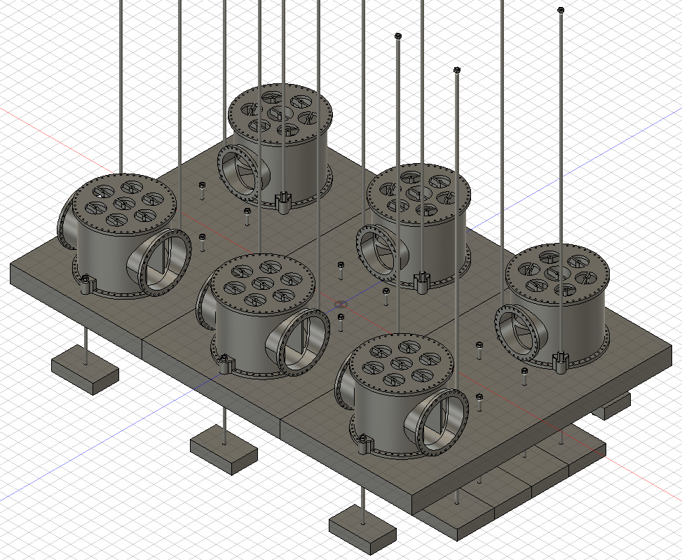

This morning I have been playing in Fusion, doing some more on the Allis engine plans, converting them to a CAD model like I did for the Holly. Long term background project! So far have the foundation blocks/bolts, and the lower pump valve chambers. This eninge has a very different pump arrangement, one intake on the left, one outlet on the right, rather than two inlets/two outlets, and just one set of check valves per side rather than two. About the same volume of water delivered at the end.

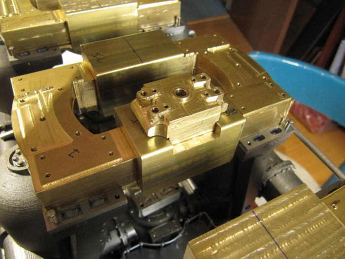

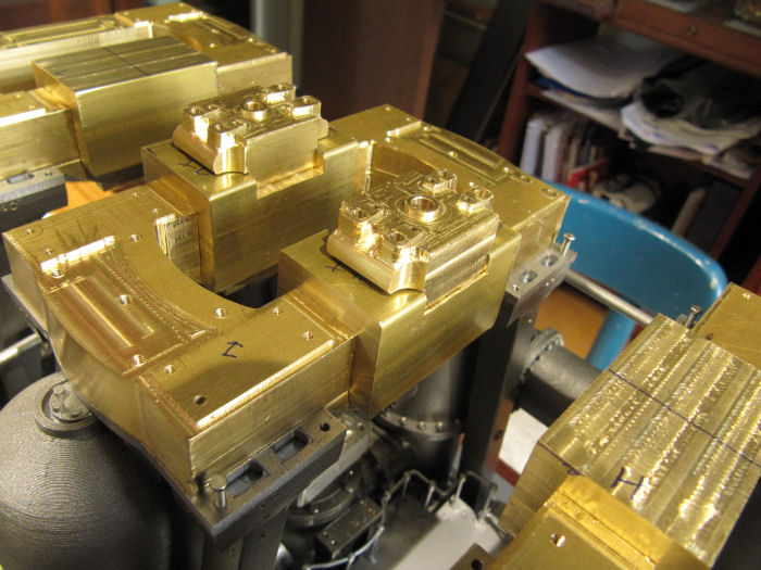

Got the last bearing block slotted to fit over the side rails. Here they all are, with the centerline of the crankshaft measured out and marked in:
Started laying out the notches for the bearing block caps...
The center sits down 1/4" into the bearing block, then later the ends of the block get shaped down into curves leading to the bed rails. First things first though, getting the caps fit to the blocks then drilling the mounting holes, which go all the way through the caps, blocks, and frame rails. That will hold everything secure for the bearing hole drilling/boring steps - those holes are centered on the bottom of the caps, and do go into the side rails a ways too.

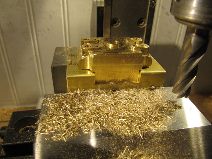

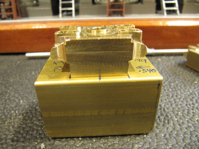

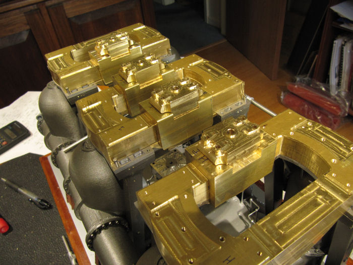

So today started notching in the tops of the bearing blocks for the caps. So satisfying when it snicks into place!
and one down
and a two

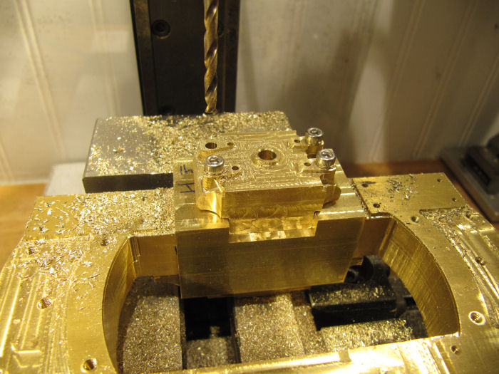

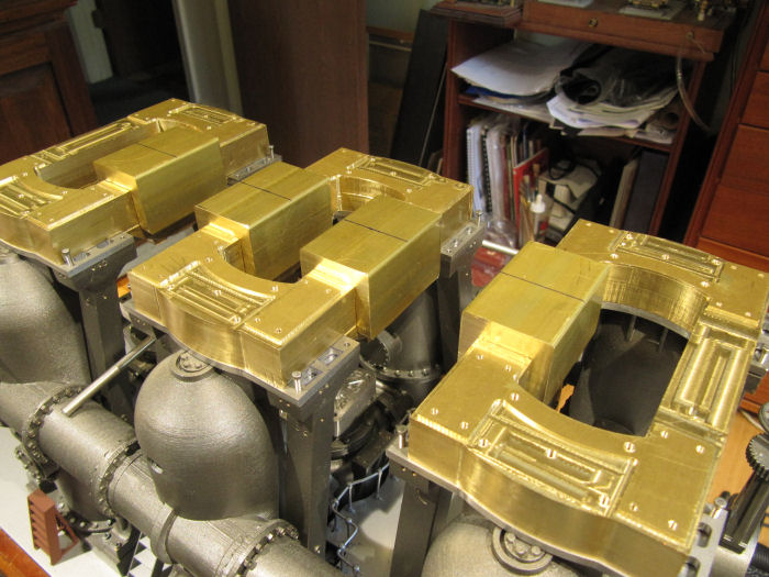

And the last two are fitted in (snick snick)
so started on drilling the bolt holes through the bearing blocks and engine beds, using each cap as a drill guide. Took some careful measurements to get the cap centered on the side rails properly, the sides of the bearing blocks will be trimmed in later. I dropped in some cap screws in the holes as I went to ensure the cap did not move while drilling the rest of the holes.
One cap down, three to go...

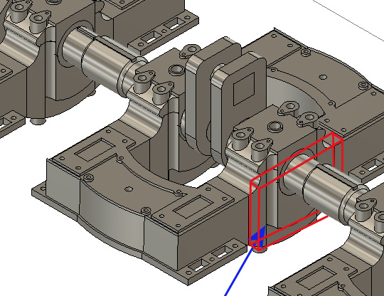

  • Posts: 18681
« Reply #671 on: June 28, 2021, 07:16:32 PM »
Hi Kim,
Those blocks still need a lot of shaping. Right now, they stick out like the red outline in this:
They will be trimmed back flush with the rails at the outside and just stick out in the center like the blue arrow is pointing at. The width of the cap is the final width of that center protrusion, the stock the blocks were cut from is a little wider than the cap still, and a lot wider than the side rails of the bed. The notches I cut in the side rail kept the stock on the sides of the bearing blocks thicker, and prevented any feather edges from forming as I trim them back to final shape.
On the top of the bearing blocks, they will also be trimmed back in a curve under the cap to blend with the top of the bed.
