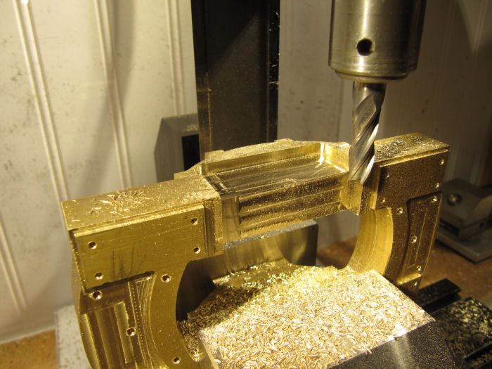

The arch pieces are all loctited and screwed in place, so I can start notching in the side rails on the engine beds for the bearing blocks. Only four of the six side rails get bearing blocks, since the end cranks are single sided. The arch blocks need to be in place for this, since the sides of the rails will be notched as well for the flared portions of the bearing blocks, and the holes for the bearing caps go all the way through the bottom of the arches. Started with the top notches:
The shapes on these parts emphasize the need for all the blocks to be stress relieved first - otherwise these blocks would have warped out of shape as the sides were cut!

Finished cutting in the top recesses for the bearing blocks, and have cut the first side recess - the bearing blocks will have a u-shaped cutout in the bottom to fit over the engine bed side rails.
One outside recess cut, three to go, then can start in on the recesses on the inside faces of the side rails. Those will have to be cut from the top, and the curves left by the end mill undercut. It turns out when I laid them out on the bar stock that I did not have enough of the 1" bar for the bearing blocks, so I have ordered that, hope it is in sometime during next week. I checked around, and as usual the prices are all over the map, this time Midwest Steel Supply had the best (by far) price on the sizes I wanted. Amazing how much the prices vary, and how they change week to week.

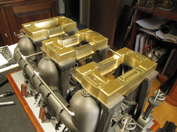

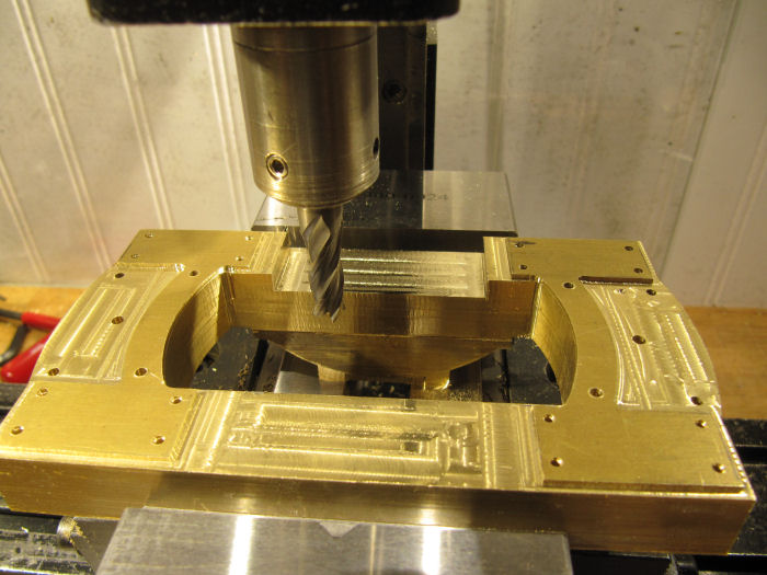

Dug through the tool drawer, and found a middling diameter but longer-fluted end mill, perfect to do the recesses on the inner sides of the engine bed plate rails - needed a nearly 1" reach down the sides, and small enough diameter to get the flat started in the inner corners. Still will need to cut back the radius in the corners with a rotary tool to let the bearing blocks fit in snugly.
Here are the parts so far - the inner four side rails have the bearing block recesses milled in, the outer two stay as is.
Next steps are to cut back those inner corners, and tap the mounting holes while I wait for the bar stock for the bearing blocks. I could also get started on the bearing block caps, the bar stock probably wont be here till later in the week. I've also gotten a little start on the CAD work for the Allis engine from the plans I got from the Boston Waterworks Museum - so far just the foundation blocks and bolts, but its a start on a long-term background project.

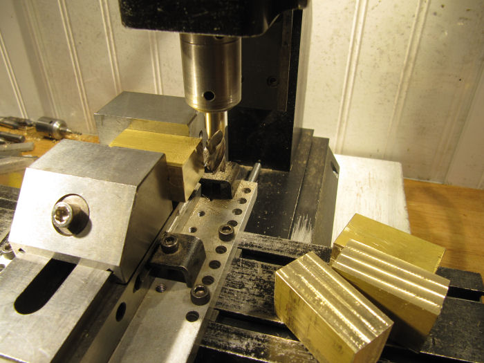

While waiting for the bar stock for the bearing blocks themselves, I've started shaping the stock for the bearing caps, first getting the overall dimensions blocked in.
Also got the last of the mounting holes in the engine bed plates tapped. And, after the sonversation with RReid yesterday about planning ahead, I remembered in time about the mounting points for the lay shaft gear housing, which sits on the side of the bearing block on the HP side of the IP bed. Same overall dimensions, but the shape of the recesses on the side of that block is different to allow mounting the gear housing - there is a big bevel gear on the crankshaft there which drives an angled shaft up to the lay shaft above, with a matching pair of bevel gears to run the lay shaft, with the eccentrics and governor on it, at the same speed as the crankshaft. Caught that just in time - so much for meticulous planning!!    :slap:
